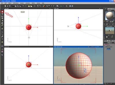

Create the objects.
To begin, create a sphere. Position the Camera so that you can se the sphere well.

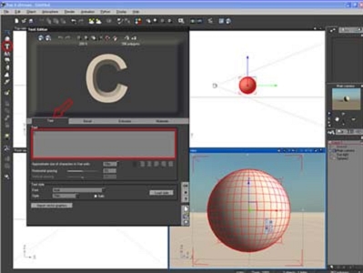

Create a letter. To do this, click on the text editor button on the left hand side of the screen. Click on the text tab and then enter the text you want todo Cut out from you object in the textfield. In this example i have enter the letter c. You can change any of the other parameters on this screen if you would like todo customise your letter diferently.

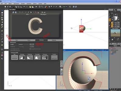

Click on the extrusión button in the text editor. Make sure the extrusión chek box is checked. Move the extrusión slider todo about a third of the bien along. Click ok todo exit the text editor.
Note: you can return todo this screen whenever you like by double-clicking your text object in the any of the preview Windows.

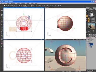

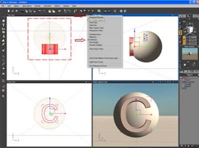

Still inside this dialogue box, adjust the x axis until your c object Will fit comfortably inside your sphere.
Try entering diferent values and watch todo preview screens todo find the right value. Position the letter so that it enters the Spheres center. Note: this Will be easier todo do by changing the preview option for your top view preview window the wireframe type.
The picture below shows the result we are trying todo achieve.

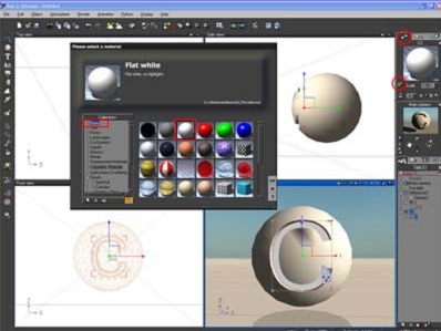

Apply materiales and light.
Click the aspect tab in the object properties dialogue box and select load a material and select flat white from the basic collection. Click ok todo close the material library window.

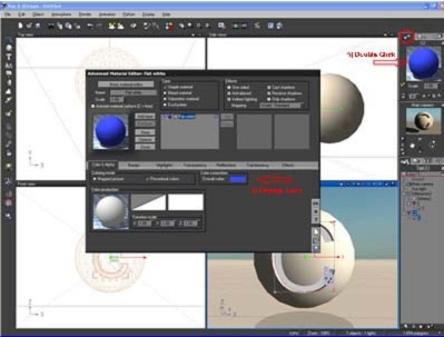

) in the aspect tab of object properties, double click the object preview (ie: the white sphere), todo bring up the material editor.
2) inside the material editor, change the overall color todo the color of the light you want. In this screenshot i have selected a neón blue color.
