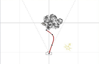

Open it by right-clicking the animation icon. Click next and select airplane todo test if the cameras follow the Cube properly when it banks. Click next todo get todo the next page. Youll se that - Y axis is chosen for the main axis. That would mean the Cube (and a los the Camera) looks into your direction. You want it todo look in the opposite direction, and that why youll select + y axis for your main axis. Click next and youll se the Cube moving in a preview. We dont want todo change anything here for this test, and so you click next again. This is the most important part because now youll create the animation Path of the Cube. To let the airplane bank, you have todo create a curvy Path similar todo the screenshot below.

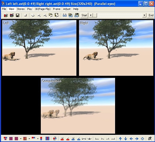

Now we have todo create a Stereo animation from the left, aviand the right, avifile. I used the freeware stereomovie Maker. Go todo file / open left/right movies, todo open both your animations. Youll se both animations and beneath them a composition that shows you the diference of the views.

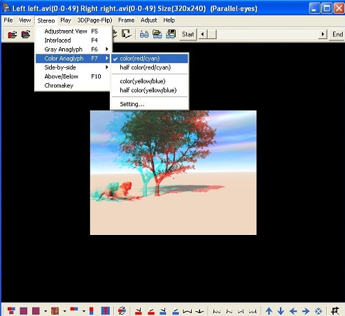

Now you have todo decide what type of Stereo output you want todo create. Go todo stereoin the menú todo select the type you want. I choose color anaglyph/color (red/cyan).
