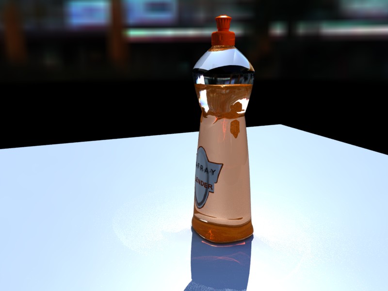

    Nuevo Bf-blender con fluids update. (29-8-05).
    Log: Solver changes:
    -Redid Gravity init.
    Added memory saving Strategy (mem-usage reduced todo ca. 50%).
    Some more cleanup.
    Removed dynamic casts for MSVC compiler.
    Blender side:
    -Fixed no-obj, bug.
    Modified resolution límites for GUI and export.
    Minor fixes for MSVC: removed unused Header and last dynamic_casts.
    Windows . Linux (AMD 64).
Nombre: FSCompilacionOld.jpg
Visitas: 43
Tamaño: 59.3 KB
