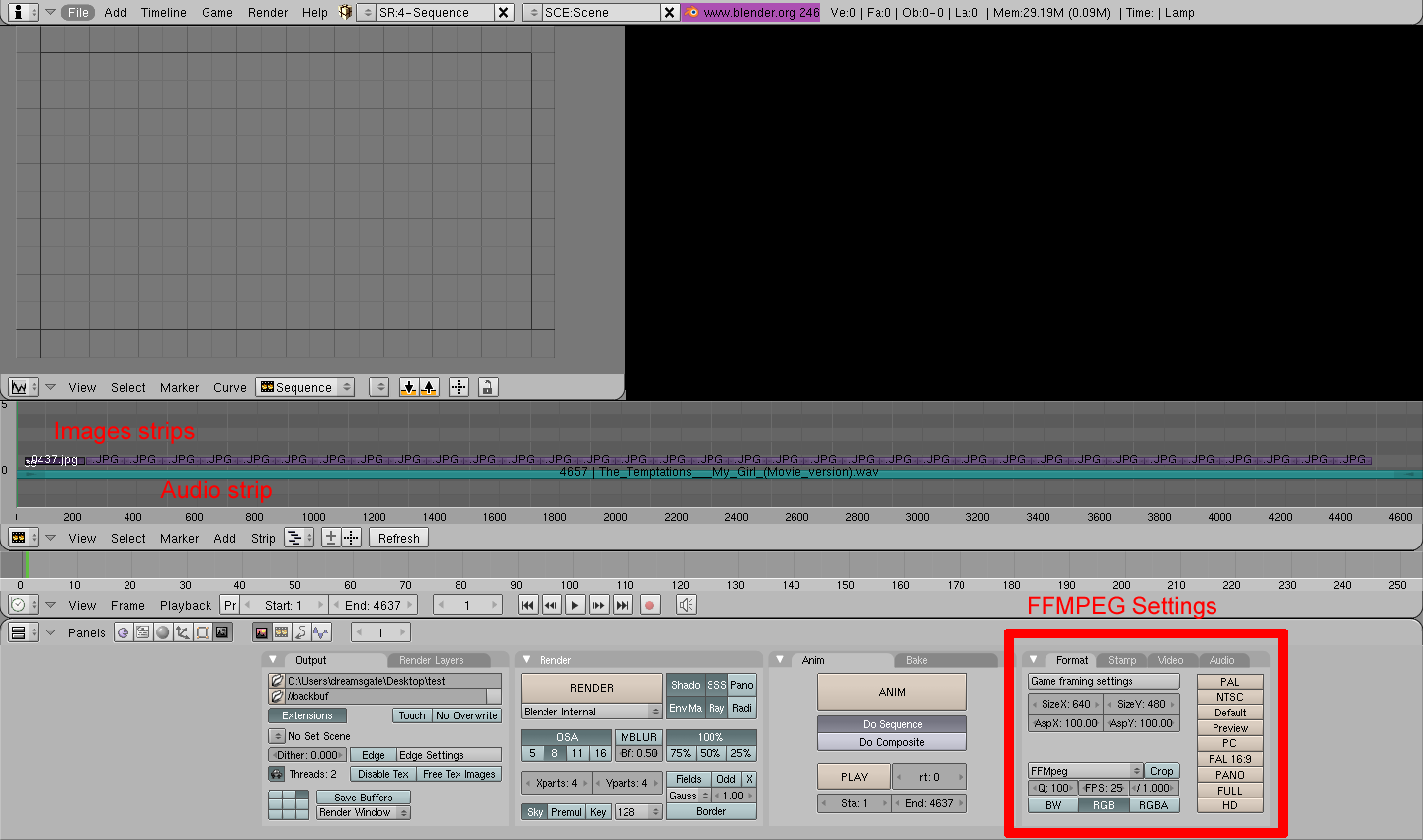

    1. go bak todo the add menú and this time select audio (Hd), browse todo your song and select it. Wav format is best.
    2. drag it todo an Empty channel and line it up with your images.
    3. in the render format panel, choose FFMpeg. (fig2)
    4. an additional audio panel Will appear, (fig3) make sure you select the Multiplex audio button, or your sound wont be included into your slide show.
