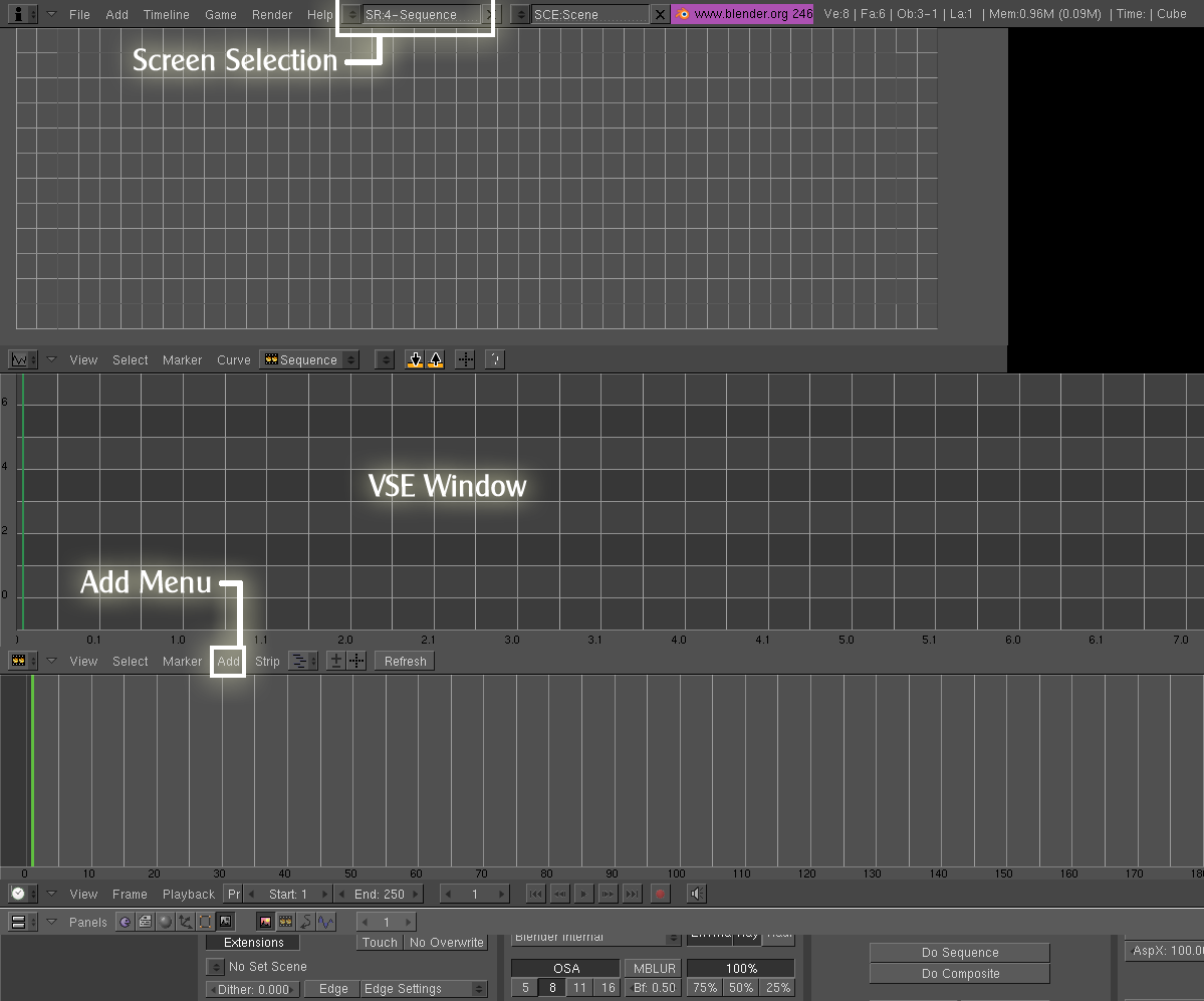

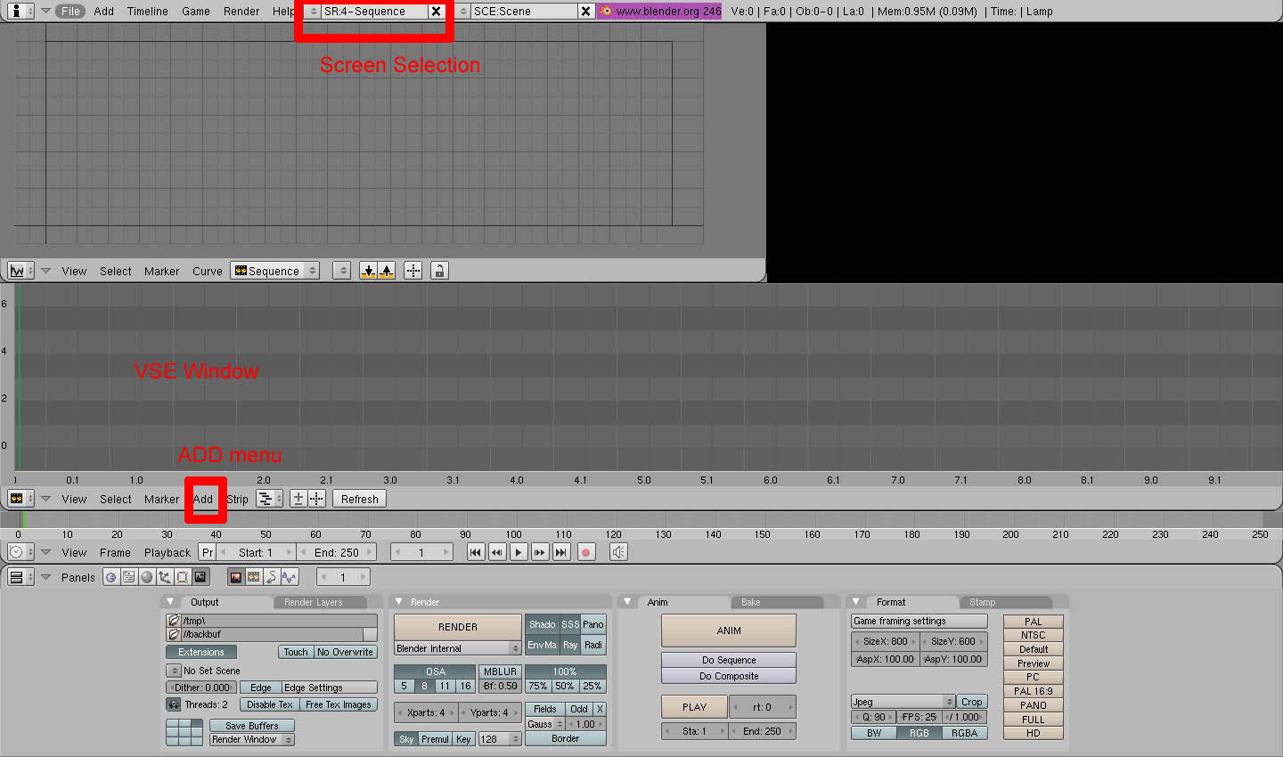

    2. change your screen Layout todo the sequence configuration (fig1). Now todo add your images.

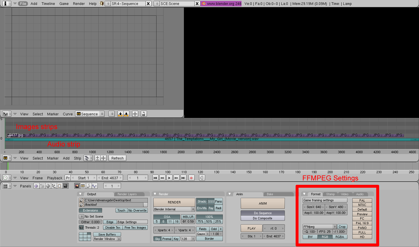

    3. in the render format panel, choose FFMpeg. (fig2)
    4. an additional audio panel Will appear, (fig3) make sure you select the Multiplex audio button, or your sound wont be included into your slide show.

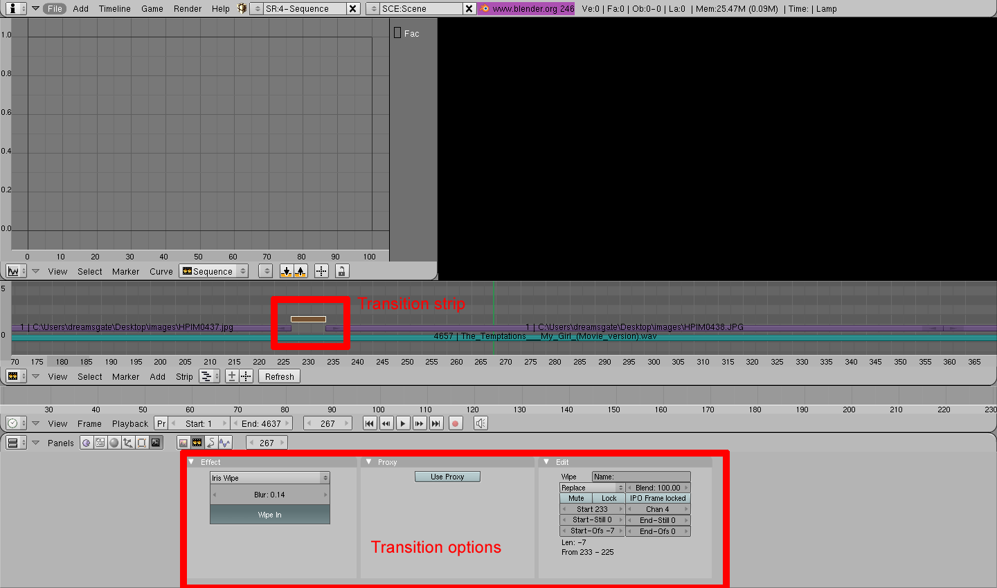

    To use an effect that makes a transición between two strips such as the wipe effect, you must box select or shift-right-clik two of them. When you add the effect strip, it Will be placed in a channel above the two images in Grab mode (clik todo drop it on a channel). Its duration Will be the overlap between the two strips as a máximum.
    You can choose which wipe effect you want, as well as set the options for it in the Sequencer buttons panel. (fig 3)
