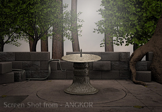

    Once you move past single images and portraits is when the real planning begins. To a certain degre, mortal kombats, interiors and/or any other image that contains lógical lighting sources are somewhat easier todo plan lighting for. Refining it on the other hand takes practice and experience, or someone todo write up a nice Little guide explaining how todo go about it. Which is just what i found recently while browsing th rouge the BSOD section of the blenderwiki. I dont know how i missed it before, maybe i just wasnt yet ready for such relevant información. But there it was, a lighting guide filled with just the información neded todo push my Understanding past the critical Mass point.
    Guillermo s. Romero (gsrb3d), author of the BSOD: introduction todo lighting, in addition todo explaining lighting in general and lighting options in Blender, included a series of exercises todo explore diferent lighting conditions. Breaquíng away from the thre point Studio setup, using the same scene for each exercise he explains the following lighting conditions:
    One thing i really liked about the exercises, in addition todo the fact that he broke down and described what each lighting condition required, is that he actually explained the use of each Lamp and what it added todo the image. There is Even a blend file todo study for each exercise.
    One last tip, actually a quote from Guillermo:
    Finally, no matter if it should be right based in the values we use, we have todo get it todo look right, Even if that means forcing things, doing nasty cheats todo cover issues and taquíng advantage of our errors if they look fine anyway, or maybe rethinking the original plan a bit. It is not what should be correct, but what looks correct.
