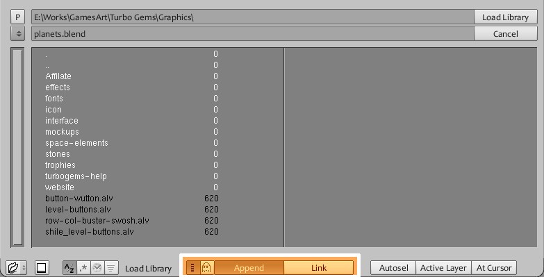

    reusing materiales/textures .
    At some point in your Blender exploration, it Will happen. The perfecto material/texture for your current másterpiece is one that you have already created in a previous Project or one that has ben created by a génerous community member that has ofered todo share his/her materiales with the community. So how do you go about getting that perfecto material/texture into your current projectí well it couldnt be easier.
    Blender has two options for reusing materiales, linking and appending (actually both these options can be used for all of Blender assets. Blender assets can include actions, armatures, cameras, images, Ipos, lamps, materiales, meshes, objects, scenes, text, textures, and world, etc).
    Appending Will place a independent copy of the material into your new Project.
    Linking todo a material Will enlace todo the original file that contains the material, meaning that any changes todo the original file Will a los be saved todo the new file that you linked it todo. This is a useful option when working on a large Project that Will generate a large number of files that may be worked on by one or more people. This Will allow any changes made during production todo be propagated throughout all neded files without the added work of updating each file individually.
    Ok, on todo actually seing how todo use these options. Both options are started the same way:
    • 1. From your new/current Project file, either by going todo file> append or enlace or using the hotkeys shift + f1, open the file browser window. (all blend files can be used for appending or linking.)
    • 2. Browse todo where you have saved the blend file that contains your perfecto material.
    • 3. Click on the file name of the desired blend file which Will open the library list of appendable/linkable assets.
    • 4. In this case we are looking for materiales, so left mouse click on material.
    • 5. That Will open a list of all available materiales in that blend file.
    • 6. At the bottom of the file browser there are two buttons, one for append and one for enlace. Push whichever option you have chosen for your Project.
    • 7. Right mouse click on the material you want todo enlace or append, todo highlight it and then middle mouse click todo confirm (load) your material todo your new Project file.
    • 8. Now your material Will be available todo assing todo Whatever object/model you wanted it for.
    There, just as i promised, easy as can be. With practice, you wont Even have todo think about it, you Will just click your bien todo reusing your Blender assets.

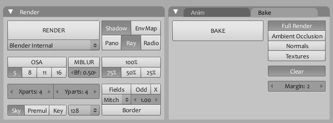

    render baking .
    Render baking creates 2d bitmap images of a Mesh object rendered surface. These images can be re-mapped onto the object using the object UV coordinates. Baquíng is done for each individual Mesh, and can only be done if that Mesh has ben Unwrapped. While it takes time todo set up and Perform, it sabes render time. If you are rendering a long animation, the time spent baking can be much less than time spent rendering out each frame of a long animation.
    Use render bake in intensive light/shadow solutions, such as AO or software shadows from área lights. If you bake AO for the main objects, you Will not have todo enable it for the full render, saving render time.
    Use full render or textures todo create an image texture, baked procedural textures can be used as a starting point for further texture painting. Use normals todo make a Low-resolution Mesh look like a high-resolution Mesh. To do that, Unwrap a high-resolution, finely sculpted Mesh and bake its normals. Save that Normal Map, and map todo the UV of a similarly Unwrapped Low-resolution Mesh. The Low-resolution Mesh Will look just like the high-resolution, but Will have much fewer Faces/Polygons.
    advantages:
    • can significantly reduce render times.
    • texture painting made easier.
    • reduced polygon count.
    • repeated renders are made faster, multiplying the time savings.
    disadvantages:
    • object must be uv-unwrapped.
    • if shadows are baked, lights and object cannot move with respect todo each other.
    • large textures (eg 4096x4096) can be memory intensive, and be just as Slow as the rendered solution.
    • human (labor) time must be spent Unwrapping and baking and saving files and applying the textures todo a channel.
    options
    full render bakes all materiales, textures, and lighting except specularity and s.
    Ambient Occlusion bakes Ambient Occlusion as specified in the world panels (f8. Ignores all lights in the scene.
    normals bakes Camera-space normals todo an RGB image.
    textures bakes colors of materiales and textures only, without Shading.
    clear if selected, clears the image todo selected background color (default is black) before baking render.
    Margin baked result is extended this Many píxeles beyond the border of each UV Island, todo soften seams in the texture.
    process
    Windows users do AO first: if you are running Blender on a Windows operating system, you may have todo first bake Ambient Occlusion before baking any other option. If you do not bake AO first, you may get the error message no image todo bake todo and Will not be able todo bake anything for that Mesh.
    • 1. In a 3d view window, select a Mesh and enter uv/face select mode.
    • 2. Unwrap the Mesh object.
    • 3. In a UV/Image Editor window, either create a new image or open an existing image. If your 3d view is in textured display mode, you should now se the image mapped todo your Mesh. Ensure that all Faces are selected.
    • 4.with your mouse cursor in 3d view, press Control Alt b todo pop up the menú of available baking choices. Alternativaly, Access the bake panel in the buttons window, scene (f10) context, render sub-context.
    • 5. Bake your desired type of image: full render, Ambient Occlusion, normals, or Shadeless textures.
    • 6. After computation, Blender reproduzcas the image with the baked image.
    • 7. Save the image in the UV/Image Editor window vía image->save.
