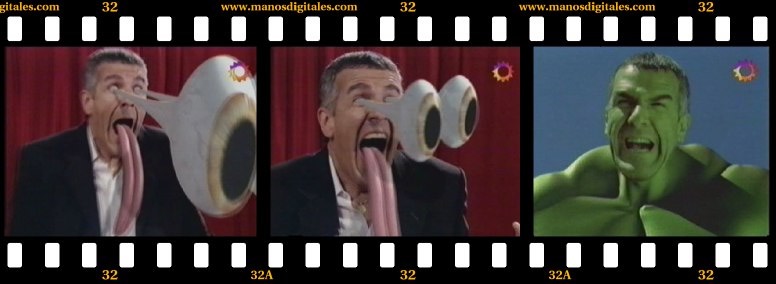

    Figure: visual FX made by manos digitales animation Studio for Pol-ka producciones (all Blender 2.36).

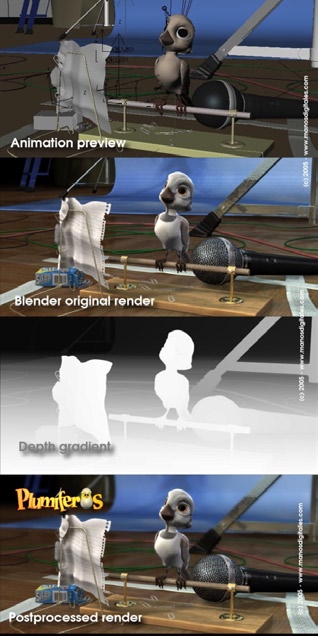

    For tres we used both l-system script available at Blender.org, and arbaro (http://arbaro.sourceforge.net) the excellent java app. We made several renders of a tree with diferent light orientation and then used these renders as textures for planes in order todo kep poly count Low. Other common effects like Depth of Field and atmospherically haze were cheated by using b/w masks of objects and composing in the mensaje production stage, a trik well known by average blenderheads. About this, we used the gradient method (you can read about this technique at: http:// www.elysiun.com/forum/viewtopic, php? T=30959) for creating the b/w masks instead of typical z-buffer plugins, this was done this bien for several reasons, we had several objects with alpha textures so if wed have used any z-buffer plug-in, those objects would have ben rendered as invisible objects.

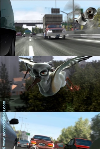

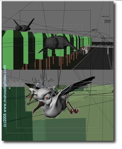

    For the highway scene, we worked first on a proxy versión, using very simple objects representing the diferent characters and Cars. We focused our work at this stage in animating objects and cameras th rouge paths. The complete sequence was Split into several shots from storyboard, and using these proxy scenes, we made a 3d animatic, which we rendered in OpenGL.
    Once object and Camera animation were done and corrected, proxy puppets were replaced by final characters. This process made dealing with large scenes a lot less painful. Actually, main characters were added on a sepárate scene while all heavy-loaded backgrounds remained as a sepárate set. By doing it like this we could focus on flight choreography and gesture without having todo care about real-time transformation of heavy background geometry. Besides, at the same time we were animating, the characters were being modelled and textured separately.
