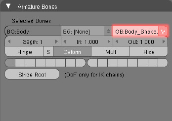

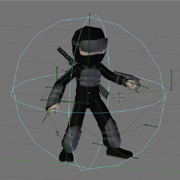

    I wont get todo Dep into rigging since there are god tutorialesout there already, but i did some experimenting with my rigs. I did my best todo re-create the setup used in Poser where there is a circle (called body) surrounding the entire rig. The body is created as a sepárate armature (with only one bone) set as the parent of the main armature. This allows the characters location todo be keyed independently. (se figure a1) for example, you can create a jumping and landing animation in the action editor while keping the hip near its default location, blend the actions together in the NLA editor and then key the bodys Jump and landing positions. Its a sloppy method sometimes, but it provided more flexibility for what i was trying todo accomplish.
    to give the body armature a shape that is easier todo recog- Nize: .
    1. create a new Mesh object of your chosing and edit into desired shape. I started with add>>Mesh>>circle.
    2. select the body armature and enter pose mode [Control + tab]
    3. go todo edit buttons [f9] and in the armature Bones tab type the name of the object todo be used as a custom bone shape. (se figure a2) make sure todo a los enable the w so the object is always visible as wireframe.
