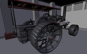

    It was fortunate, that i tok a side photograph of the engine, making the modelling easier. Here is an earlier versión of the blend file, during the initial modelling phase: se the pic on right. There is a plane in the middle, with the picture i tok placed on it with UV mapping, so that it shows up in the 3d viewport. This plane is scaled todo the correct height and width for the engine. A very important step before starting modelling is determining the scale. Blender uses its internal units, not any real world units, so todo make a realistic scene, you must decide what 1 Blender unit (bu) means. In this case i went with 1bu=10cm, the whole engine is 4 meters long and 2.4 high.
    Modelling is mostly starting with a plane or Cube, and then going from there, with extrude, subdivide, and the loop modelling tools. All of this with the help of the UV mapped plane in the middle. As most of the engine is Mechanical models, y barely used any Subsurf, so all of the detail is modelled by hand. A useful Little script that i often used is the bevel centre. This allows me todo add Little bevels todo all the objects, as there is no such thing as a totally Sharp Edge in real life. Bevels catch the light, and give it more realism, and a los add todo the wear and tear. But be careful. Only add bevels when the model is finished. There is no bien todo undo them, and you cant really change or add todo the model once the Edges have ben bevelled.

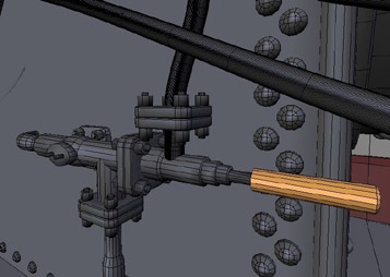

    Details. Very important todo add that final touch of realism todo any scene: adding the small details, these are what make it real. Here is a close-up of one part of the model, with the wires visible. Note the Nuts and bolts, the connections are all modelled. Some modelling, like the parts at the bak of the engine cant be sen in the FinalRender any ways.

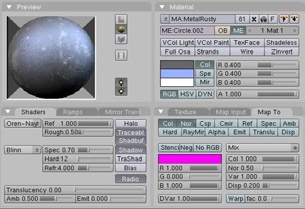

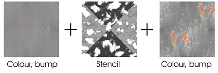

    During modelling, y already start adding materiales and texturing. Most of the metal parts use one material, a rusty metal. This was made with a Little technique that i use todo hide repeating textures. The bien it works is: there are two metal textures, both made seamless, one is a simple metal, the other one is a rusty metal, similar in colour. These two textures came from the close-up photos i tok. They are separated by another texture channel, a clouds texture, with colour-band turned on. The colour-band is half white and opaque, the other half is white and transparent. This is then put between the other two textures, and the stencil button is turned on in the material settings, map todo panel. This makes some parts of the rusty texture todo show though, and some not.
    Randomly. The resulting material. (image left) then the Map Input settings of the thre textures is adjusted until the place where the rust shows up on the model is satisfactory. A similar technique was used for the Walls in the background, as well as the flor.

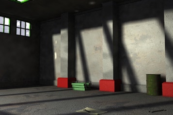

    From the beginning, y envisióned the large machine left todo itself in a warehouse of some sort, with just a Little light shining in. The following is a preliminary render of the rom. I added just a few objects todo the scene, todo give a sense of scale and realism, but not todo much todo draw the attention away from the large Steam mobile in the middle. The rom itself is simple, with a few columns at the bak wall, and some Windows: on the left wall, the ceiling, and the wall behind the Camera. These are the ones casting the shadows. As a small detail, the Windows are broken.
    The lights: there are thre lights on the outside of the rom, behind the Camera, shining th rouge Windows, casting shadow mapped shadows. Plus Yafrays global illumination was used, this added the realistic spills of light, for example around the Windows at the top left, though increasing the render time several times. The Camera was placed Low, pointing upwards a bit todo convey a sense of a large machine. The strong contrast between light and dark a los added a definitive mod todo the scene.

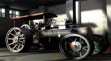

    FinalRender, postproducción
    I did the FinalRender as an a4 @ 300 dpi, 3636*2657 píxeles, this tok about 15 hours. As a finishing touch, y loaded it bak into Blender, and used the Glow filter in the sequence editor todo add a bit of Glow todo the lightest parts of the image, eg, around the Windows. Then some postproducción colour touch-ups and sharpening resulted in this final image.
