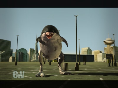

    The goal of new penguoen 2.38 was todo try todo reconstruct with Blender the wonderful 2005 Citroen c4 spot (the dancing Transformers one, made by embassy VFX).
    I loved that spot as i saw it, so i had the idea: wouldnt have ben funny todo replace the giant robotcar with a giant silly penguin? In the meantime, the Suzanne Awards deadline came out, so i thought todo submit it, if only it could be finished in time. The gag of the roasted penguin at the end of the animation came out in progress, so, as the headline of the original spot was new Citroen c4 - Alive with technology, the headline for my parody became new penguoen 2.38 - Coked with Blender 3d. 2.38 was the versión number of Blender i used, with all those new Marvelous animation features.

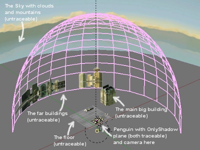

    By putting a sphere in the centre of the scene and making Little renders, y matched a los the direction and the intensity of the Sunlight. A Lamp under the flor provided a faq radiosity effect.
    751 frames may take a very long time todo render; Raytracing lamps casting shadows add a lot of time todo and if you have a very big setting, the Octre (bottom of render window, f10) must calculate very far objects. In the end the rendering times become huge, not the best for animations. So my priority was todo lower rendering times in every posible way.
    A bien todo do this is todo let the Octre calculate only the main or the moving elements in the shot, by setting the materiales for the motionless and far elements todo Shadeless and de-selecting the Traceable option in the material window. The Octre wont calculate the untraceable materiales and, as they are Shadeless, there are no shadows todo be calculated.

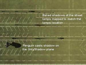

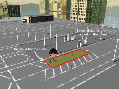

    But what about the penguin casting a shadow on the Shadeless flor? A small Onlyshadow plane has ben constrained (copylocation constraint, constraints panel f7) todo an Empty parented (Control + p) todo the armature, so todo follow the penguin movements. I deselected the z axis of the constraint, so the plane didnt Rise as the penguin jumped.
    Of course, every shadow and light effect for the Shadeless objects had todo be Painted in the textures, or baked in some way, the casted shadows of Street-lamps and baskets have ben baked by a rendering from above, and the alpha channelled image has ben mapped on an untraceable plane todo match their location.

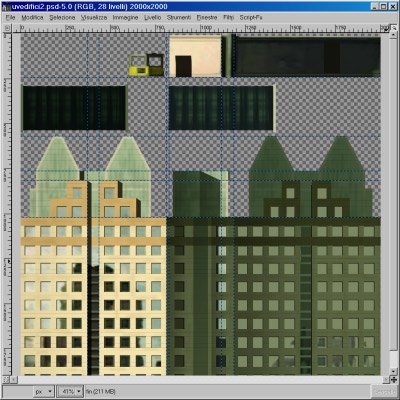

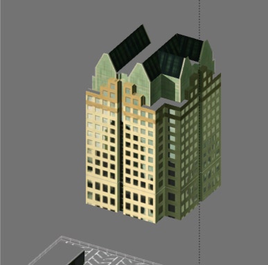

    The main building on the left Mid Ground has Shadeless materiales as well, but has ben modelled (only for the visible sides) just todo increase the perspective effect while the Camera is moving. Then, it has ben Unwrapped with the archimap UV Unwrapper Python script and the Layout exported in Gimp by the save UV face Layout script.

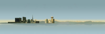

    Left is a Gimp screenshot of the main building textures with Painted shadows. On the bottom right, the background mattes: far buildings and Sky have ben saved as separated layers, the buildings with Alpha Channel.

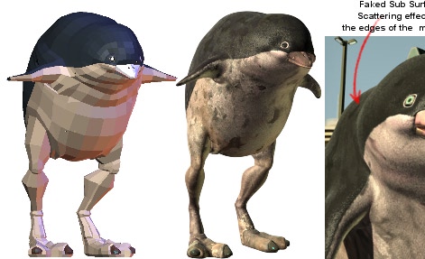

    The penguin has ben modelled starting with a Cube and extruding Faces, the usual polygonal modelling (modelling bongo tutorial here). Actually i had already modelled it some time before, it was the pengzilla (modelled just todo try the new Blender Softbody feature).
    Basically the body had two diferent materiales, the white skin and the dark skin.
    Several procedurals have ben used todo reach the final appearance. Procedurals are really useful but the more of them you use and, again, the longer are the rendering times. Image textures render faster.
    In this case, y baked the procedurals textures with the other texture baker script by blenderhead z3r0_d, the script works great but sometimes mirrors in some área the baked procedurals. Sin problema, a bit of painting in the Gimp and everything got fixed. A Damned useful script. Then, more painting todo add better details. Materials are very important to, all the penguins had oren-nayar and Blinn Shaders with ramps, the ramps colours matched the colour of the Sunlight and of the ambient shadows.
    A single blend procedural mapped on the Nor Map Input (material buttons) provided a faq sub surface Scattering effect.

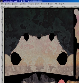

    A Gimp screenshot of the baked penguin textures.

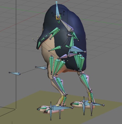

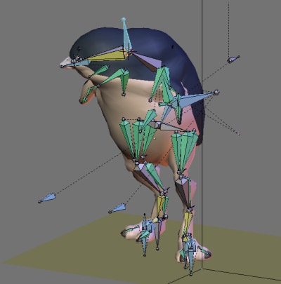

    Next steps were the rigging and the skinning of the Mesh (i must be honest: i usually do texturing, rigging and skinning almost at the same time. It works better todo me).
    With the new animation features, the rigging work flow has ben tremendously improved, now it is enough todo click on the screen todo add Bones, and by assigning the IK constraint todo one of them you can quickly build the IK chain. In just a few minutes, y remade the basic armature for the penguin and then started todo add constraints todo automate some functions.
    For example, y assigned two action constraints todo the back bone, targeted todo the pelvis one: as the pelvis rotates on the left or on the right, the bak rotates on the opposite direction todo balance the position.
    Or else, y added Bones for the fat, with Loocked track constraints targeted todo empties parented todo root Bones in the armature, the empties had a Slow parent (in the objects window, f7) of a few frames, todo create automated effects of follow th rouge and overlapping for the fatty áreas.
    I added a los Bones with stretch constraints in the legs áreas, todo simulate a minimum of muscles stretching.

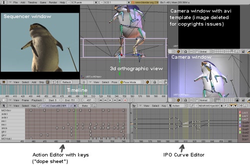

    I didnt use the non linear animation in this case, the whole animation has ben made in a single action. Using the original spot template as reference for the key positions, y animated with the pose todo postura technique.
    In short: assing keyframe positions for the character, setting all the animation Ipos todo constant (in the action editor select with a all the keys, go todo the key menú in the Header and then interpolation mode>>constant). This is todo establish the animation times. Then switch the keys todo linear and start todo add in between, creating a los arcs in the movements. Third, switch the keys todo Bézier and shift them where neded todo avoid actions happening all at the same time.
    In the ipo window (ipo curve editor) select curves, go in Edit Mode and modify the curves handles, todo Slow or speed up starting and ending of single movements. Of course i had todo rearrange the acting todo Conform it todo the penguin shape, quite diferent from the dancing robo-car. I made several tests of the animation by rendering the whole in OpenGL (hold Control key and press the last icon on the Header of the 3d window, pointed by the red arrow in the image).
    Usually i render the diferent elements as separated steps and then make a composite in the Blender Sequencer (Control + left arrow todo change screens, or else in the scr: menú on the top Header), this time i made all the rendering in one shot. Alos the quik transición from the jumping penguin todo the roasted chicken versión has ben made by switching in middle animation the penguin Mesh with a shift+d copy with diferent textures, by layers keys assigned todo both the meshes (i>>Insert Key>>layer).
    But the Sequencer has ben used anyway todo add the horizontal bars on the top and on the bottom of the framing, for the headline at the end and for the light darkening on the sides (just todo Mimic the c4 spot appearance).
    In Blender Sequencer i loaded a los the music (made with the open source software Audacity). By selecting the Sync button in the sound panel i could watch my animation with sound in real time, and pressing the mixdown button Blender exported a perfectly synchronised wave file. I then combined sound and animation in Virtualdub.
