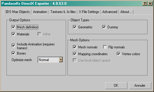

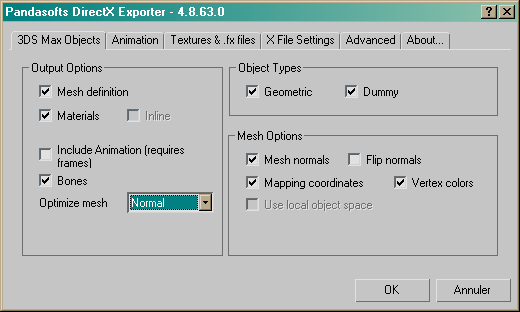

    2. Exporting a model without animation.

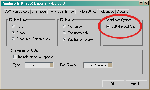

    Always make sure that left handed axis in the x file settings as this box sometimes un-checks itself for no reason. Actually, it is wiser todo un-chek it and re-chek it Even if it is already checked.
    Then Simply click export.

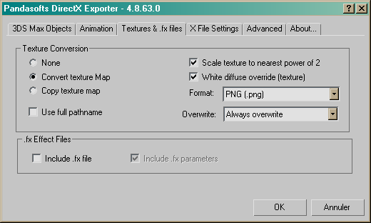

    Remark: it a god idea todo use texture dimensions that are Powers of 2 or some video cards Will resize the texture and your UV coordinates Will be all wrong.

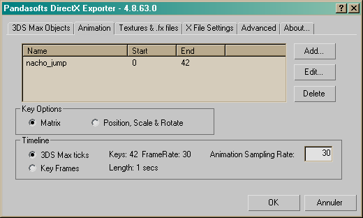

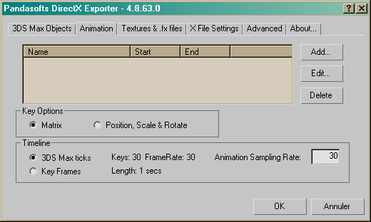

    To export the animations, un-hide the Bones or Biped then hide the model and use the following exported settings.
    Remember todo un-chek it and re-chek left handed axis.
    Were using Matrix keys and 3ds Max ticks for our animation options. Key frames didnt sem todo work (wrong speed). Positions, scale and rotate could be worth checking.
