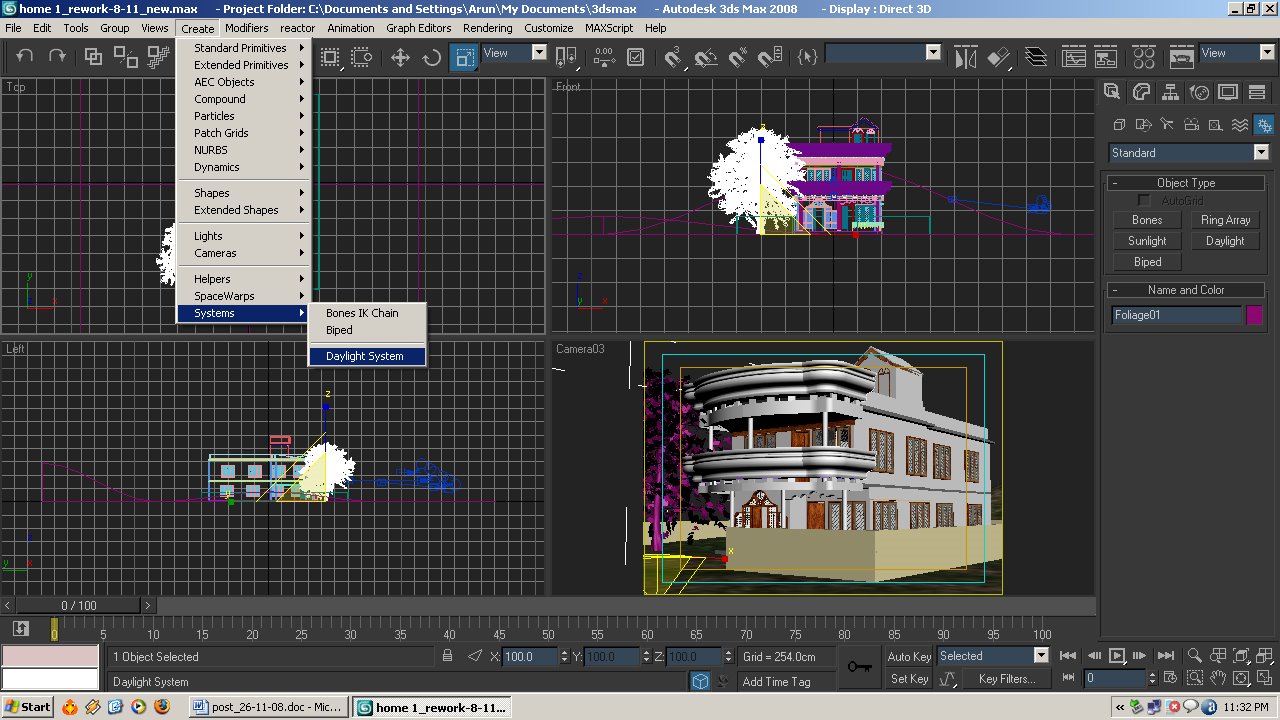

    * now from the create menú(not the create panel) go todo systems > Daylight system.
    * just create the system and max Will ask you for an exposure control change, just press ok.

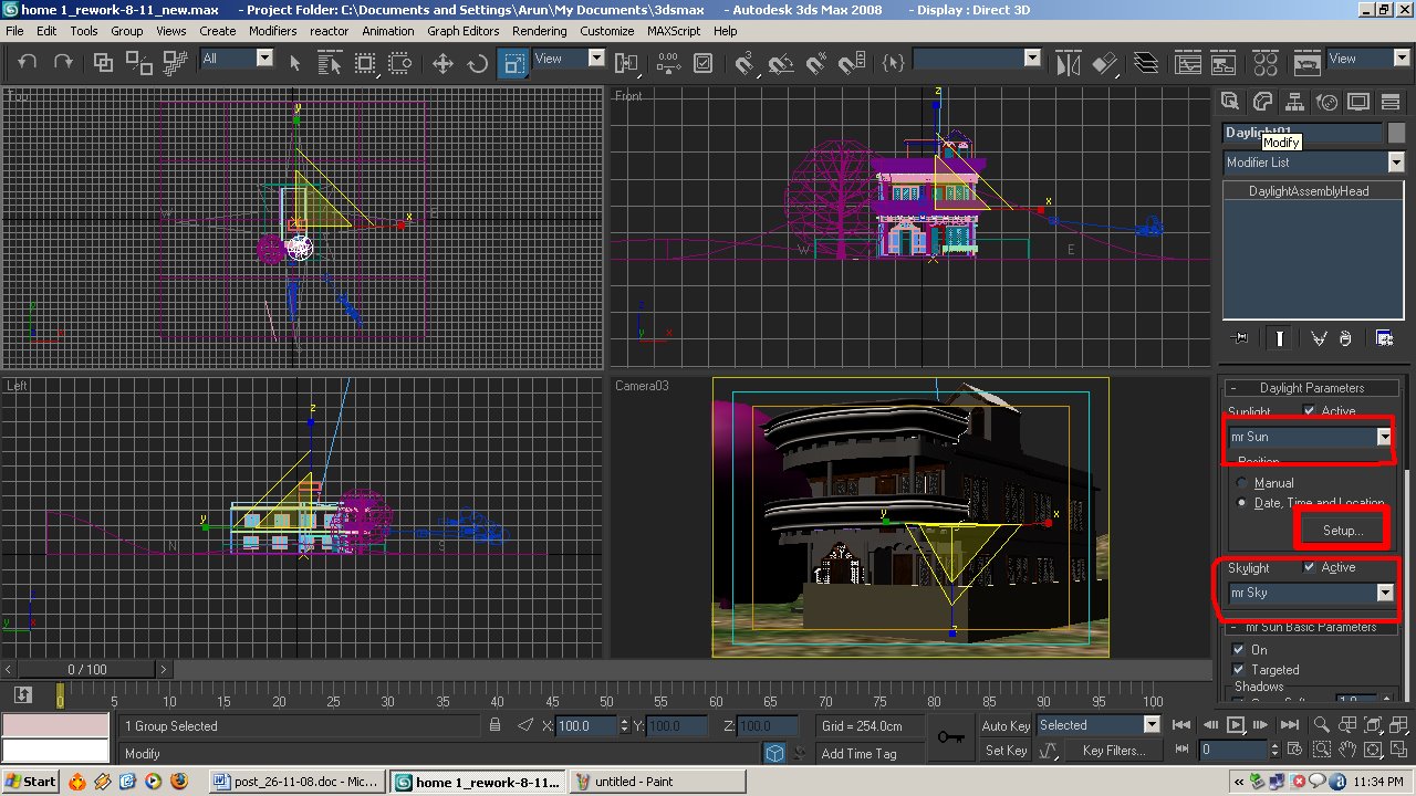

    * when you are creating a Sunlight system you Will be creating a compass first and then the light, for that drag the compass in top view port and then create the light.
    * change the Sunlight todo Mental Ray Sun and the skylight todo Mental Ray Sky then max Will again ask you for creating an Mental Ray Physical Sky as the environment map, just press ok.

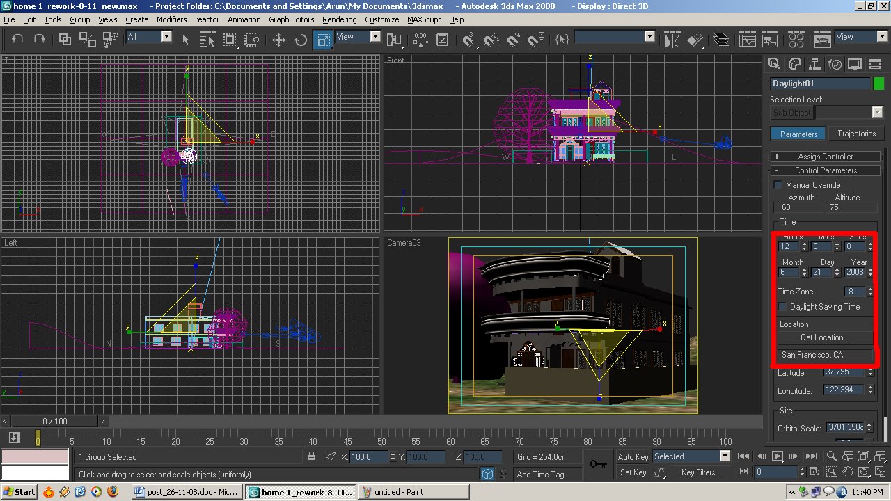

    * you are almost done now from the date, time and location button below the Daylight parameters you Will get a window like this, from there you can change the location, time and date of the scene, just like the real world max Will change the Sun position and a los the Sky color automátically.

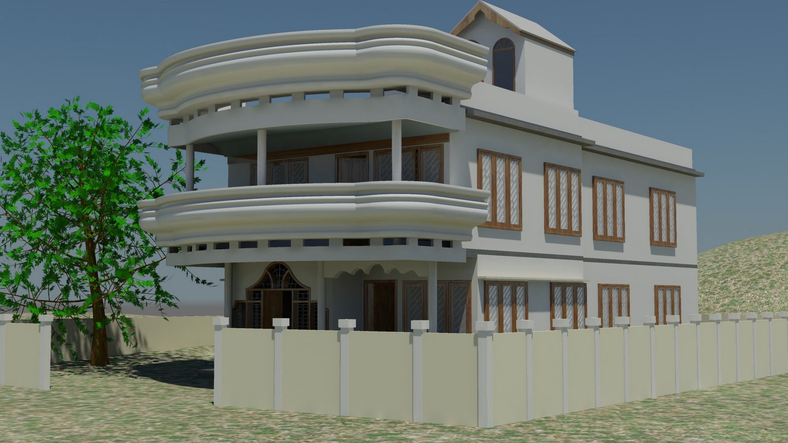

    * now render your scene with Final Gather enabled, isnt it nice?
    * i got a result like this.
