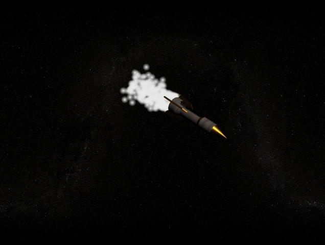

    · first open any scene with animation in it. For this i created a space scene with a spaceship and some particles.

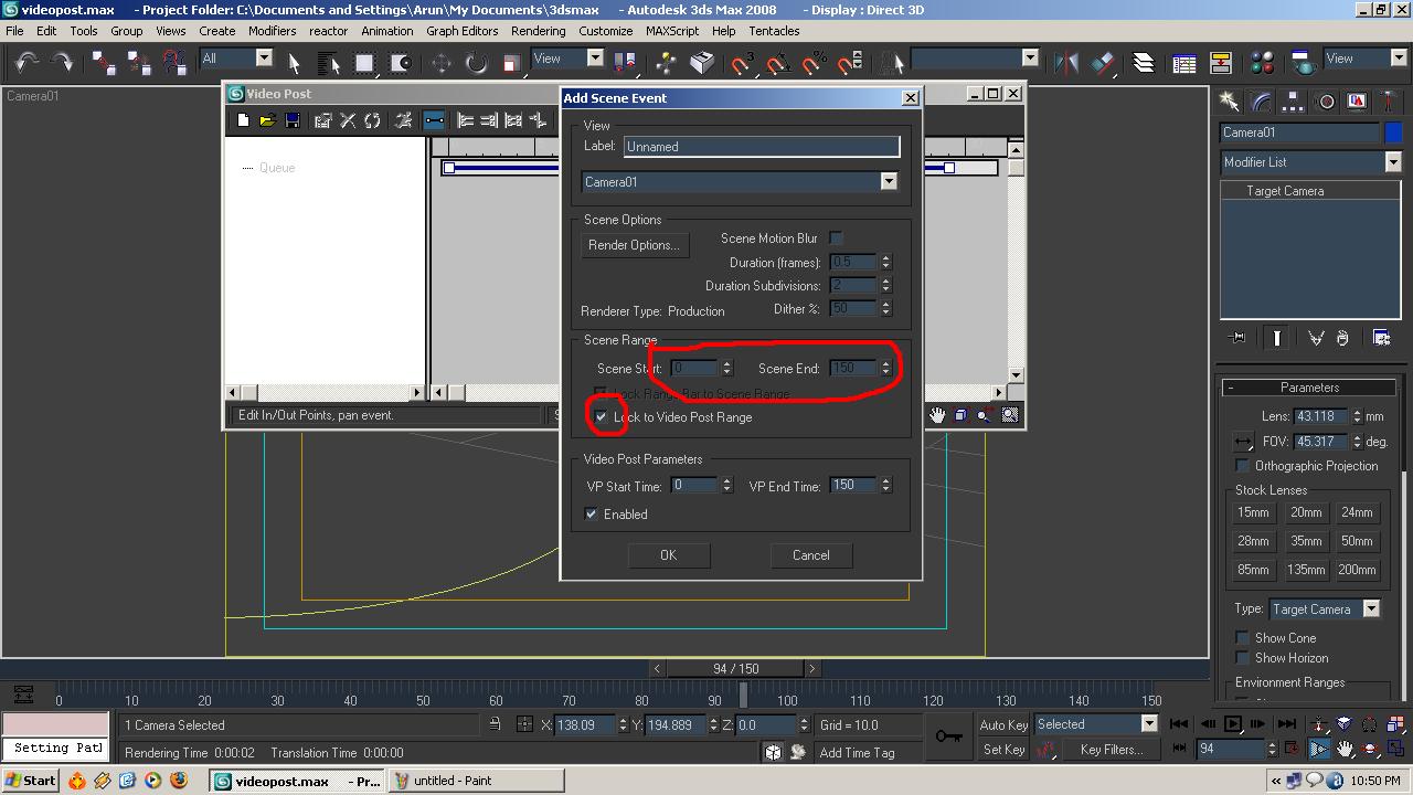

    · open the video mensaje window from rendering>video mensajes.
    · click the add scene event button in the video mensaje window.
    · you Will get a window like this, in that unchek the lok todo video mensaje range checkbox and in the scene range window, set your last frame as the scene start and vice versa.

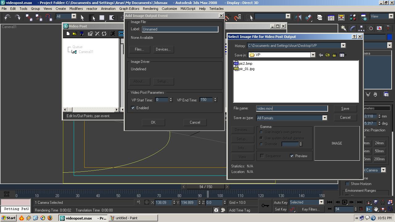

    · from the add image output event set a file name, format for your rendering and execute the sequence from the video mensaje window.
    · enjoy the reverse rendering.
