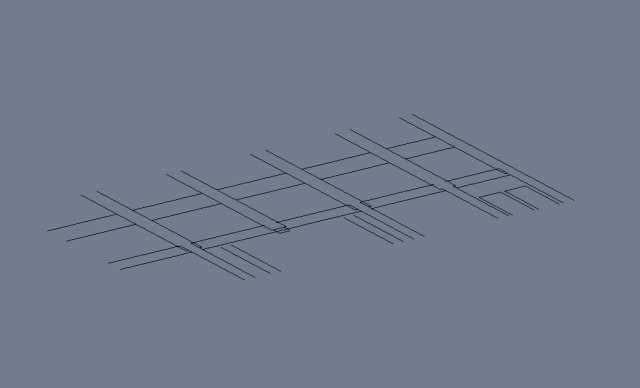

    Using CAD files todo create the basis of your model can mean that it is more a process of doing vertex-modeling (i, vertex todo vertex, creating Edges and Faces) than subdivisión-modeling. Blender toolset sems aimed squarely at subdivisión-modeling at the expensé of Even simple CAD type tools such as proper snapping, simple measurement, etc. This isnt a suggestion that Blender should be able todo do Cad, it suggesting that certain CAD features are just as valid in a 3d modeler as they are in a CAD application.
    Once the dxf file is imported, the first thing todo do is save it as a (*.blend) file, remove doubles and save again. Youre now ready todo start modeling.

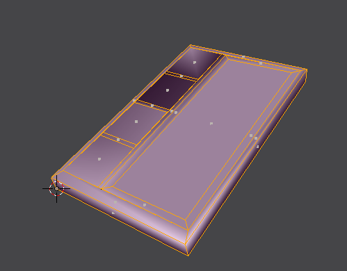

    In any versión After 2.37a, making a face and then extruding results in some nasty normals as sen above. The supposed solution is todo recalculate normals, but ive not found this todo solver the problem, it just shifts the problem about.
    One solution is todo extrude the Edges first and then make the face, for Whatever reason this resolves the normals problem.
    Unfortunately for me, y find making the Faces first and then extruding todo be the preferred method and continúe todo use 2.37a todo model buildings before using the current Blender reléase todo do the rest.

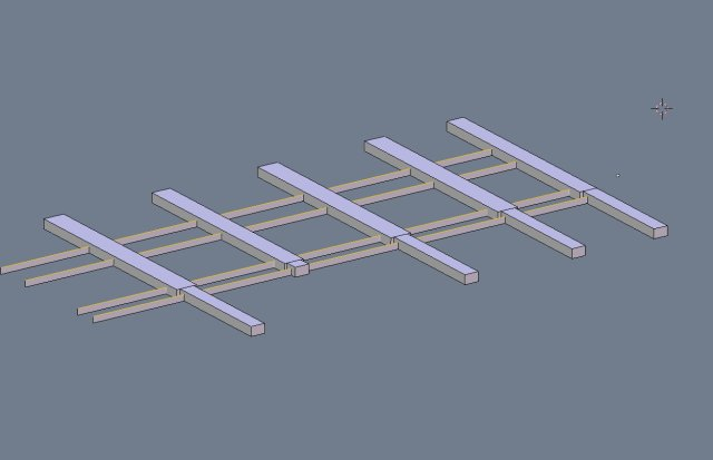

    Columns extruded first:

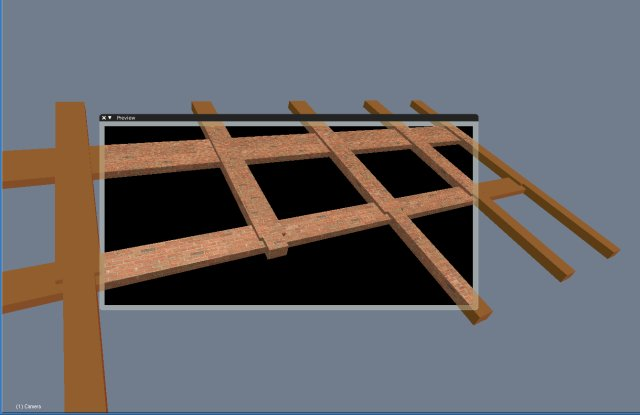

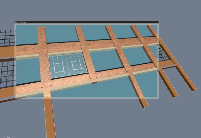

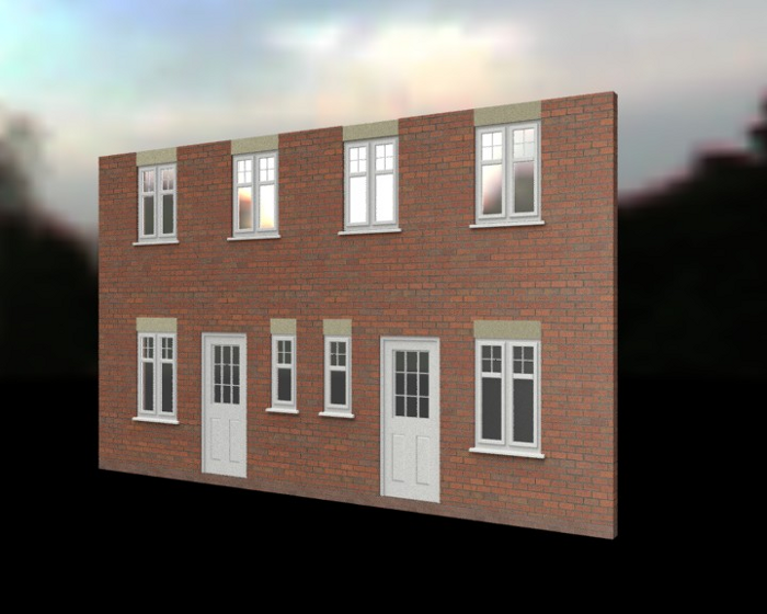

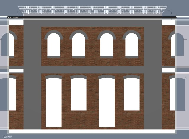

    Apply and scale texture map, preview, adjust scaling and position of map until it looks right:
    Try todo correct brik coursing around dor and window openings, especially.

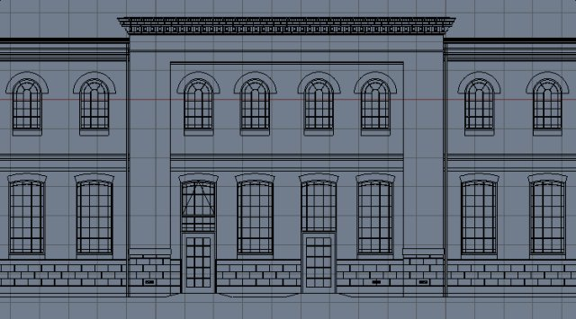

    Repeat the process for the other elements of the elevations such as lintels, window sills, Windows etc.

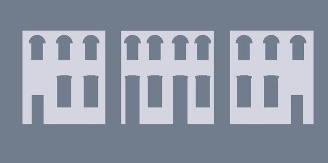

    An alternative approach todo modeling, which can be a fast bien todo get CAD building elevations with more intricate window openings into a 3d form is as follows:
    The building todo model.

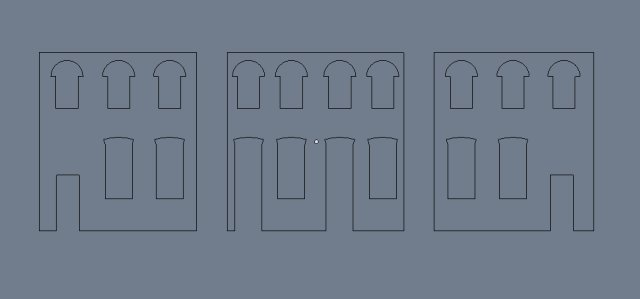

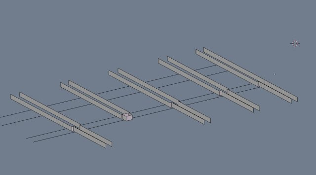

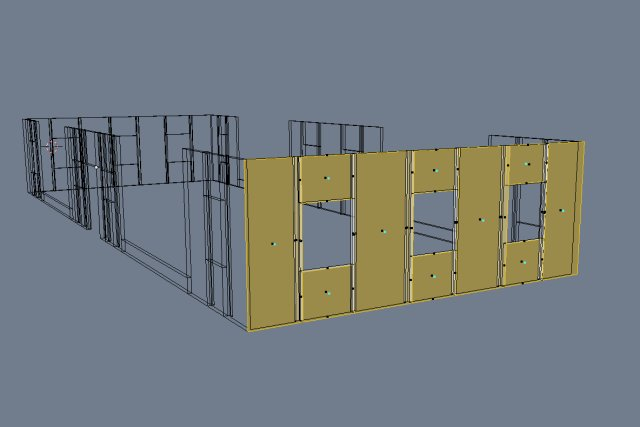

    First import the prepared dxfs. Notice window perimeters are todo the outside of the arched brickworque above the window openings and todo the bottom Edge of the window sill. The intention is todo model the arched brickworque heads and sills separately and in order for the mesh2curve, py Python script todo work, the outlines ned todo be simplified continuous shapes. The script is available from 3r website.
    Run the mesh2curve, py script and watch the meshes convert to curves. Save your work.

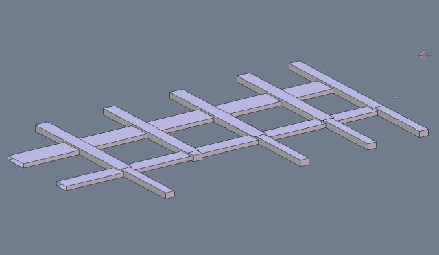

    Select and join with Control-j and the final wall panels are ready for extrusión vía the curves menú todo give a wall with thickness.
    The modeling can then continúe using the vértices and Edges todo create Faces. Extruding first, if youre not using 2.37a.

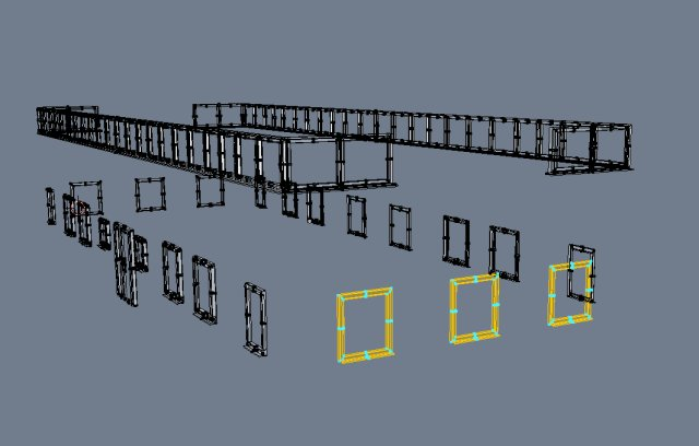

    Dor and window elevations could then be appended from blend files and added todo the openings. Other architectural features can then be worked up to complete the elevation. Possibly a rof/eaves/gutter profile imported from the CAD files and extruded around the building todo give a rof perimeter line that is ready todo start building the rof pitches, etc. The mesh2curve script can be used again for converting meshes todo curves for extruding along a Path.

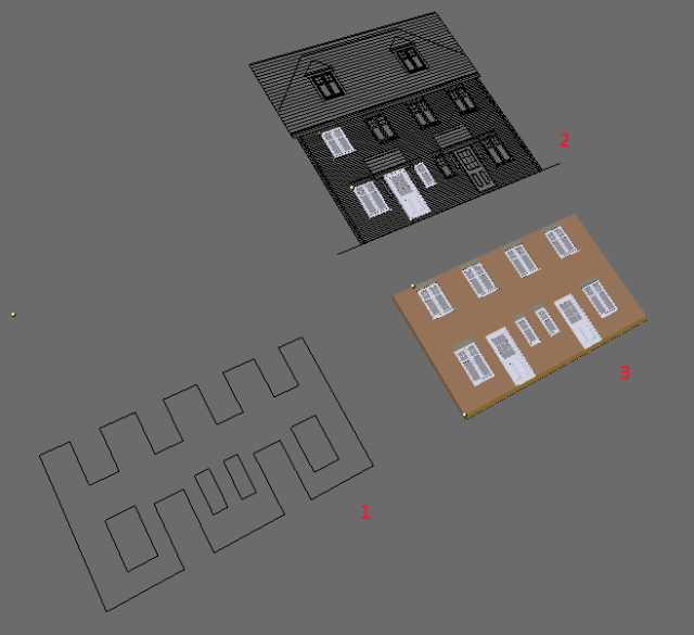

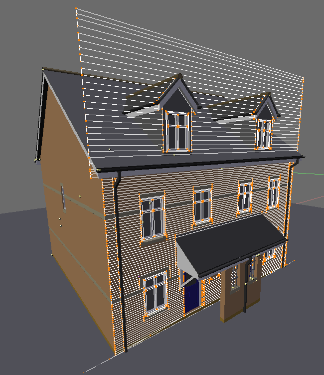

    Another example, a simple house elevation. For demonstration, ive applied basic textures and lighting todo show what can be accomplished very quickly in this way. A quik Yafray render with HDRI lighting.
    Import the prepared CAD elevations, including the simplified wall perimeters (1) for running the mesh2curve script on. Model the dors, Windows, using the Edges and vértices from the full-detail CAD elevations (2) and combine the extruded Walls created from the mesh2curve script with the individual dor and window objects created from the full-detail elevations(3).

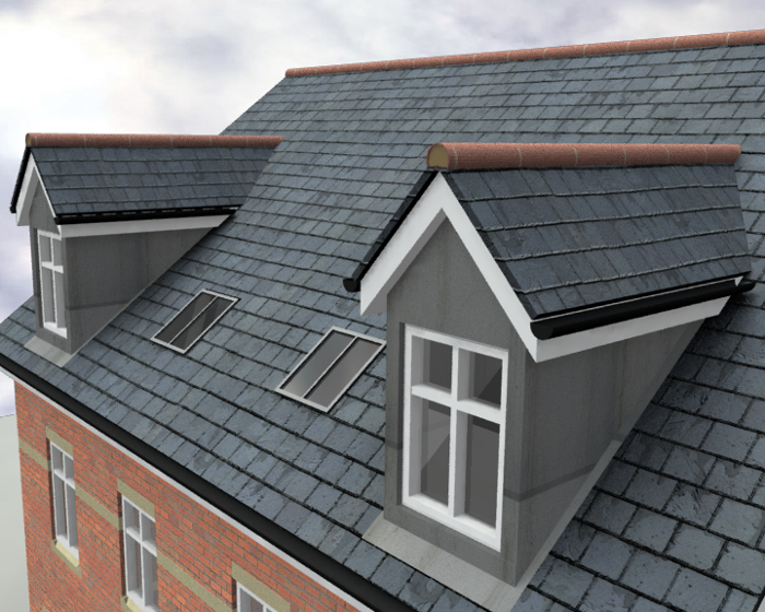

    Here are some images of another house model, done in the same way. Images are rendered with Yafray, skydome, Low, cached and HDRI image for lighting. They are unfinished works-in-progress as you can se. I am working on creating a library blend file of tres, bushes, planting, etc, textured and ready todo append into my scenes. Plant Studio is now free and there are Many plant and tree parameter files for download. The tres in this image are aspens made with arbaro using the default settings.
    All the elevational elements todo this house, for example the dormer Windows, canopies, rof lights, entrance dors, window styles and standard window sizes, are all objects estored in the library blend files ive created. So, y can quickly build the Walls todo a particular house as described above and then append in the objects i ned, from the library files (including a texture library), todo finish the elevations.

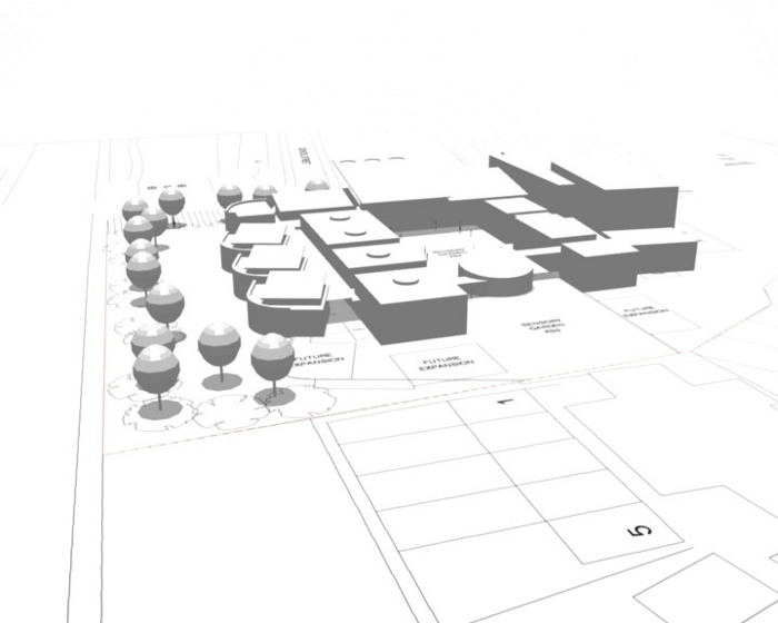

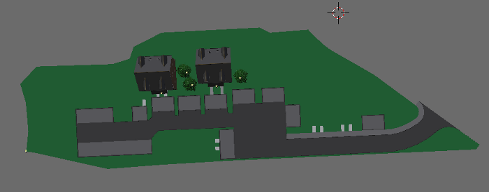

    You can model the basis of a hola for the site, on which you intend putting the buildings, in the same way. Import a cleaned up 2d dxf of the site survey, having first defined the perimeters in the CAD file for the various hola elements like the site Boundary, the área todo be planted and turfed, the outline of the roads and fotpaths. Then use the mesh2curve script on each of those perimeter lines todo convert them todo closed curves, giving you solid infill todo your defined áreas. Mesh (1) below is the perimeter for the landscaping. Mesh (2) was a full site import, but i have ben moving the meshes Edges onto the final site model and then modeling into 3d. The final site model was based on the curves generated from Mesh (1) by the mesh2curve script.
    As an alternative todo modeling the hola of the site, where perhaps youre just doing a massing model and want todo show the building in relation todo it surroundings, you could just use an image file as your site, perhaps colored up in the Gimp or Photoshop. Here a method:

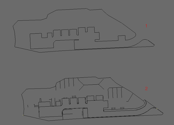

    In your CAD application, open up or create the proposed site plan. For example, from an ordinance survey, clean it up as described previously and then add a square border todo form a frame around the área of the site you wish todo show in your site image map.
    Save the CAD file as a dxf and put it th rouge the conversión process described earlier.

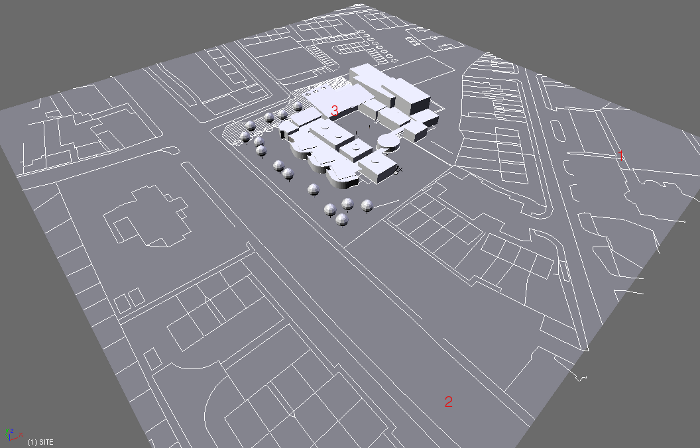

    Then in Cad, print the CAD drawing todo an image file. I use. (*.png) and use the border as your paper edge. In AutoCAD, ive setup a 5000 por 5000 paper size and then i select by window the square border. I a los use quite heavy line weights todo help the final image show up clearly when used in Blender. The resultant image could be colored up in the Gimp todo form an attractive site plan.
    In Blender, import the dxf, remove doubles etc. Use two opposite Edges that form the square and create a face. Then create a material with an image texture for the new face, the image being your site plan. Png. Set the image todo clip rather than repeat. The image Will hopefully now be registered accurately over the imported site plan Mesh. You can now extrude or model some of the surrounding buildings using the building fotprints of the site plan Mesh. Add your materiales, lighting and Camera. When rendered, the modeled buildings should appear todo sit accurately on the site plan image map.
    • (1) dxf import of site plan.
    • (2) plane with image map of site.
    • (3) SketchUp model.
    And a quik internal render. Work in progress again.
