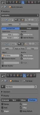

With all the Bones in their place, we now have todo prepare the Mesh of the Fish todo unite it todo the skeleton. It is necessary todo abandono the Edit Mode th rouge [t ab]. Select the Mesh of the celacanto, and look for the modifiers panel (represented by a.
Wrench). In add modifiers we assing the option armature and in the field object we select Fish bone.

After this procedure, when you select the skeleton while in pose mode, moving a bone Will move the skin of the Fish. Some imperfections can be corrected easily by toggling the envelope option in the armature panel, we adjust the envelope in such a bien that it covers the whole geometry of the Fish by scaling the root of the Bones with the s key in Edit Mode, if done correctly, the envelopes Will look like tin the figure, our clever Fish can now recover life th rouge the technique of animation and swim and travel in underwater environments generated by computer.
