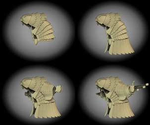

The model.
To translate the ideas of kaldewei into a model, y created a very coarse model of kaldewei body. It didnt have any de-tails, just the form of his proportions. Now i am able todo build the armor.
Nombre: 2.jpg
Visitas: 2016
Tamaño: 19.6 KB
The mask is a major element of the whole set of armor and tok a lot of time, but a god sketch helps a lot. After finishing the mask, y made the shoulder strap and the belt. They are not leading pieces in the finished model, but they are important pieces, because they stabilize the armor and Split the plate-armor into 3 parts.
What is missing are the plates. To postura and fit each plate on its own is very awkward and com-plicated todo change at a later time. So i modeled one plate, prepared it for UV mapping and Split the border from the rest by using two materiales.
Nombre: 3.jpg
Visitas: 2040
Tamaño: 42.1 KB
This plate is the base for all others in the model. I had made the plate-armor in strips. I used a plate, a curve, the array modifier, the curve modifier and some lattices.
I placed the curve on the coarse model at the place where the strip has todo be.
Array modifiers are able todo make plates along the length of the curve, the curve modifier put our plates in the form of the curve. To finish the job we use a lattice todo put our plate strip in the right form.

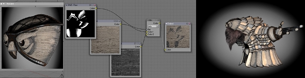

Texture and the UV.
The variety of details in the Wood is from the textures. A texture has todo fit thre requirements. First, it has todo have a huge resolution (2500 por 2500 píxeles), second, a lot of details like knotholes, cracks and so on, and third, it shouldnt have perspective blur or compromising blur.
I set up the UVS in two layers. The first layer is made for the texture images like the Wood or the rust. It is usual that Unwrapped UV elements Will overlap.
The second UV layer.
The other UV layer is for pre calculations like normal bump or Ambient Occlusion, and because of that the Unwraped UV elements are not able todo overlap, of course, y could use texture bake or projection painting and change my texture todo fit in one UV layer but this has 3 drawbacks:
1 you get a lot of texts very fast.
2 Many textures make mistakes.
3 you always lose detail by chang-ing a TeX-ture that much.
Nombre: 5.jpg
Visitas: 1349
Tamaño: 24.5 KB
