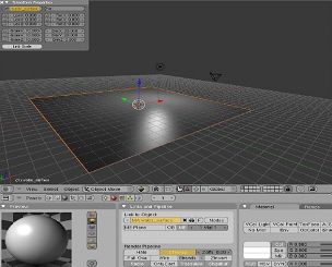

Lets begin, open up Blender and deleete the default Cube, change the viewport Shading type todo texture and in the game settings click Blender GLSL materiales, press space and select plane todo add a plane, press s and then ten todo scale the plane up by ten times. This plane is our water surface, so press n and rename it todo water_surface, once this is done, add a material todo the plane and name it water_surface. In the material settings activate ztransp, todo allow the plane todo have transparency.

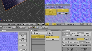

Now add the texture included called water_n.jpg. This is the Normal Map. It is what provides the ripple ef-fects. In the textures settings activate the Normal Map setting. Or lok online for a tutorial on how todo make an animated Normal Map texture yourself. There is a very god one here.
Visitas: 2740
Tamaño: 50.0 KB
Now change the text viewport todo a UV/Image Editor viewport. Select the Normal Map texture and click view -> real-time properties. Set up the real-time properties like you se in the picture bellow:

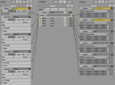

Link them up so that the first two new actuadores are linked todo the third controller, which should be linked todo the first property sensor. It should be clear how todo enlace up the rest now. Oh, and make the Cube invisible in the physics settings. Now we ned todo get the Camera todo move. Lok at the screenshot bellow todo se how the logic should be set up:
The highlighted names must be like they are in the picture. Now add another script in the text window, this time from the Mouselook, txt file. Name it Mouselook. Now write Mouselook in the Empty script box you now have in the logic panel. Press num-pad 0 todo go into Camera view and press p. You should now be able todo fly around using the w, a, d keys and use your mouse todo look around. If you fly underwater, everything should go foggy and the Edges of the screen should be blur and when you exit the water the effects should disappear. If not, something has gone wrong in the Empty logic. The last step is todo add another plane just slightly under the water, facing downwards. Make a new material for it and give it the water_n texture, tiled 20 times. Apply the texture as Nor (not col). Colour the texture blue-ish and play the game. When you look at the sur-face from underwater you should se ripples. If not, mess around with the Map Input settings some more.
