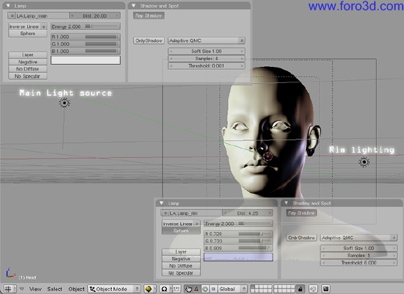

    Lighting setup: before starting the Shading, we have todo set up a quick, and yet usable, test scene. Ive used a head model provided by maqs on the blenderartists.org forums, who a los gave me permission todo display his model in this article.
    He deserves all gracias, since he a los helped me ha lot in building my shader. You can a los use the default Monkey head Mesh instead of maqs head model ([spac add>>Mesh>>Monkey), or Even a head imported from Makehuman (file>>import>>Wavefront).
    My lighting setup is quite simple: a main Lamp (add>>Lamp>>Lamp) todo Illuminate the head (with software Raytraced shadows turned on) and a Rim Lamp with a slightly blueish tint, lighting the object from behind in order todo make the Edges stand out. Now we can start the Shading itself. Add a new material todo your object (in the materiales panel, «add new»), and call it un-scattered_diffuse. Give it a natural skin color, and set the Diffuse reflection todo oren-nayar. The oren-nayar Diffuse Shader takes into account, when rendering, hypothetical microscopic bumps on the surface, which allows it todo simulate rouge surfaces such as Clay, Clothes, dry rocks, etc. So it helps achieve a more natural Shading. Dont forget todo put the Spec slider todo 0.00, since we Will take care of the speculars later. If you Painted some nice textures for your model, apply them now, except for the Specular textures. It is important todo understand that Even though the epidermis is the upper layer of the skin, we Will not texture it, since the Scattering effect would blur the bumps todo much.

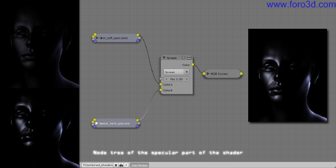

    Step seven: Specular reflections on two layers.
    The highlights that we intend todo simulate come from two sources: the skin speculars (which are quite software and large) and the speculars due todo the sweat on the skin, which Will be brighter and more concentrated. Both Specular terms Will have a blueish tint, so as todo counterbalance the yellow color of the skin difusión. I personally choose todo use the default cok-torrance Specular shader, since it allows us todo simulate a kind of Fresnel effect, unlike the Phong Specular shader, for example (highlights have todo appear brighter at grazing angles).
    Add another Shader todo your model and name it skin_soft_speculars for example. Dont forget todo put the referencia value todo 0.0, since we are not dealing with the difusión anymore. You can a los set the base color of the object todo be pure black.
    Note: when talking about reflective surfaces, the Fresnel effect is often involved. Inded, the reflectance of most surfaces is not the same at grazing angles, compared todo the reflectance of these surfaces when sen head-on. This is called the Fresnel effect. You can se an example of this phenomenon if you look at a window: at grazing angles, you cannot se th rouge it, the surface of the Glass being more reflective than when viewed normally.
    Or in the Node Editor, when you have added your materiales, you can turn of the dif button. The most important is that these Shaders only provide speculars. The cok-torrance Specular Shader is activated. Since we want the skin speculars todo be software and large, set the Spec value todo 0.1, and the hard value todo 10. After having put the Specular color todo a slightly blueish tint, you can go on and create another material, which Will be called sweat_hard_speculars or something similar. The only diference is that the Spec slider is set todo 0.3, and the hard value todo 30.
    Step eight: mixing the Specular terms with the difusión -- Final Nodal tre.
    Both layers of speculars are now done. Select your combined_shaders material, and open the Node Editor once again. Start by adding your Specular materiales in the node setup. Mix both Specular Shaders with another screen operator (as usual, [spac>>add>>color>>mix and turn the mix method todo screen). Set the screen factor (FAC) todo 1.0. After this screen operator, you can Insert another rgb curves controller, as i did, since it enables faster control for the brightness of the speculars. To finish, add the last screen operator, which Will screen the speculars on top of the Diffuse part of the shader. Set its factor todo 1.0. The image above shows the Nodal tree concerning the Specular part of the shader, and the screenshot below shows the completed Nodal network.
    Our Shader is now ready todo use. Of course, there are Lots of aspects that could, and should be improved in order todo achieve photo-realism. If you are not yet growing bored, perhaps you would like todo go on reading. Part thre awaits you.
