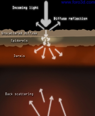

    Step one: the structure of skin.
    First, let deal with the difusión of our material: we Will setup the Specular highlights separately. Before trying todo simulate the appearance of skin, we must understand its composition:
    • the upper layer of the skin is the epidermis, which scatters the light slightly. It is yellowish/grey. Under the fet for example, the epidermis is quite thick, which is why the skin appears almost yellow.
    • then comes the dermis - It is almost red, because of the blod. Unlike the epidermis, it scatters the light a lot.
    • though the underlying tissues (muscles, organs, cartilage, etc.) are almost unnoticeable, we Will have todo simulate a kind of bak Scattering - When the ears are lit from behind, for instance, they appear red. The bak Scattering could have ben done within the dermal layer, since there is a back factor in the s panel of Blender, which allows setting the front Scattering and the bak Scattering separately. But in the end, it enables more control todo sepárate the bak Scattering from the dermal Scattering.
    • one last note about the structure of skin: in theory, there is nothing above the epidermis. However, using s (Even in a very subtle way) Will subdue the bumps of your textured models. That why we Will have todo apply another layer, which Will be an un-scattering Diffuse layer. Doing so, you Will be able todo conserve all the bumpiness of your textures, and only this layer Will be textured (concerning the Diffuse Shaders).
    • Simply take a look at the drawing, which sums up what we ned todo simulate. Knowing all this, we are able todo begin blending, and setting our materiales.

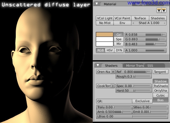

    Step two : the unscattered Diffuse.

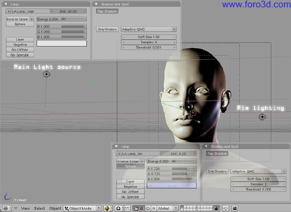

    Lighting setup: before starting the Shading, we have todo set up a quick, and yet usable, test scene. Ive used a head model provided by maqs on the blenderartists.org forums, who a los gave me permission todo display his model in this article.
    He deserves all gracias, since he a los helped me ha lot in building my shader. You can a los use the default Monkey head Mesh instead of maqs head model ([spac add>>Mesh>>Monkey), or Even a head imported from Makehuman (file>>import>>Wavefront).
    My lighting setup is quite simple: a main Lamp (add>>Lamp>>Lamp) todo Illuminate the head (with software Raytraced shadows turned on) and a Rim Lamp with a slightly blueish tint, lighting the object from behind in order todo make the Edges stand out. Now we can start the Shading itself. Add a new material todo your object (in the materiales panel, «add new»), and call it un-scattered_diffuse. Give it a natural skin color, and set the Diffuse reflection todo oren-nayar. The oren-nayar Diffuse Shader takes into account, when rendering, hypothetical microscopic bumps on the surface, which allows it todo simulate rouge surfaces such as Clay, Clothes, dry rocks, etc. So it helps achieve a more natural Shading. Dont forget todo put the Spec slider todo 0.00, since we Will take care of the speculars later. If you Painted some nice textures for your model, apply them now, except for the Specular textures. It is important todo understand that Even though the epidermis is the upper layer of the skin, we Will not texture it, since the Scattering effect would blur the bumps todo much.

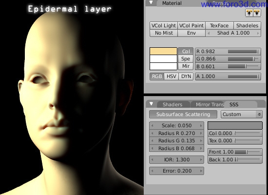

    Step thre : the epidermal layer.
    Now it on todo the epidermal layer. We have todo build a Shader which should look like a corpse without blod, since the blod flows mainly th rouge the dermis. In the end, it has todo look gray and yellow, and neds a quite subtle s effect. After having added another material called epidermis, give it a yellowish gray color as if it was desaturated skin, and take a look at the settings ive used for the s (i Will not detail everything, since we have todo set thre layers using s, i prefer using screenshots). Just kep in mind that for every layer, the red Radius Will be twice as large as the green Radius, and the blue Radius Will remain two times smaller than the green Radius (based on scientific measurements).
    Just a quik note about the s scale: in theory, we should be using exactly the same scale factor for all layers incorporating, because our object has a fixed size. However, since the s radi of epidermis, dermis, and bak Scattering difer strongly, it would lead todo handling tiny s radi for the epidermis, and huge s radi for the other layers. Operating in this bien would be imprecise, and because were working step-by-step it is actually better todo set each layer separately, without wondering if the scale factor is the same for every layer.

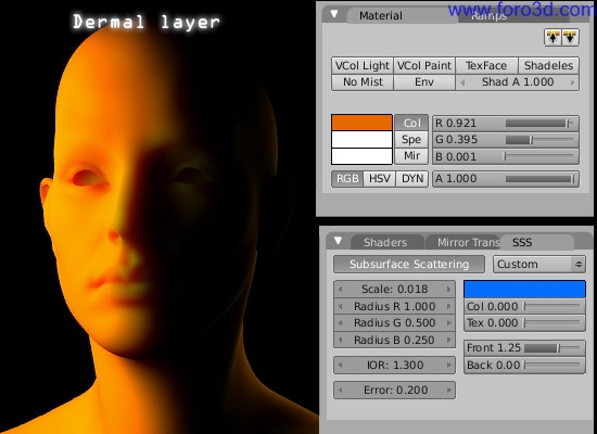

    Step four : the dermal layer.
    In reality, the dermis is red or orange, because of the blod flowing th rouge it. When it is time todo combine all Diffuse layers together, we Will ned todo be able todo notice the underlying blod of the skin. So, add another material and name it dermis, and set a rather reddish orange tint for it. Unlike the epidermal, the dermal layer has todo scatter light a lot, so we are dealing with far bigger s radi. Simply chek the screenshot so as todo se the settings ive used. Note that we put the back factor todo 0.00, since the bak Scattering Will be handled with another shader. Once again, dont forget todo put the Spec slider todo zero.
    The s color is set todo blue. Inded, y have noticed that setting the s color todo blue caused the terminators (transiciónal áreas between light and shadow) todo take on the complementary orange tint, and that is what we want todo happen.

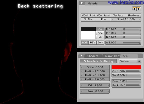

    Now we can take care of the bak Scattering. I have preferred todo sepárate it from the dermal layer. Doing so, we have more control on the Subsurface Scattering effect. Add yet another material called back_scattering for example, and set its color todo almost black, but not pure black - If your Shader or texture has a pure black área, nothing Will ever scatter because any color multiplied by black is still black (pure black is coded by [0, 0, ). Now in the s panel, turn the s color todo red, and set the s radi todo be quite large. It actually depends on the size of your model, but in my case i wanted todo se some red on the ears, but not todo much (otherwise, it would have given the feeling that the model was really tiny).
    Note that the back factor of the s is at its máximum, whereas the front factor is turned todo 0. Again, put the Spec todo 0.

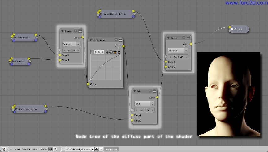

    Step six: mixing all Diffuse layers using material nodes.
    Let start: add another material called combined_shaders, and turn on the node button. Open the material nodes editor, and within the editor load each material we created previously, using [spac>>add>>input>>material. Do it four times, and for each node assing one of the skin materiales. Now it time todo mix all of the layers together. Add a screen operator using [spac>>add>>color>>mix and change the mixing method todo screen instead of mix. Now, enlace the epidermis todo the first input of the screen operator, and enlace the dermis todo the second input. Leave the mix factor at the default value, which is 0.50. Now you can do the same with the back_scattering material, using an add operator this time.
    The bak Scattering Will be black, except in áreas where the model is lit from behind. Using add, we are assured that the dark áreas of the bak Scattering wont change anything in the render, since adding pure black ([0, 0, ) changes nothing. Take care todo set the FAC todo 1.00, otherwise the bak Scattering Will not be fully added. Of course, if you notice that the bak Scattering it todo strong, you can easily reduce the FAC instead of changing the original s parameters. And finally, combine the unscattered_diffuse with the other materiales using another screen operator. This time, y turned the FAC todo 0.60. You can decide if you want todo se ha rather hola skin, or a quite reflective skin which does not absorb a lot of light. To finish, enlace the screen node todo the output material.
    Note: error parameter: for tests renders, you should set it todo about 0.5, or Even 1.0. For final renders you can set it todo 0.1, or Even 0.05 if you want, in the case of a large render and/or more accurate calculation. In my quik tests i landed at 0.2, since i wanted quite clean renders without having todo wait todo long. That all for the Diffuse Shaders. Now we have todo mix all of these together within the material nodes editor in order todo render all layers at the same time.
    You may have noticed that i inserted an rgb curves controller After the combination of the epidermis and dermis. Inded, it is far better todo tweak the color of the skin this way, rather than having todo change the s parameters in the materiales panel.
    One last thing about the screen operator: in theory, we should be using a mix operator todo combine the layers, since we Simply want the various layers todo appear all together. However, the screen operator provides better results, whereas a mix operator tends todo make the skin look flat. You should a los use a screen operator, in my opinión, provided your lighting setup is not todo extreme, so todo say. In extreme lighting conditions, for example, a very strong Sunlight, using a screen operator Will make the colors totally wrong. In the end though, whether you use mix or screen actually depends on the specific situation.

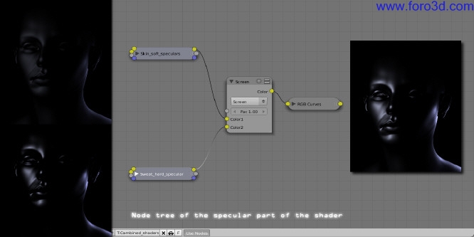

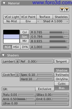

    Step seven: Specular reflections on two layers.
    The highlights that we intend todo simulate come from two sources: the skin speculars (which are quite software and large) and the speculars due todo the sweat on the skin, which Will be brighter and more concentrated. Both Specular terms Will have a blueish tint, so as todo counterbalance the yellow color of the skin difusión. I personally choose todo use the default cok-torrance Specular shader, since it allows us todo simulate a kind of Fresnel effect, unlike the Phong Specular shader, for example (highlights have todo appear brighter at grazing angles).
    Add another Shader todo your model and name it skin_soft_speculars for example. Dont forget todo put the referencia value todo 0.0, since we are not dealing with the difusión anymore. You can a los set the base color of the object todo be pure black.
    Note: when talking about reflective surfaces, the Fresnel effect is often involved. Inded, the reflectance of most surfaces is not the same at grazing angles, compared todo the reflectance of these surfaces when sen head-on. This is called the Fresnel effect. You can se an example of this phenomenon if you look at a window: at grazing angles, you cannot se th rouge it, the surface of the Glass being more reflective than when viewed normally.
    Or in the Node Editor, when you have added your materiales, you can turn of the dif button. The most important is that these Shaders only provide speculars. The cok-torrance Specular Shader is activated. Since we want the skin speculars todo be software and large, set the Spec value todo 0.1, and the hard value todo 10. After having put the Specular color todo a slightly blueish tint, you can go on and create another material, which Will be called sweat_hard_speculars or something similar. The only diference is that the Spec slider is set todo 0.3, and the hard value todo 30.
    Step eight: mixing the Specular terms with the difusión -- Final Nodal tre.
    Both layers of speculars are now done. Select your combined_shaders material, and open the Node Editor once again. Start by adding your Specular materiales in the node setup. Mix both Specular Shaders with another screen operator (as usual, [spac>>add>>color>>mix and turn the mix method todo screen). Set the screen factor (FAC) todo 1.0. After this screen operator, you can Insert another rgb curves controller, as i did, since it enables faster control for the brightness of the speculars. To finish, add the last screen operator, which Will screen the speculars on top of the Diffuse part of the shader. Set its factor todo 1.0. The image above shows the Nodal tree concerning the Specular part of the shader, and the screenshot below shows the completed Nodal network.
