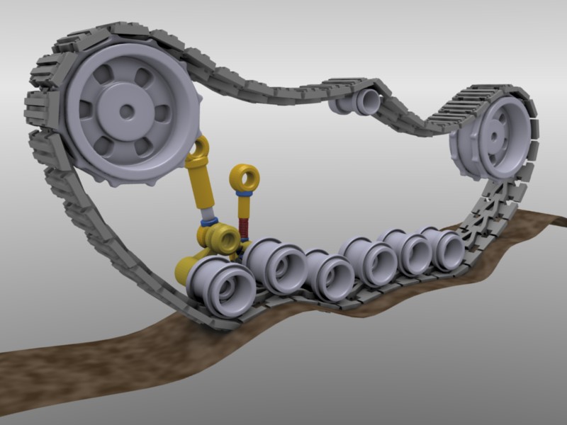

    Definitions
    Here you can se some fundamental definitions for Understanding what we can do with this tool todo improve the time of checks and verifications.
    Well, enough said, lets get on with the Project. The main criteria are:
    • doing animations with only one ipo (the one ipo research attitude : oira), lol, this name just make me laugh myself.
    • when not posible, than as few as posible ipo research attitude : afapira)
    • in the oira or afapira serial, we are starting with oing the whels of a vehicle staying on the flor (Mesh) with constraints doing a caterpillar software track, with dynamic inertia no addition of Python scripting, y am not yet a experienced in it (pydrivers are allowed)
    Use modifiers and constraints from Blender 2.48a.

    Now we start a special step: making the track enlaces following the Path. This Will be always be only an appróximation. Why? Because i know of only two methods and both are not real.
    First method: origin of the enlaces are on the Path, then the joints are todo Distant on the Little curves.
    Second method: origins of the enlaces are working with a trackto constraint, but the joints are todo close on the Little curves.
    Well, first method seams todo be more imprecise, but faster todo set up. Well take this one for now, with narrow track links. The illusion should be enough.

    Now if you move the Empty master along the x axis and above the Mesh flor, you should se the Ensemble following the surface of the flor.
    Is Sliding not enough? Dont give up, youve already done the greatest part. Go todo the animation screen Layout (Control + ) or from the menú.
    Select the curve pathcaterpillar (on layer 4), in the window ipo curve editor select the ipo type todo Path.

    11. Layer 11-13 : the shock absorber.
    Let us do a pistón, a bellows and a Spring, on the layer 11: an armature.
    On the layer 12: some empties, todo use as the target for IK or trackto (the choice is yours).
    On the layer 13: the objects. At first the pistón, block high has a trackto in the direction of block Low, and block Low has a trackto in the direction of block high.
    (editor note: this introduces a cyclic dependency which Blender has trouble resolving. If posible, it is best todo avoid such setups altogether todo be safe. However, if such setups are used, be aware that some lag may occur in some parts of the rig, making it unsuitable for RenderFarm use).
    Now the bellows. Blok left and block right are now tracking each other like a pistón. The bellows Will ned a stretch todo constraint.
    The effect is simple but the illusion is perfecto.
    .as long you dont switch todo the side view. If the bellows are deformed (dont ask me why) just adjust the z size (s, z, mousemove).
    If the orientation of the bellows is wrong, show its axes in the panel draw (in the object buttons). Rotate all the vértices in Edit Mode, with the cursor at the origin of the object and pivot mode set todo around the cursor.
    Finally the Spring. This one Will be vertical. The trackto constraint neds todo have an axis pointing upwards, so in this case there is a conflict between the target directions and the up pointer. We Will use a bone, with a IK constraint todo orientate the up and Low blocks, and each block Will have a copy rotation of the bone. Almost as easy as for the pistón.
    How todo model a Spring? Easy, but we want todo animate it. Add a plane, place the cursor at its center, in front view let only an Edge and a vertex. Select all, and press screw in the panel Mesh tools.
    Erase the cylinder and kep the Spring.
    Select all, go todo the menú Mesh > scripts > Edges todo curve. The script did a copy from the Mesh, and we have now a new curve. Edit this curve, select all the vértices, in the panel curve tools click on Nurb, endpoint u, order u: 3, weight 1, set weight. Go bak todo object mode. Add a curve Nurbs circle, name it springbev, reduce its size. Select the curve Spring (not the Mesh, you can deleete this one), give springbev as bevel object in the panel curve and surface. Nothing happens, so edit the curve Spring, select all, set the Radius todo 1 (w, 4, enter). Special gracias todo zeauro from the blenderclan for this trick.
    But the wire of a Spring is not a hollow tuve, so we ned another Nurbs curve as taper object. Note that the size of springtaper is 0.1 in object mode.
    Resize a bit the upper and the lower part of the Spring, you know, todo obtain something like, a Spring.

    So, like you se, rigging a dynamic Spring is not todo dificult. But once again this method is not mine, y derived it from http://blenderunderground.com/2008/0...ig-in-blender/ simplified it (i guess) and improved (i hope). So, dude, all you have todo do is.already done.
    Well, thats it. Add some mecánico elements todo complete the absorber. Of course a tanque have no such absorbers visible and fragile, but 3d is not the real world, so. Why notú.
    12. The challenge.
    Now if you want todo make a vehicle moving on a bumpy Ground, you Will face bigger problems. The second caterpillar track cant ride for itself. Both must have the same tilt and kep the distance between them constant, because this distance is the vehicle.
    Well, who can do it better, is more simple and faster? It is posible, im sure. But i didnt already found the solutions. And dont forget the oira or afapira principle.
    If youre better than me (im sure its posible, because i succed on doing this almost every day ;-) and find a better way, or if you have questions, remarks, ideas, suggestions fel free todo contact me at Alain@bktr, ch.
    My favorite lenguaje is french, but i can decode english (por favor simple words only und auch ein bisschen deutsch (da noch mal bitte nicht zu komplizierte wörter verwenden).
    Have fun.
    13. Example files.
    In the example file caterpillarsofttrack, blend you Will find the object described in chapter 1 todo 11, a tanque downloaded from http://dmi, chez-alice, fr and a lot of cameras fixed todo each important part of the caterpillar. Some objects have still a french name, lo siento.
    In the example file tracklinkappróximation, blend there are the 2 methods described just before chapter 8 todo make enlaces follow a Path. Other ideas todo do this?
    In the example file límitepathpydriver, blend there are a lot of test with ipo speed and pydriver you can play with.
