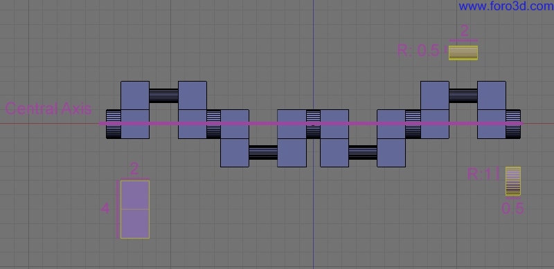

    The crankshaft.
    The crankshaft is just some cilindros and cubes. The two inside pistón joints are a set and the two outside pistón joints are a set. If you are going todo Rig your crankshaft with these instructions, the two inside should point do, and it should rotate around the x axis.

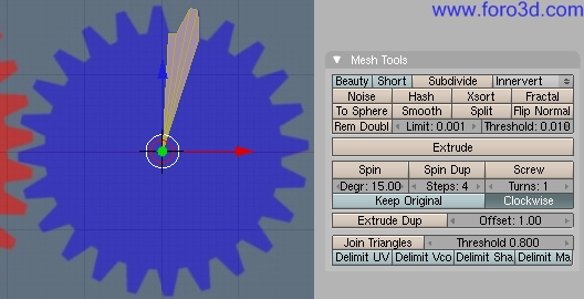

    The gears and fan.

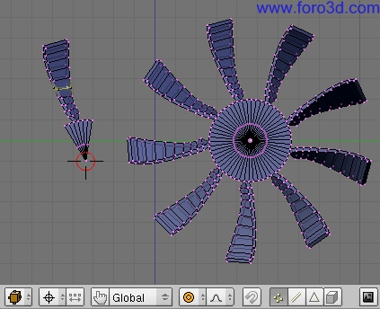

    To find the Degrees of rotation for each toth, divide 360 by the number of teth. For this example there are 40 and 24. Spin duplicate 360 Degrees with the number of teth as steps. Be sure todo remove doubles[w>> remove double and any internal Edges.
    Download a useful background image here: (link todo gears for modelling(not shown), jpg).
    To give the fanblade it curve, just rotate the middle vértices with proporcional edit on.

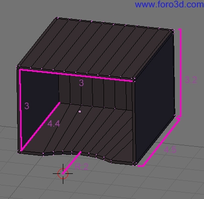

    The pistón cases and lead
    • the lead block.
    • the lead housing.
    • the pistón housing.

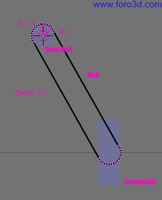

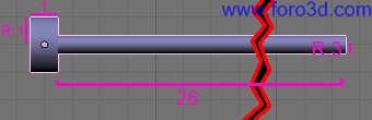

    The camshaft, belt and valves
    • the camshaft.
    • the Cam and Valve.
    • the belt.

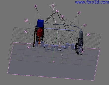

    The rigging setup mirrors, in a way, the Mechanical procesos in the machine. Rotation constraints ACT as gears and belts, location constraints like rods pushing bak and Forth. But because Blender is primarily an animation suite, there are some tricks that have todo be done diferently than in an actual Physical representation. The goal is todo visually demonstrate, not build a physics simulation.
    The piestons.
    While doing the piestons, it is especially important todo be tho rouge and follow instructions carefully. Even missing small steps can cause very Strange looking reactions. Time spent double-checking Will prevent headache in the long run.
    Select the crankshaft and add a keyframe for rotation (i->root). Go ahead todo frame 11 and rotate the crankshaft around the x axis 120 Degrees. Key the rotation again and open the ipo window. Select the green x rotation keys and open the curve menú at the bottom of the window. Open extend mode and choose extrapolation. Name the ipo rotation. By pressing Alt+a you can test the animation at any point todo make sure all the steps up to that point work properly.
    Next return todo frame 1. All the rigging should be done in the neutral position in frame 1. Open the crankshaft Mesh. Snap (shift+s, cursor->selection) the cursor todo the verticies of the first cylinder that Will have a connecting rod. Copy a vertex and Snap it todo the cursor. Add an Empty and name it base_empty. Select both base_empty and crankshaft, then go into Edit Mode and parent base_empty todo the vertex [Control + p].
    Snap the cursor todo the pistón object and add another Empty there named top_empty. Go todo the objects tab[f and add a copy location constraint. Set the target as base_empty. Press the offset button. This Will make the object kep it original distance from base_empty while still copying it movements. Sometimes when the target is set the object Will move, so use [shift+s>>selection todo cursor] todo Snap it bak todo the pistón center. Deselect the x and y so the constraint only effects the z location. Now is a god time todo press Alt+a and pan around todo get a god idea of what the constraints are doing.
    Next, add a limit distance constraint and set it target todo base_empty. Set it todo 5. This constraint keps the pistón within reach of the connecting rod. This next constraint Will kep the limit distance constraint from moving the pistón Sideways. Add a copy location constraint and limit it todo the y axes, and set the target todo crankshaft. Alternativaly, you could use a limit location constraint, but then you couldnt move the Rig without breaquíng it.
    Create an armature object at base_empty. In Edit Mode move the top of the first bone up 4 todo the center of the pistón. Go todo pose mode and add a lok location constraint directly todo base_empty. Still in pose mode add an IK Solver constraint with the target top_empty.
    Select the pistón and add a copy location constraint with the target armature. Underneath the target a new input box for Bones Will appear. Type in bone and set head/tail todo 1.
    In the connecting rod select all the vértices. In the editing tab(f9) create a new vertex group. Rename the group bone. Press the assing button todo add the vertecies todo the group. Parent the connecting rod todo the armature and when it asks, choose armature and name groups. Using an armature and IK Solver todo control the motion of the connecting rod is probably not as eficient as using a track todo constraint, but those are a major pain. Besides, this is a very simple bien todo learn about armatures.
    The first pistón set should be all done. To make sure everything is working before we duplicate it go todo the side view and watch it in orthographic mode in wireframe. You should be able todo se all the parts rotating in unison. You can parent a Camera todo the pistón and in the edit tab set it todo orthographic so you can watch it from there (set a new Camera todo main with Control + numpad0). Any slipping should be noticeable from this view.
    When duplicating, be careful todo select all the parts at the same time (2 empties, connecting rod, pistón, armature, you may ned todo hide[h] pars in the way) and [shift+d] over todo the next point on the crankshaft. Be careful todo watch top_empty.001, as it likes todo slide out of position at this step. Make sure it is resting precisely at the base of pistón.001 before proceding. Next unparent base_empty.001 with Alt+p and choose clear and kep transformation. Then parent it todo a new vertex as described earlier. Repeat until all four piestons are working.

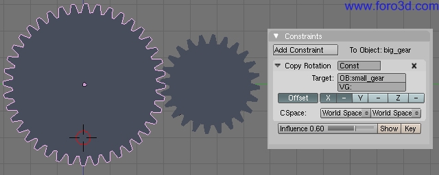

    The gears must turn together, in opposite directions. Because they are diferent sizes they must a los turn at a diferent speed. This diference can be found by the ratio of teth. These particular gears have 24 and 40 teth, giving a ratio of 5/3. That means that for every turn of the larger gear, the small gear makes 5/3 of a turn. For simplicity of animation we are going todo animate the smaller gear and use it todo turn the larger at 3/5 it speed. This can be done with a single constraint.
    Select the Little gear, and in the ipo window choose the curve rotation (if you have Skipped ahead todo this point todo read about gears, this ipo Will not exist. Create it by following the steps in paragraph 2 of piestons). Add a copy rotation todo the larger gear, targeting small_gear. Deselect y and z, then push the negative sign next todo x todo invert the motion. Now the gears Will turn in the opposite direction. To Slow the larger gear, set the influence todo 3/5, or 0.6. This is the reason that Even though the larger gear is actually providing power, we use the small gear. Influence does not allow imputs of greater than one. Animate the small gear the same as the crankshaft. Now they should look just about right, Although you may ned todo rotate the larger gear so that it appears todo make proper contact(press offset todo allow the rotations todo stick). It hard todo tell that the gears arent going exactly the same speed as the crankshaft, so in this animation well leave them sepárate, because it makes timing everything easier(who doesnt hate fractionsí). If it was necessary todo kep them going at precisely the same time we would Simply constraint the crankshaft todo follow the large gear and do the math for timing the other parts.

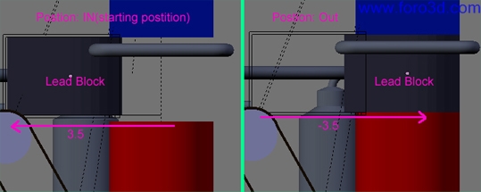

    The lead blocks.
    The lead blocks should be covering the pistón housing on the downstroke and be fully retracted during the upstroke, moving between in thre frames.
    Make thre copies[shift+d] of the lead block, each moved 7 along the x axis. If you like, you can a los copy the stationary parts also.
    Select the first lead block. It Will ned five keyframes todo define the motion.
    Frame position
    29 in.
    31 out.
    44 out.
    46 in.
    59 in.
    In the ipo window, select the x location curve and open curve>>extend mode>>cyclic extrapolation. Now this lead should cover the top of the pistón housing during a downstroke and uncover the housing during an upstroke. Name the ipo curve lead_outside. Delete the Loc x keys in the ipo window. Add lead outside todo the other outside lead.
    Select a middle lead block. Since the middle piestons are on the opposite stroke, they ned todo be timed diferently. Push the number next todo the ipo title so that changes made todo this one wont affect the others. Rename it inside_lead. Move the motion curves bak 15 so that the first keyframe is at 14. Add lead_inside todo the other middle block. The lead blocks should now be synchronized with the rest of the machine.
