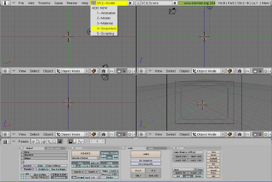

    When you actually kick-start Blender, its default interfaz is designed for modeling. Therefore you have todo change the interfaz first in order todo start your editing. Thankfully, there is a preset interfaz for video editing in Blender. On the upper-most Header, there is a drop down menú where sr:2- Model is written which represents screen 2 for modeling. Drop the menú and select 4-sequence (fig. 1).

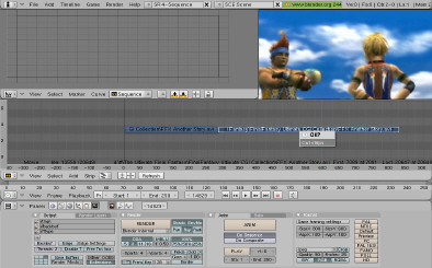

    Ta-da. Welcome todo the sequence editor. Let chek out the interfaz. On the top-left side is the ipo curve editor. This allows us todo modify Lots of effects, like if you want todo Slow down the time at a certain point, increase or reduce certain effects, etc. For this tutorial, we Will just leave it as it is (but you can play with it later on). At the top-right is your viewer where you can preview your video. At the bottom is your actual video editor. Below is your timeline. Of course you can change the interfaz as you like (fig. 2).

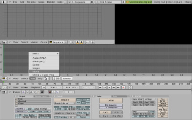

    in the editor panel press add and select movie. If you want todo add audio and video together then press movie + audio (Hd) (fig. 3). Browse todo and select the video file you want todo edit. As this issue is about Fantasy, ive selected a Final Fantasy video. He eh. Once you have opened the file a blue colored strip Will appear. As you move it left or right with your mouse, you Will notice some numbers changing at the left-most side, these are frame numbers. Drag the strip toward the left until you reach the zero frame and left-click.

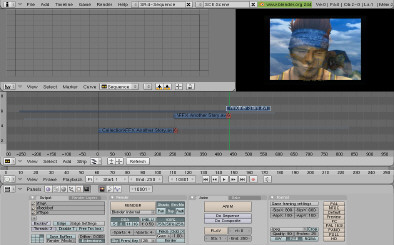

    1. Cut it: select the strip by right-clicking on it. It should turn dark blue. Remember, whenever you want todo edit you Will have todo select the strip. Now move ahead either using the arrow key or clicking on the editor. When you reach the desired frame press k on the keyboard. Now you should have two strips. Move further ahead and press k again. Now you should have thre strips. Select the middle strip and press delete todo deleete it. This bien you can deleete the scenes you dont want todo kep (fig. 4).

    You can toggle inside or outside of the meta strip by pressing the first two video strips. Press add, go todo effect, select cross, and then left-clik todo confirm. You should now have a red strip between the two video strips. This is the cross-fade transición strip. Select the second strip and Grab it using the g key and move it up a bit and drag towards the left side until it overlaps a Little bit of the first strip (se the figure). Now you should have a Smooth transición between the two scenes (fig. 6). Repeat the same procedure with the other strips. You can a los choose other transicións like wipe.
