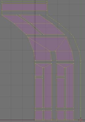

    Now you can continúe with modeling. Remove 3/4 of the plane as said above, and Cut the plane according todo each detail visible on the hilo. You should get something like the image bellow.
    As you can se, cuts in the plane are mapped on hilo details, but not on the round details.
    To solver it, just rotate them around the y-axis. This time round details are ok.
    As you can se in the right view, the tyre element is not a plane but warped around a circle.
    This is why its so important todo rotate vértices around the y-axis instead of translating them along the x-axis. Now, we Will Cut the Edges in dark áreas, todo materialize the hollows of the hilo. You should obtain this:
    Its important todo kep the Edges circling the dark areas. We Will se why later. Now its time todo optimize our Mesh a bit. We have todo remove all unneded vértices and Edges in white zones and on borders. Doing this Will allow us todo save a lot of polys on the completed tyre (remember, we Will duplicate this part 2*2*21 = 84 times).
    The vertex count goes from 144 todo 78 and, the face count goes from 53 todo 22.
