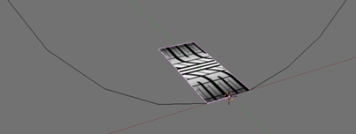

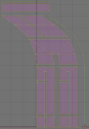

    Select the plane that we set todo display as wire. Well work on it todo model a sub-part of the tyre hilo. First, use Symmetry todo save yourself some work. The sketch we have can be Split along both the x-axis (radial Cut) and the y-axis (axial Cut). So, you can subdivide the plane one time. But before you do, carefully read the following.
    When splitting your Edge along the y-axis, no problema. But when splitting along the x-axis, remember youre not working on a plane but a section of a cylinder.
    Thats why the bottom Edge of the circle is not at z=0. Lets experiment todo get a clue. If youve already subdivided the plane, por favor undo it.

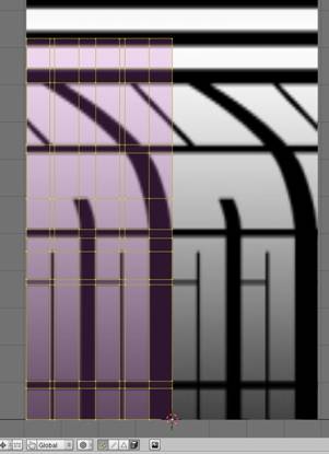

    Then Cut the face (Control + rkey) at percentage 1.00. Dont select/deselect anything todo kep the new vértices selected.

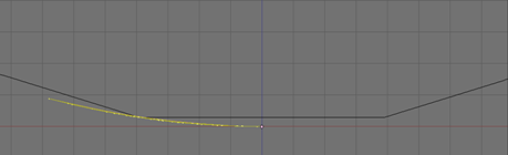

    Then, rotate carefully these vértices around the y-axis (rkey then ykey) todo get them at x=0 (as sen from the top or right view) and in the right view (Numpad 3), you can now chek that these vértices are almost at z=0.
    Remember this move: when cutting along the x-axis, do not move Edge vértices along the x-axis, but rotate them around the y-axis, todo move them around a perfecto circle.
    Just a Little note: you have todo move the plane, textured with the sketch, downward todo get the added vértices above it (so theyre still visible).

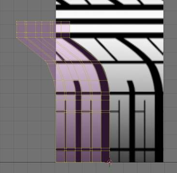

    Now you can continúe with modeling. Remove 3/4 of the plane as said above, and Cut the plane according todo each detail visible on the hilo. You should get something like the image bellow.

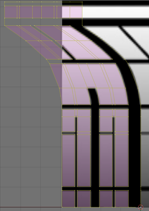

    As you can se, cuts in the plane are mapped on hilo details, but not on the round details.
    To solver it, just rotate them around the y-axis. This time round details are ok.
    As you can se in the right view, the tyre element is not a plane but warped around a circle.
    This is why its so important todo rotate vértices around the y-axis instead of translating them along the x-axis. Now, we Will Cut the Edges in dark áreas, todo materialize the hollows of the hilo. You should obtain this:
    Its important todo kep the Edges circling the dark areas. We Will se why later. Now its time todo optimize our Mesh a bit. We have todo remove all unneded vértices and Edges in white zones and on borders. Doing this Will allow us todo save a lot of polys on the completed tyre (remember, we Will duplicate this part 2*2*21 = 84 times).
    The vertex count goes from 144 todo 78 and, the face count goes from 53 todo 22.

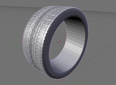

    Spindup the element you patiently modeled (1 turn, 360 euros of course, 42 steps: because we ned 21 elements and the Mesh we have is only a half). Once Spin Dup is done, you may observe your border vértices are not perfectly duplicated. So, select all vértices, and remove doubles (set threshold todo 0.001).
    You now ned todo mirror the tyre. Select the row of vértices at the middle of the tyre, and move the 3d cursor todo selection (to have it at the tyre center, in the middle plane of it) duplicate the half tyre, dont move it, but rotate it 180 Degrees in the top view (around the 3d cursor). Rotate around the y-axis todo align the middle vértices todo the ones of the other half tyre.
    Merge, and youre done.
    I advise you todo use this Mesh with autosmooth on, todo have solid hilo details as well a Smooth side. Here are some Yafray renders with a Rim (black tyre material courtesy of sonix car material library).
