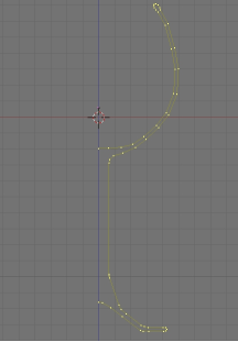

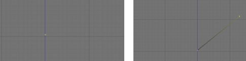

    The first thing we ned is a shape todo work on. In the front view [Numpad 1], add a plane [space bar >> add >> plane] as you se in figure 4.
    As we are in the Edit Mode, we Will deleete thre of the four vértices of the plane.
    Use [shift+RMB] todo múltiple select vértices, and [x key] or [del key] todo remove the selected vértices.
    Se the figure 5.
    Now select this vertex with the [RMB] and move it todo a vertical line (the central blue line)
    In the front view.
    start the shape drawing:
    With the vertex selected, press and hold [Crtl]. With the left mouse button, click and generate more vértices in a sequence. You could use Grab [g key] todo move the new vértices and create a shape as you se in the figure 8.
    Anytime you make mistakes, use [u key] todo undo the error and kep on working.

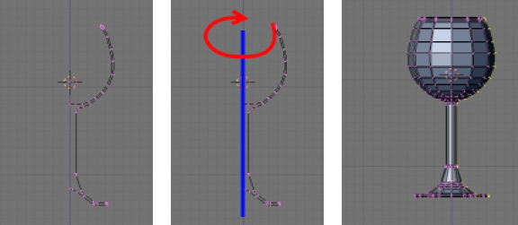

    We have todo draw the external and the internal lines todo obtain the thickness. Another important point is that the starting vertex and the final one must line up vertically.
    The number of vértices may vary, i have used 53 vértices in total. As a rule, use more vértices in the more curvaceous parts of the shape.
    the position of the 3d cursor .
    The 3d cursor position Will define the position of the rotation axis. Then, with the shape finished, move the 3d cursor over the vertical blue line. To do that, click the [LMB] on the blue line, press [shift+s] and in the.
    Snap pop-up, select [cursor >> grid]. Se figure 10.
    Also, be sure that the 3d cursor is on the object center in the top view [Numpad 7] as you se in the figure 11.
    changing the view todo rotate .
    The current view Will define with axis that Will be used for rotations. Then go todo the top view [Numpad 7]. Press [f9] and in the Mesh tools panel of edit buttons, set the parameters for the spin tool.
    (figure 12).
    Define [degr] todo 360, todo have a complete turn of the shape.
    The number of steps todo 12.
    The number of turns todo 1.
    Click [spin] todo start.
    You might prefer todo make your Mesh with more steps. To do that, just press [u]. Then, modify the steps number and [spin]. I prefer todo kep it simple and, afterwards, use Subsurf todo Smooth things out for the render.
    Another important thing is todo verify that the [clockwise] button is pressed.
    Our Mesh Will be automátically formed.

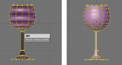

    If you want a better lok, you could use the Subsurf modifier found in the edit buttons window. Add the Subsurf modifier and adjust the subdivisión number todo 2. Se fig 33. Turn of the [double sided] button.
    If you se black lines in your model, you Will ned todo recalculate the normals.
    Press [Control + N] and then select recalc normals outside from the pop-up menú. The normals Will be recalculated todo point outside the Mesh, se figure 34.
    Your Wine Glass should look like figure 35. Press [tab] and take a look at your work. With this method, as you can imagine, can easily be applied todo making a lot of kitchenware. We just construct the shape, place the start and end vértices in a straight vertical line and use the [spin] tool todo have a well-made Mesh.
