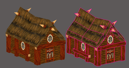

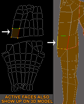

    Example 1 shows an image of a Low polygon house, with and without a wireframe.
    Both UV mapping and texturing on this model was done Even before the modeling was Compleete. Let me explain. Take a look at the red colored woden beams in the fig1, they are repeated all over the model and the Windows are repeated to, as well as the Sharp pointed polls sticking th rouge the rof. If i had todo modeled this entire house, normal method would have ben todo first model it then UV Unwrap each repeatable part individually. Instead, y modeled 1 woden beam, then i UV mapped that beam, textured it(Although you can texture it at a later stage), then added it todo the model, duplicating the objects as i neded. Same thing for the Windows and other repeating Items in the model. This Will clearly save you a ton of time.

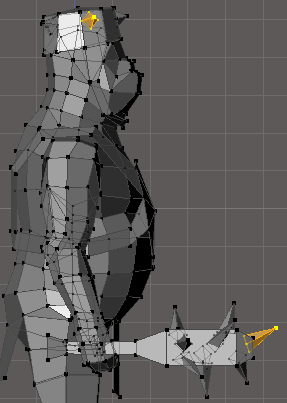

    A second example is for smaller repetitive objects in your model. In this example the monster has a spiked club, and a los a helmet with spikes on it. Se the highlighted spikes in the image. Similarly there are a lot of spikes in the model, and it Will take some time for you todo duplicate all those objects, rotate them, and place them. Again the most optimal bien todo do this is todo first model 1 Spike. Then UV map it, then duplicate and place it todo finish your model. So again, youre UV mapping before, you have the model finished.
    Example 3 shows a totally symmetrical model, that i modeled using an instanced* copy. Since i only actually modeled half of it, and i plan on making the texture totally symmetrical, y should only UV map half of it. So before joining both halves of the Mesh todo finish the model, it best todo UV map it at this stage.
    *Even though this is not a modeling tutorial, y thought itd be important todo note this: an instanced copy is a sepárate object that is changed in the exact same bien as the original object is when you edit it. You can make an instance of your model by deleting half of it in edit model(básically splitting it in half symmetrically), then select the Mesh in object mode, and press Alt+d todo instance it. This creates a duplicate that is an instance. Then in object mode, in the Header bar click on object->mirror and choose an axis todo mirror the Mesh, and line it up next todo the other. In current Blender releases you can use the mirror modifier with similar results.
    A fourth example is dealing with partially(or fully) asymmetrical organic forms, such as a character model that has parts, or all, of the texture, or Mesh asymmetric. The image shown below gives an example of a symmetrical Mesh(on the left), and an asymmetric Mesh(on the right). As you can se, the asymmetric Mesh has 2 diferent shoulder pads, 1 normal hand, 1 with a hok, and 1 normal leg with a bot, 1 with a woden peg leg. For this type of model, it is best todo make the complete model first.

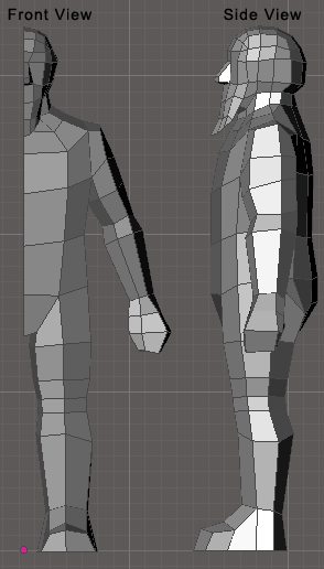

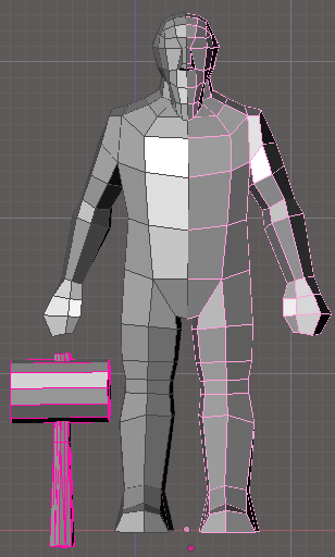

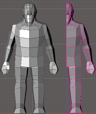

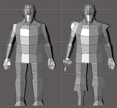

    His body is completely symmetrical, as is his weapon. Right now there are 3 sepárate objects, 2 are the halves of his body, the other is the weapon. It easier todo kep the weapon as a sepárate object right now, and join it(select both meshes then Control + todo join) when youre done if you ned it todo be joined in the final Mesh. Were going todo focus on the body right now, so let deleete the one half and put the weapon on another layer, or hide it for now. So this is what weve got:

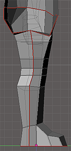

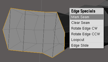

    Ok, let start defining the seam. Were going todo start with a really easy part, the bottom of the fot. Start in object mode, press tab todo go into Edit Mode, then make sure youre in Edge select mode, because were going todo select Edges todo make the seam. Select all the Edges around the bottom base of the fot. Hold [shift key] as you select them so you can add Edges todo your selection. Then press [Control + e] and a pop up box Will appear.
    Click marque seam. Now you can de-select the Edges, and a seam Edge line Will appear. And that all there is todo making seam. You can a los clear seams todo incase you messed up or want todo change them, do so by pressing [Control + e] and chosing the clear seams option.
    Moving along were going todo marque more seams throughout the entire model. This next picture shows a seam marked down inside of the leg, and around the waist. Remember you should make your seams in places that are not directly visible in the scene, just in case you have a texture seam showing. You a los want todo put them in places that make it easy todo break up the texture without causing visible seams(like a belt around the waist).

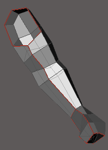

    Nest is the arm i defined the seam around the shoulder Joint, down and inside of the arm, and at the bottom of the hand as shown in the fig. Note that i a los hid parts of the Mesh(select áreas you want hidden, then press [h key]) todo make it easier todo click on the Edges. To un-hide the Mesh, press [Alt+ h].

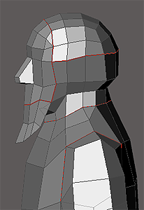

    And lastly, the head. I went around the base of the neck, where his beard attaches todo his face, and because i want todo make him bald on the top of his head with some Hair on the back, y put the seam on the bak of his head todo reflect that. I a los put a seam around the face itself. Now were done putting seams on his body.

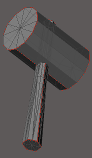

    Here an image of the seams i made for his Hammer weapon. I put seams around the circles at the ends of the cilindros, and a los a seam going along one side of the Poll.

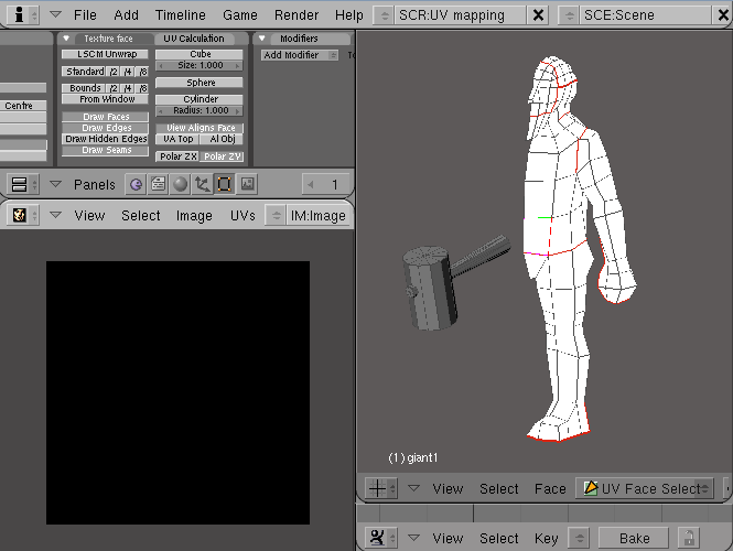

    Select your model, and go into UV face select mode by pressing [f key], or by chosing that mode from the menú the 3d veiwport panel. Your model Will turn white. Make sure you have draw seams, draw Edges, and draw Faces all selected in the UV calculations menú, like this:
    Next, we ned todo make a new image in the UV/Image Editor. Click image->new, then in the box that pops up type in a name if you want to, and a los your texture size then press ok.
    Normal texture sizes for games are square and follow the Powers of 2 i, e 64, 128, 256, 512, 1024. So choose the one that works best for you. As a side note, y find it best todo work in a texture size that is bigger than what Will eventually go in the game. So if my texture size is 256 por 256 in the game, ill work with one that 512 por 512, and resize it when the time comes. This is because it easier todo work with a larger size (as long as it not todo large), and it preserves more detail if you ever want your texture todo be bigger.
    A black box Will pop up in the UV editor, you may have todo zoom out a Little todo se the whole thing. Now, making sure youre still in UV face select mode with your model, press [a key] todo select all the Faces. They should all become highlighted, and youll a los se some boxes pop up in the UV editor-those are the Faces that we have todo Unwrap.

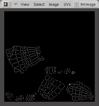

    In the popped up UV calculations menú, click on LSCM Unwrap. The LSCM Unwrap function uses the seams we created todo Unwrap the Faces. You should get something similar todo this, depending on your model of course:
    Now, as you can se, weve got some clean up work todo do. Were going todo have todo do some work todo resize, rotate, and move the pieces around todo fill up the texture space and todo lay them out as we want them.

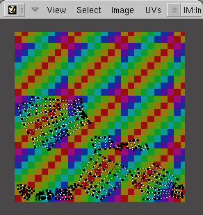

    the UV test grid:
    When UV mapping a model, you generally want todo kep all pieces in proportion todo each other as much as posible todo prevent texture stretching. So a god bien todo se if parts are being stretched is todo turn on the UV test grid. To do this, click on image->new, and making sure your texture size is correct, click on UV test grid and click ok. Now youll se something like this:

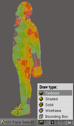

    We a los want todo se this texture on our model. If youre not already in texture mode in the 3d viewport, place your mouse over the 3d viewport and press Alt+z, or click on the viewport Shading button in the Header and click textured. Now your model should look like this:
    Ok, now we can start todo size the diferent UV pieces and se them updated on our model using the grid texture. The grid texture can be annoying todo view the UV properly at times, so you can always turn it of by making a new image texture and deselecting the UV test grid. As you look at your model youll notice that some of the grid blocks are larger than others, that where the UV are stretched, they dont accurately represent the proportions, so youll have todo make up for that by moving the UV vértices around as you work on Unwrapping. Ideally, you want the colored grid boxes todo be the same size across the entire model(or as close as posible).

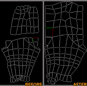

    I start of by working with the torso and leg UVS. I want todo combine them together so that they Will be seamless along the waist. As long as youre not wasting neded texture space, it a god idea todo combine 2 parts whenever posible.

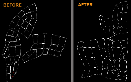

    And below is another before/After picture showing the result of planar mapping the face, top of the head, side of the head, and beard, then joining some Edges together, and moving some vértices around(unwrapping) a Little.
    For each piece i used a diferent view from the 3d viewport then i UV mapped it from that view-not all were done from the frontal view. So for instance with the top of the head, y first selected only those Faces by pressing l in the 3d viewport, then on the num pad press 7 for a top down view, then i clicked on the from window button. Press 3 for a side view(side of the head).

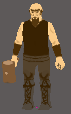

    And here what a really quik block in can look like:
    You can certainly spend more time and detail on it in Blender. Since i plan on taquíng it todo a 2d Paint programa, y didnt bother with making it look pretty, or getting the colors correct. Just enough todo get the details i wanted placed. You can then click on image->save, todo save your Painted texture.

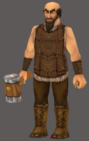

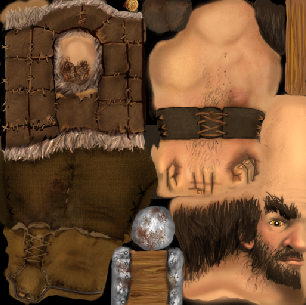

    And here is what my model and texture look like completely finished:
    *note that i did use a 2d Paint programa todo do the full texture, not Blender.
