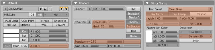

    3. In the 3d window select [RMB] the default Cube. Go todo the material buttons [f8]. The Raytracing panel introduces for available Yafray features. We Will be making a clear Glass using default settings for Glass in material panel. Select clear Glass from the drop down menú. Set the remainder of your material settings todo fig. 1. You might want todo bevel the edged of the Mesh. For this object i used subdivide multi 3x and then added a 0.100 bevel 2x and then applied set smooth. A basic bevel would work just as well.
    [fig. 1].

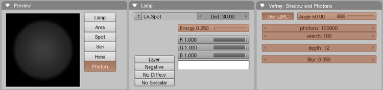

    6. Duplicate [shift+d] the área light then cancel [RMB] the auto-Grab function. This Will place the duplicated área light at the exact location of the original área light. In the material/Lamp buttons change the Lamp type todo Photon Lamp. In Blender only bien todo generates Caustics in the scene is using this Lamp. Change the Photon settings as in fig. 2.
    [fig. 2].

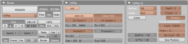

    7. Now switch over todo render buttons [f10] and change these settings as shown in fig. 3.
    [fig. 3].

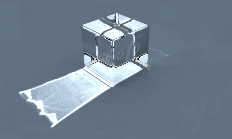

    8. Render [f12] the scene.
    [fig. 4].
    Your results should be similar todo fig. 4. If your render doesnt match it try todo match closely the settings as given earlier in the figures. For you r help you can a los look at the example Caustics, blend file if you cant figure it out.

    The first one is the Yafray panel itself. This panel allows you todo control the Yafray renderer settings. Normally it god enough todo just disable xml so that you can se the interactive rendering. Alos you can leave auto-a enabled todo let Yafray automátically control the anti aliasing option. For detailed control of Caustics you Will have todo switch todo manual anti aliasing setting though.
    The second panel is the Yafray GI panel. Gi stands for global illumination. Global illumination is the effect that light is being emitted from a global light source. For this experiment we used the full type GI and set the quality todo high for better results. The other settings and are depth and cdepth. Depth is the distance that Yafray calculates a single ray during Raytracing. The smaller the value the quicker but less accurate the Raytracing Will be. Cdepth is similar but it is for Caustics Photons in the scene. Again the smaller the value the quicker but less accurate the Caustics in the scene Will be. We a los enabled Photons in this panel. This Will enable GI Photons which are a los referred todo as helper Photons. They then are emitted from all of the lights in the scene. The more Photons (we used 100,000) better the results, but this Will a los exponentially increase the rendering time.
    The last panel is the Lamp panel[f5]. This is located in the material/Lamp buttons. You Will ned todo select the Photon Lamp in the scene todo se the Yafray shadow and Photon tab. By enabling Photon Lamp we enable the use of Photons for the Caustics from a direct source. Here the power setting is like any other light and tells how bright the Caustics Will be. This Photon Lamp allow us todo direct the direction of caustic and optimize the Caustics results nicely. We used about 100,000 Photons here. For some complex scene it can go all the bien up to a million. It just depends on how much computation you want todo do. You can experiment with the other settings as they usually require some testing but default settings Will usually achieve god results regardless.
