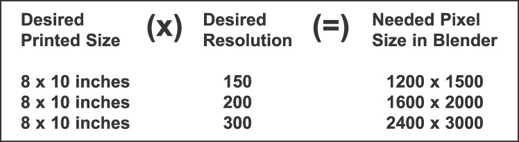

    This may sem overly complicated, but really it is not. There is a very simple formula you can use todo get the proper settings. Basically you multiply the desired resolution by the desired Physical size todo get the píxel settings/size you ned for Blender (fig. 2).

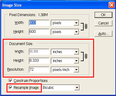

    Once you have rendered your image using those settings, you ned todo go into your favorite image programa and resize your image. Most image programas work similarly, so figuring it out in your programa shouldnt be dificult. I Will be using Photoshop todo explain this part, because that is what i have.
    Step 1: open your image.
    Step 2: go todo image>image size, a dialog box like fig. 3 should open, step 3: at the bottom of the box, unchek Resample image
    Step 4: next locate the resolution box, enter your new resolution. The width and.
    Height boxes should automátically update todo reflect the new size at that resolution, step 5: hit the ok button and save, you are all done and now your image Will print like you expected it todo.
