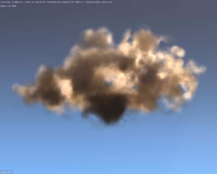

    So, y have switched one more time from Raytraced lamps todo shadow buffer lamps, using this time s. I got almost immediately, not perfecto but encouraging results.
    After some more hours spent at testing one by one all the parameters of s and adjusting accordingly the material setup and the lamps setup, y have got the result visible on the following image.
    This image is in PAL resolution : 720 por 576, rendered with s at osa 16. It has ben rendered in 01:16:72 on a Quad Core computer at 3ghz.
    A Single Frame of the previous animation rendered at same resolution and osa 5 with Raytracing tok between 8 and 10 minutes for a less natural result.
    The dark parts of the clouds are not done using textures. They are the actual result of light passing th rouge the cloud. As shadows are the dificult part, y have set them a bit strong todo show the effect.
    The material i have made uses Phong and oren nayar shader. The roughness parameter is useful todo help catching the light, and can be used todo darken or lighten the shadows.

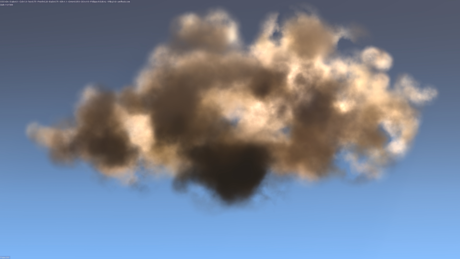

    The very god news is that the same frame in Hd resolution (1920 por 1080) takes 07:48:36 todo render. This means that the render time for a Hd image with this method is lower than the render time for a SD image with my previous method.
    I still have todo make trials with more clouds, and se the result and rendering time, but afterdays and days of searching a god setup im rather happy of this step.
    Here are two the SD and Hd image:

    The making of the scene itself is rather simple.
