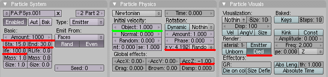

    In the top right of the panel, y have a button called <1 part 1> press the right arrow and After add new button todo add a new particle system.
    In this new system, y Will start the simulation todo 15 (the first system estop at 10) end todo 30 and make life todo 100. Make some change todo the others parameters like the first system.
    I dont set a value todo normal but use the value setting (underline in gren).
    Dont miss todo enable explode in the modifier panel todo the second particles system. sample of this Little tuts.
