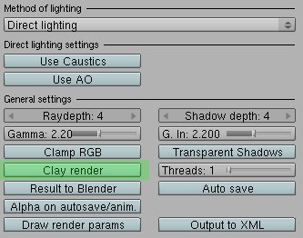

    You can enable Clay render with all the lighting methods but it often used in conjonction with Ambient Occlusion in Direct Lighting. With Yafray just press the button Clay render in the render settings.
    Clay render makes all the materiales look the same, but the properties of all the other elements (Camera, lights, environment, volume, etc) are not afected.

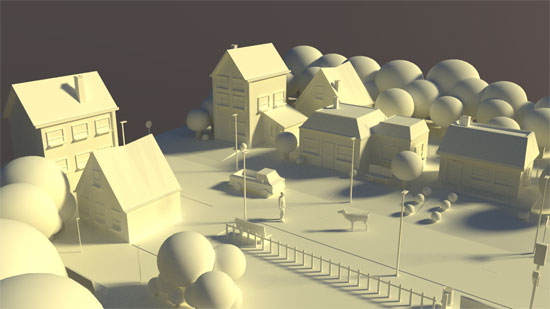

    A classical Clay render with Direct Lighting. No lamps, just Ambient Occlusion (the color is a medium grey), with a Sun Sky background. For more informacións on Ambient Occlusion chek the documentation here.
    The AO settings.

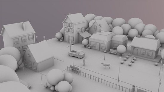

    with a simple Sun, and a colored AO you can add a diferent mod todo the picture, here a late afternon:
    The Sun here has a yellowish color, 32 samples and an angle of 5 todo have software shadows. The Ambient Occlusion is a medium grey slightly tinted in blue.
    It gives blue Colored Shadows. The Sun brings an interesting lighting, and the mod is very diferent than the first picture, but it still a Clay render.

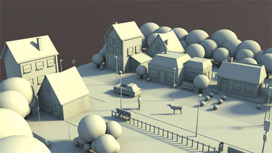

    It posible todo use a diferent method of lighting, with GI todo have subtle bouces of lights, while keping a Clay aspect. Here with Photon Mapping method (Final Gather, use background).
