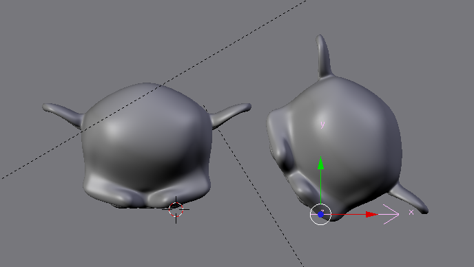

    First of all, before changing Dof-settings in the Yafray Camera-menú or the a-settings in the rendertab-menú, create an empty-object and position it where the Focal point of your scene should be, y think this is the best bien todo control the Focal-point.
    Positioning the empty-object:

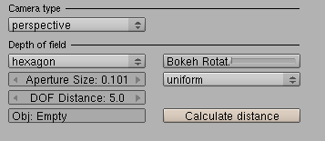

    Then you go in the Camera settings of the Yafray UI and write the name of the Empty object in the object-field and press calculate distance. Now the Focal point is calculated.
    If you change the position of your Empty object later, dont forget todo calculate the distance again.

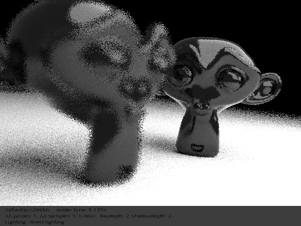

    After this, increase the Aperture size value. Values between 0-1 are ok. The higher the Aperture value is, the more Dof you get, if you want todo test the degre of Depth of Field and the focalpoint, then you go in the a-settings let the values how they are. This is the fastest bien todo preview the Focal point and Dof, here are the settings for fast previewing:
    This is the result of the above settings. Its grainy, but i think for previewing of the scene its ok.

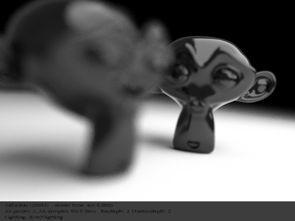

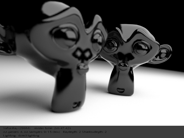

    The main factor of Dof-quality is the a-samples factor. The higher the a-samples are, the more crisp and Smooth is your Dof. Another important factor is the a-threshold value. Values about 0.020 are god for all purposes, here is the result:

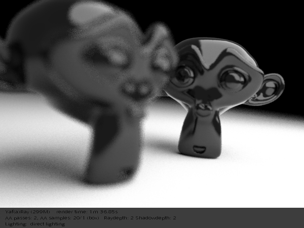

    If your apertura size is high (high grade of Depth of Field), then you ned higher a-samples. Very Low apertura sizes (dof for example 0.02) neds lower a-samples (value 8 should be enough for all circumstances), the factors a-samples and asamples inc, can additionaly help, it makes more sense todo increase the a-samples inc, instead of the a-passes value, more a-passes results in longer rendertimes. I prefer not more than 4 a-passes, the a-samples inc, does not affect more rendertime (not significantly), an example:
