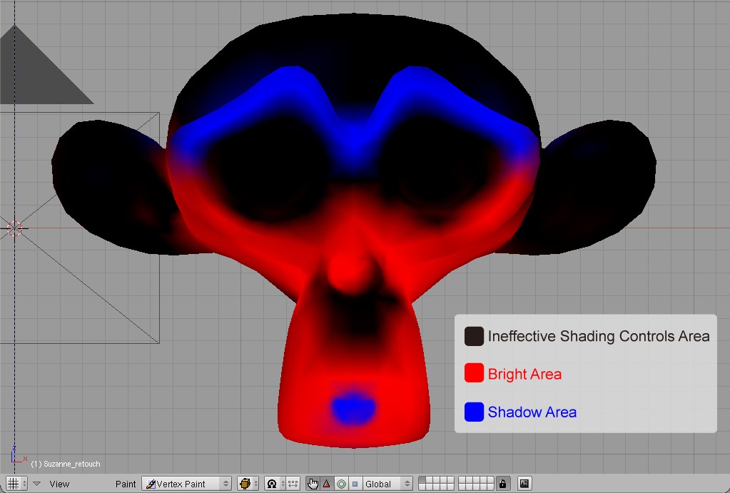

    First, Paint vertex color a Shading control área in red and blue at Vertex Paint mode. Paint a bright área in red, Paint a shadow área in blue and, Paint a inefective Shading control área in black.
    Figure.1: vertex color painting example.

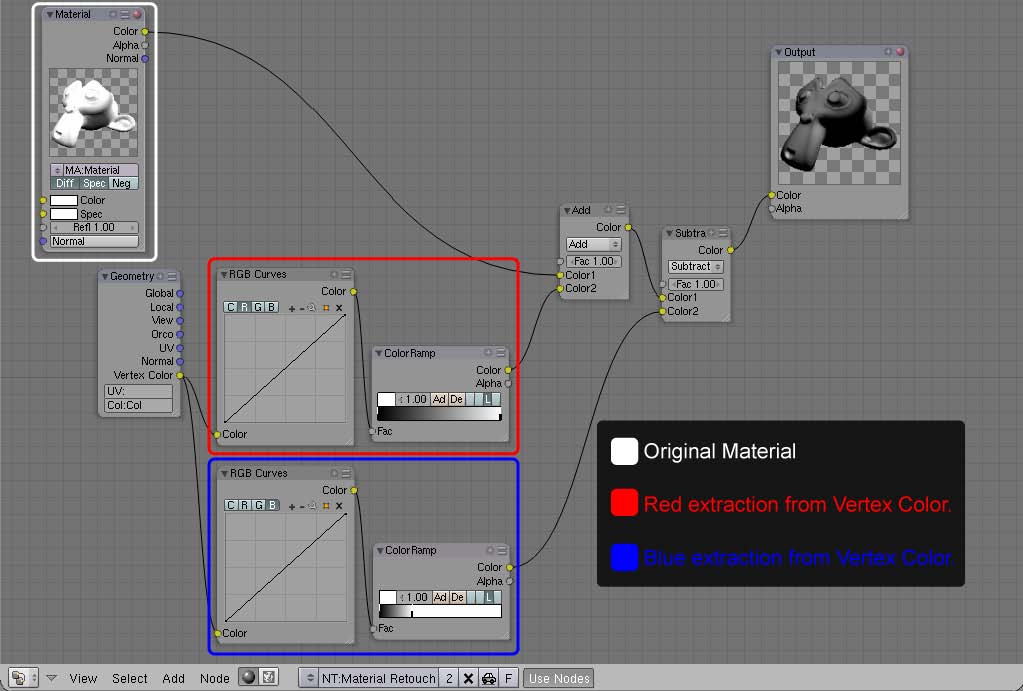

    Figure.2: material retouch material node.
    Note: method of extraction of red or blue from vertex color using rgbcurve. Extraction of red is zero in all value of green and blue at rgbcurve. Finally, rendering your scene and adjust vertex color painting and material node structure for desired images.

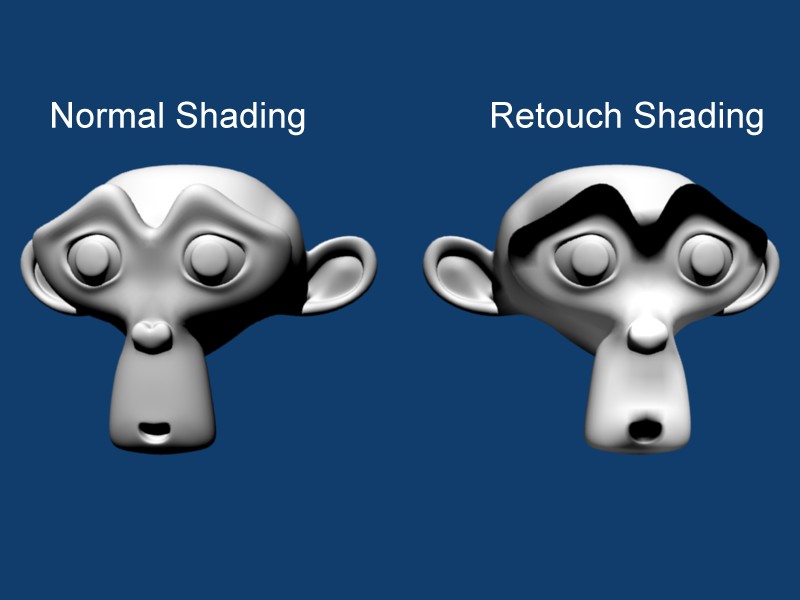

    Figure.3: left:normal Shading suzzane. Right:Concave retouch Shading suzzane.
    It from colors, because Blender 2.45 not supported Shader influence controls. Notice, material retouch is effect todo materiales only. Thus, inefective todo tracing and buffer shadows.
