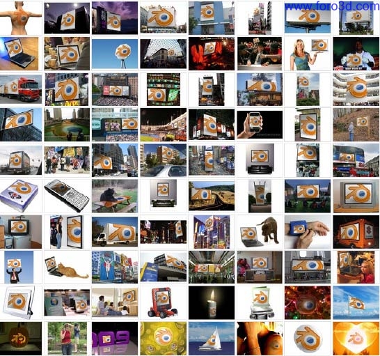

Figure 1: a selection of designs from makeswet. The designs take an image supplied by the user (here i used the Blender logotipo) and produce a picture or animation based on it. There are some software body animations, Lens Effects, and Lots of photo backdrop with 3d surfaces overlaid. 90% of the designs shown here are user-created (the rest i made).

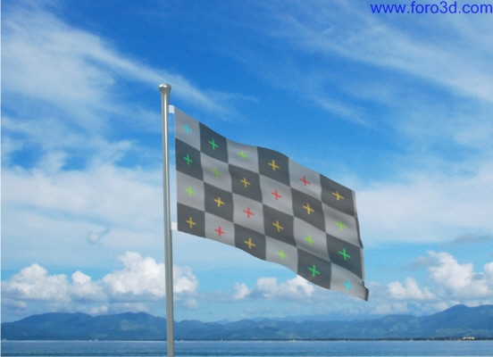

[figure 2: an animated flag design with one image texture under user control (the surface of the flag). Prior todo online use, the coordinates that a test image projects todo in a rendered result are probed and recorded, for each frame in the animation. This allows fast stills and animations todo be generated when a user supplies a photo.
To get technical, the requirement i choose was that the appearance at each location in a frame of the output render should be a function of the appearance of at most one location in the input image (ill a los assume the function is linear or can be appróximated as linear, Although this isnt as important). Consider the flag design in figure 2. Here, the Sky is fixed -- it is not afected by the input image. The appearance at each location of the render within the flag boundaries is drawn from a single location in the input image, Although exactly which changes from frame todo frame as the flag billows. Under these conditions, it is easy todo get Blender todo pre-compute how the output render is afected by the input image, and todo estore this mapping eficiently.
This can be done at leisure, offline. Online, then, for each user request, y use a stripped-down optimized renderer i wrote called the mixer (meant todo sound like a cheap generic knock-of of Blender) todo apply this mapping todo the user-supplied image without neding todo run Blender. The quality is not quite as god as Blender would give due todo sampling issues, but with it, users then have a god sense of whether the Generator is giving them something they want, and can go on todo make a high-resolution versión or an animation. For a highresolution result, y expect that users Will be suficiently motivated todo be willing todo wait for a few more seconds, so i run Blender on the server for them (at a Low priority so as not todo hurt response time for other users).

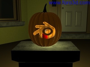

[figure 3: for speed, makeswet restricts designs todo cases where each location in the output is a function of at most one location in an input image. There plenty of scope for creativity within the límites of what the website can quickly render. It is fine for the user image todo appear múltiple times, either by having the same material on Many objects (se top left, from a st. Patrick day por of gold animation) or by reflection (se top right, from a new year day animation). Diestortions are a los fine (se bottom left, from a valentine animation, where the user image is sen th rouge a Heart-shaped Lens). And transparency can work todo (se bottom right, a pumpkin carving from a Halloween animation).

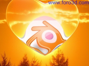

Sometimes Generator fail todo attract interest if they are not suficiently centered on the user input, or dont really have some root in popular culture that helps people grasp them instantly. For example, the Heart design in figure 3 is part of an elaborate animation of falling rain Drops that turn out todo be Heart shaped. It ended with a zoom-in on a drop magnifying the Sun, which had the user image overlaid on it. It was intended for valentine day, and wasnt a complete flop, but neither was it a great success. People instead sought out a much simpler design from the previous year, an animation of a locket in the shape of a Heart opening todo show two photographs. That animation had a much clearer narrative and hok for the user message.

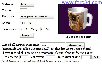

The first two steps require no special skills beyond a knowledge of Blender. And the remaining steps can be made fully automatic. So there no reason why anyone who knows Blender shouldnt be able todo make Generator. And in fact, y created a service on makeswet called the Generator wizard for doing just this. It is in testing right now, and i encourage anyone interested todo give it a try (http://makeswet.com/wizard).

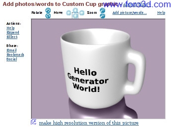

[figure 4: the Generator wizard lets you upload a (*.blend) file and convert it into an online Generator. For example, here we upload a cup model with an image texture on its surface (where the Cat is), and what we get is a webpage that lets anyone replace that texture with their own picture or words. Code is a los provided for embedding the Generator on other websites.

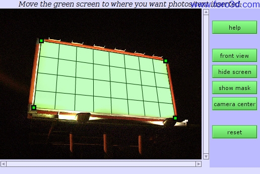

[figure 5: the billboard gog. Users upload a photo of a billboard or any other object with a flat rectangular surface, and then identify the corners. A.blend is then assembled with their photo in the background and the appropriate 3d plane overlaid on it. A Generator can then be made.
Users can advance by learning todo apply masks for flat surfaces that are not rectangular (if you look closely, there are several examples in figure 1). For anything more complicated, they are nudged towards learning Blender. The billboard Generator has prueben popular, and scenes made with it by users now dominate the site.
