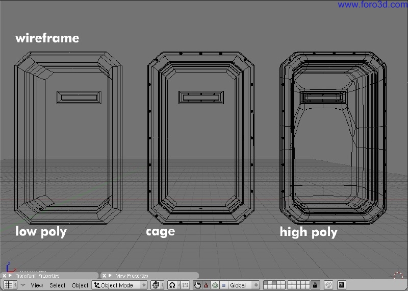

The Low poly game Mesh is the actual Mesh that Will eventually be used in game, in this instance a tech dor shown on the left of the image below marked Low poly, this should be optimised as well as posible (as few Polygons as necessary for its target use), and must be UVW mapped and textured.
The High Poly art Mesh Will be used todo provide the geometric detail that baked todo the image applied over the game Mesh. The High Poly versión of the dor is shown on the right of the image below.
Design note : a third versión of the model is often used, called the control Cage, this is optional and more todo do with work practices (#).
Figure 1: wire-frame view of the required assets, in this case a tech(ish) dorway.

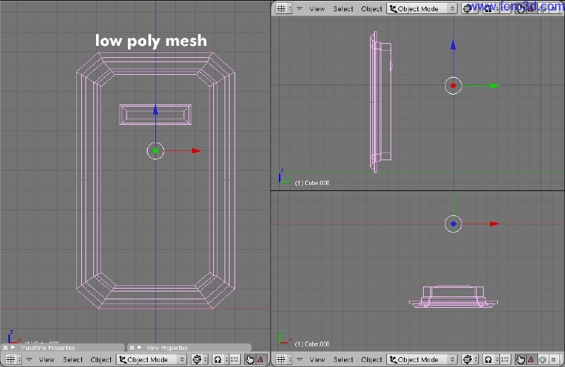

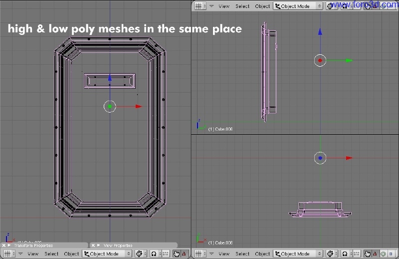

It important todo note at this point that baking Normal Maps in this bien is a like for like process, it not explicitly a projection - One object being projected onto another - But rather relies on the objects occupying the exact same co-ordinate in XYZ space. In other words, the objects have todo sit on top of each other in order for this process todo work correctly.

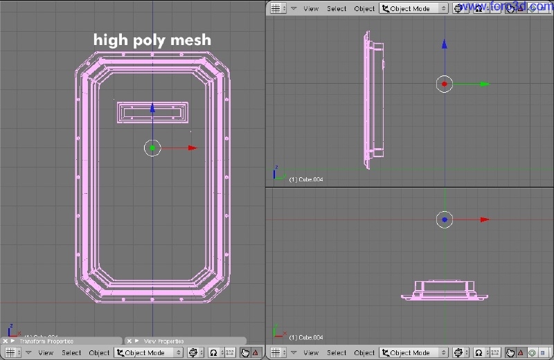

Shown below are both the high and Low poly meshes placed at the exact same XYZ co-ordinates on Blender grid. It important, at this point, todo make sure that both objects are placed exactly on top of each other - It helpful here if both objects have the same PO (point of origin - The Little Pink spot around which the cursor is usually placed when objects are selected).
How todo : precisión position control
Assuming that both objects are using the same PO, in order todo move or position them with precisión do either/or of the following.
- RMB click todo select and object and hold [Control] whilst moving, this Will Snap the object todo the grid as it moved.
And/or.
- press [n] todo open the transform properties panel, in the locx, locy and locz text Fields, enter or edit the numbers shown so that both objects use the same values, this ensures both objects are in the same place numerically.
This should put both the high and Low objects into the same place, usually confirmed by the presence of something called z-fighting - This is the flicker often sen as a result of your graphics card trying todo draw coplanar surfaces at the same time (surfaces that occupy the same surface at the same time), as it cant do that, it switches or swaps the rendering of one surface with the other as the object is moved and rendered todo the monitor screen.
Figure 3: Low poly Mesh shown relative todo the XYZ axis in Blender.
Figure 4: the High Poly Mesh shown placed at the same XYZ coordinates on Blender grid as the Low poly versión.
Figure 5: showing both the high and Low poly Mesh in the same place (low poly is selected and highlighted (Pink).

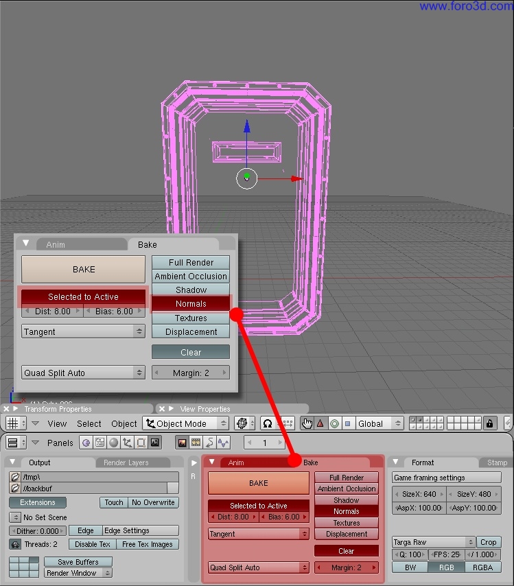

The order in which the two Mesh objects are selected is important so make sure todo do this correctly.
Rmb select the high resolution Mesh first, then hold the shift key down and RMB select the Low resolution Mesh - Of the two meshes the Low resolutions outline should be the brighter Pink when done in the correct order.
Switch todo the scene panels window, [f1, and find the panel titled bake.
- click the selected todo active as well as the normal button.
Depending on where the Normal Map is going todo be used, the drop down selection menú - Currently showing Tangent - May ned todo be changed todo the appropriate setting, for game content this is usually Tangent, select that setting if it not already active.
Additionally activate the clear button, this Will force Blender todo clear the texture before it re-bakes the Normal Map, handy if the process is run several times. Margin can a los be set which Will force a bled amount todo avoid Edge antialiasing errors (#).
Click the bake button todo render bake the Normal Map todo texture.
Figure 6: Making sure selected todo active is set so the high resolution Mesh is baked todo the Low.

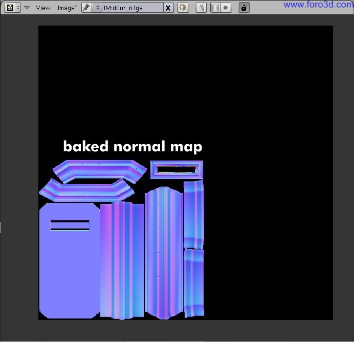

If the UV/Image editing window is open, baking Will be visible as the progressive live creation of the Normal Map as it gets baked todo the texture image - Depending on how big the image is, it shouldnt take todo long todo process. The result Will be something similar todo what shown below - The Normal Map baked todo the área mapped out by UVWS of the Low resolution Mesh, all that then neds todo be done is todo save the image. So;
How todo : save the baked Normal Map
On baking the Normal Map todo image a small * should appear appended todo the image menú text of the view Header once the process is done (it Will appear as image* instead of the default image), this indicates there is a new image being held in the render buffer, which now neds todo be saved.
- click image and select save as, a file browse window Will open.
- in the Header área of the newly opened file browse window, find the drop down menú save image [image typ, and select an image format that Will save the image either in a Raw state, or one that uses loss-less compression, suggestions are Targa Raw, bmp or tif.
- click save image todo save the file todo the chosen format.
Figure 7: the resulting baked Normal Map shown in the UV/Image edit view.
