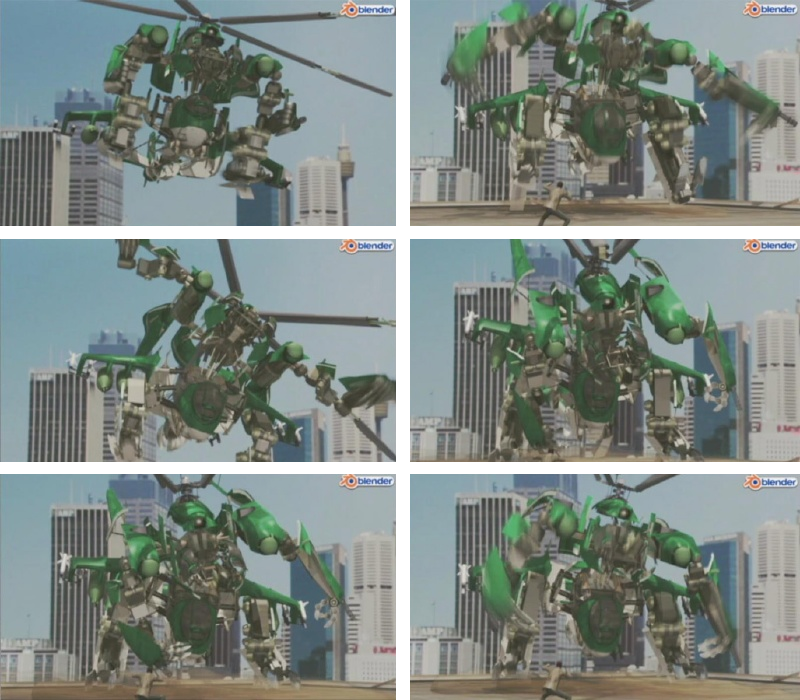

    One such requirement for a Little something extra occurred when we were making a short reel called the surprise Attack. The animated demo was intended todo be short, depicting just one awesome momento in time in a larger concept. Specifically, the momento depicts an event of unexpected danger when a semingly normal helicopter flies into view of a lone human person only for the said vehicle todo shift and change into a metallic monster that literally takes on weight and falls out of the Sky, landing on a roftop helipad and acting generally menacing.

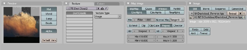

    To achieve the effect i used some old clouds texture maps i had made in my stock and UV mapped it todo a set of curved sub-surfed meshes that were modeled todo appear like Waves with their Mid sections slightly protruding outwards.

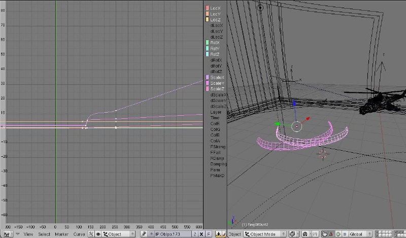

    the Mesh shape appears below.

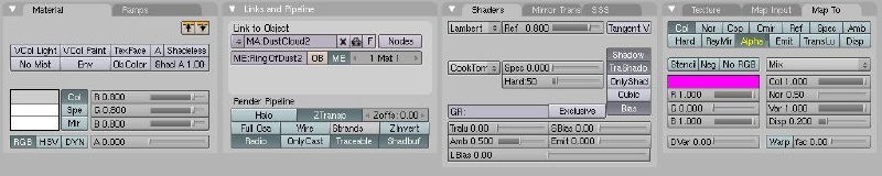

    and the materiales settings appear below.
    Once i was convinced that the dust had the right lok all that remained was todo animate the Mesh.
    By keyframing location, rotation, and scale so that the dust clouds started in very small size, grew larger and fanned out in a nice bien for the Camera.
    Finally, we tweaked the dust cloud alpha setting so that the cloud starts out totally invisible, becomes opaque, and then dissipates bak into nothingness as the Mesh fans out.
