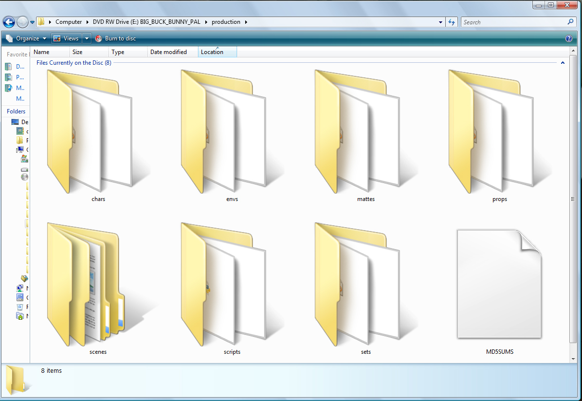

After a bit of poking around the blenderwiki, as well as peking into all the folders and files on my copy of Big Buck Bunny, y am beginning todo se some nice ideas for Project organization. Now granted, y could go about organizing things any bien i want, as long as i am consistent and can remember why i set it up that bien todo begin with. But i am looking for some pointers, and let face it, these Blender gurús generally know what they are doing.
So let take a look at how they set up their production files. When you open up the production folder, you se ha series of folders.
Nombre: Image 1.jpg
Visitas: 311
Tamaño: 267.2 KB
They have set up individual folders for characters, environments, mattes, props, scenes, scripts and sets.
This sems todo be a pretty god breakdown of all neded elements for an animation. At first i thought the scripts folder was for the story script, but it actually contains Python scripts they used throughout the production. Further poking around revealed that the storyboards and animation scripts are in diferent folders on the disc. Most likely that was done just for the DVD set up, so i would probably go ahead and create a folder in the production folder for my animation script and storyboards, just todo kep my Project all together.
