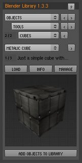

    For further control of your library, Mariano [uselessdreamer] has written an amazing Python script called Blender library, that gives you an easy bien todo estore, manage and retrieve frequently used items, such as materiales, textures, objects, etc. There is a los built in import and export options todo help share your Items with the rest of the user community. blender library
    description of Blender library script and instructions for use.
