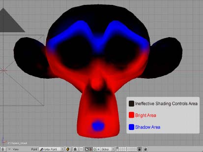

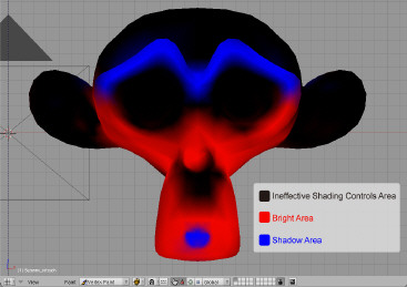

    First, while in Vertex Paint mode, we Will Paint two Shading control áreas, one in red and one in blue. Paint your bright áreas in red, Paint your shadow áreas in blue, and Paint unimportant áreas in black.

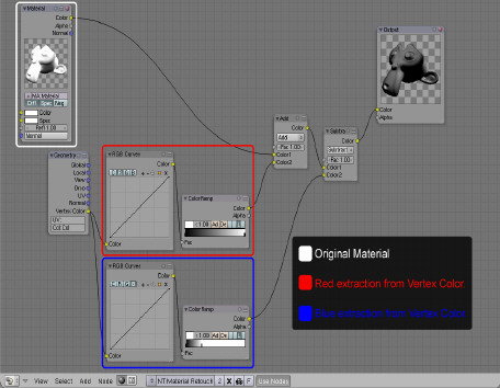

    figure 1: vertex color painting example. Second, create the following nodes from the original material as shown in the following image.
    figure 2: material retouch material node. Note: todo extract red or blue from the vertex colors you use an rgbcurve node. To extract red, you use a value of zero in the green and blue channels of the rgbcurve node. Now you can render your scene and continúe todo adjust your vertex color painting until you achieve your desired look.

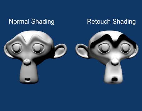

    figure 3 : left:normal Shading of Suzanne. Right:Concave retouch Shading of Suzanne. Lighting is provided by a Sun Lamp. This method is based on colors because Blender 2.45 doesnt support Shader influence controls. Notice that material retouching only afects colors, not Ray Traced or buffered shadows.
