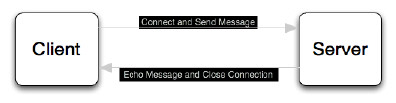

    Let take a minute todo explain a few things about networking. I could write an entire encyclopedía on computer networking, but i dont fel you ned todo know much more than the very basic of what a packet is. You dont ned todo fully understand this next part, but it included for the sake of those who may. When a computer neds todo send data todo another computer, it sends a packet of información across a Physical medium todo the receiving end. This packet is encapsulated with Header información that tells where the packet neds todo go. When the packet is sent and received, it flows th rouge a standard known as the osi model. The only thing you ned todo know about the osi model (and the TCP/IP model) is that it works. Packets are sent th rouge a service that is associated todo a port. A port is Simply a number that TCP uses todo send and receive información.
    Now that ive summarized about six months of networking school into one paragraph, take a look at this next diagram: this is a simple chart demonstrating how we Will be setting up our server and client. The client Will connect todo the server and a socket connection Will be established. The client Will send a string of data todo the server. The server Will then read the data and send it right bak todo the client and close the connection. That it. This model is known as an echo server, since it sole function is todo repeat the data bak todo the client.

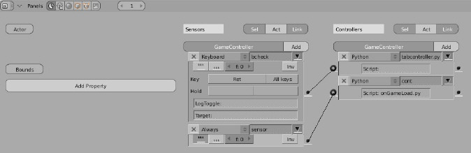

    To get some interaction with the game, were going todo ned our cursor visible. Well make a Python script that Will do this. Open up the text editor window and make a new file called ongameload, py. This Will give me ha god opportunity todo introduce you todo Python scripting, so the rest of the tutorial wont sem as intimidating.
    With Python, we can add almost limitless functionality todo our games. Logic bricks are a nice bien todo add simple functionality without knowing any code, but can become very complex when trying todo add functionality that requires more then 20 brik connections. By using Python, we can avoid sorting th rouge a web of brik connections, and extend beyond the limitations that logic bricks hold us todo. However, without logic bricks, we would have no bien todo call our Python scripts.
    Let get bak todo the ongameload, py script. We want todo make a script that Will enable the cursor todo be viewed in the game. The Python module that handles this is rasterzer. To Access the rasterizer functions, we Will first ned todo import the module into our script. After a module is imported, you Will have Access todo all of it functions. You can import the script using import [module]. To save typing, well use the as [name] option. This helps tremendously when creating very long scripts that require you todo type the module name a lot.

    Now that our script is made, we ned todo create some logic bricks that Will call them. Well assing them todo our empty, called gamecontroller. Select the Empty and pull up the logic bricks window [f4]. Add an always sensor and disable true level pulsing. Then add a Python controller. This is where we enter the name of the script todo be loaded. Connect the dots, and test out the game. You should now be able todo se your cursor in the game view.

    So lets have a look at the Heart of the networking relationship, the server. As i mentioned before, were going todo use Python sockets todo make the connection between the client and the server. Im going todo show you the TCP Python server well be using, and within the code ill break it down into understandable pieces using comentarios.

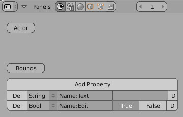

    Before we do, select each input object and create two properties. The first one being a string named text and the second one as a bol named edit. Set input1 edit property todo true, and the others todo false. This Will give us somewhere todo start.
    Im just going todo summarize the script, instead of walking you th rouge it step-by-step. We create a trigger that checks todo se if a sensor (a keyboard sensor) is positive. If it is, then we create a Python list of the 3 input objects. Then, we run an if/elif loop todo set the edit properties of the appropriate imputs according todo which conditional statement is true. Simple enough.
    Here the script. Save this as tabcontroller, py in the Blender text editor.

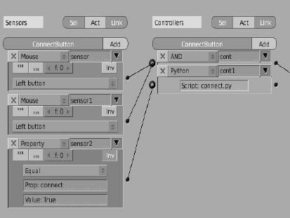

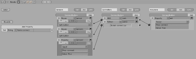

    Select the gamecontroller Empty and setup a keyboard sensor. For this exercise, y am going todo be using the return key, Simply because using the tab key actually produces @ key returns which mess up the text input. You could use the tab key if you want, but youll have todo edit the script todo remove the @ in the text object. Connect this keyboard sensor todo a Python controller, and use the tabcontroller, py file.
    Here where a few problems lie within the logic brik design. What we ned todo do is create two mouse sensors (mouse over and left button), and when they are both positive a Python script is started. At first glance you might think, well, hok them both up to a Python script controller. This isnt going todo work because each mouse sensor Will ACT independently as if it were an or condition, and the script Will run every time a left mouse button is pressed and every time you mouse over the button. We ned todo connect them todo an and controller, but now were presented with the problem of not being able todo run the script directly. Since there is no Python actuator, were going todo use the property actuator todo set a bol property, which Will trigger a property sensor that Will initialize the script. Take a look at the image below todo se how this works: onto the script. Much like the server script, im going todo show you the script well be using, and then use comentarios within the script todo explain what going on.
    # since well be using Blender Game Engine functions, # we ned todo import the Gamelogic module, import socket.
    Import Gamelogic as gl.
    # this is another problem with the logic bricks. We can initialize scripts using the.
    # Python controller, but we cant estop them when their sensor is not true. If we dont.
    # chek the property, the script Will actually run twice (on click and on release).
    # well create a loop todo test if the property is true, this bien we only run it once, conprop = gl, getcurrentcontroller(), getowner()
    If (conprop, connect == true):
    # now let get the text property values from the input objects, and assing.
    # them todo respective variables. Notice that we ned todo use the int() function.
    # for the port settings. If we dont, the variable is assigned as a string, and.
    # you Will get an error when Binding the port because it not an integer value, hostinput = gl, getcurrentscene (), getobjectlist()[obinput1"]
    Host = hostinput. Text.
    Portinput = gl, getcurrentscene (), getobjectlist()[obinput2"]
    Portstring = portinput. Text.
    Port = int(portstring)
    # as with the server, we create the socket, s = socket, socket(socket. Af_inet, socket. Sock_stream)
    # instead of listening for connections, well connect todo the server, connect((host, port))
    # well Grab the message from input3 and use the the send() function.
    # todo send it todo the server, message = gl, getcurrentscene (), getobjectlist()[obinput3"]
    Sendme = message. Text.
    S, send(sendme)
    # assing the server response todo a variable, # so we can use it later, and close the connection, data =, recv(1024)
    S, close ()
    # now we can display the echoed message in the server response.
    # text object by assigning it todo it text property, resp = gl, getcurrentscene (), getobjectlist()[obresponsevalue"]
    Resp. Text = data.
    # and finally, we reset the connect property bak todo false, conprop, connect = 0 summary.
