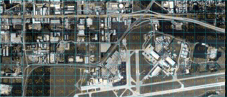

    Civil enginers a los use digitally rectified orthographic photos, which is a long term for scalable aerial photographs. Again, a profesional surveyor flies over the corridor snapping pictures with a special Camera then uses software (such as descartes) todo manipulate the aerials making them scalable. The aerials we received measured 10572 ft, by 4608 ft, at a resolution of 6 inches. Because of OpenGL limitations, y had todo Split the aerials into images measuring 512 por 512 px, which resulted in a 9x21 grid.
    An enginer draped the grid over the dtm (draping is a term similar todo Blender retopology característica, where the vértices of the grid are projected todo the dtm). This method makes the aerial photography align in the exact surveyed location on top of the dtm. I then used Blender UV/Image Editor todo map the aerial squares todo the draped image boundaries.

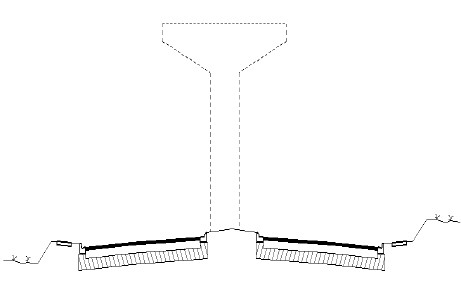

    To design a road, the enginer produces several types of elements: the horizontal alignment, the vertical alignment, typical sections, and cross sections. The horizontal alignment is a 2d curve depicting the pathway that the road, Ramp, or bridge Will follow. The vertical alignment (alos known as a profile) is similar in function except it only provides the elevation diferences. The typical section gives a general representation of what a Cut-th rouge of the road would look like, while a cross section gives an exact representation of a Cut at an exact location. A standard Project requires this for each road, Ramp, and bridge.
    I combined the horizontal and vertical alignments in micro- Station todo produce one 3d alignment and imported it into Blender. Following the same workflow as used with the dtm, y moved the data in Microstation first todo address the coordinates and saved it todo 3ds before importing. Once in Blender, y traced it using a 3d Bézier curve. I then combined some of the typical sections and cross sections todo form twenty-eight specific segments of six diferent roads, ramps, and Bridges. I imported these into Blender and traced them as curves. Finally, y extruded the typical sections along the curves todo produce the 3d models.

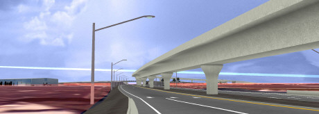

    In roadway terminology, a gore is an área of transición where two or more roads converge or diverge. Due todo elevation diferences and adherence todo design criteria, designing a gore in 3d is a challenge, especially when you want todo make it usable in Blender real-time engine. Essentially, y manually smoothed the meshes where the ramps joined the arterial roads and where the roads intersected. In retrospect, this was probably the most dificult task.

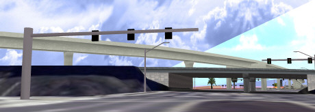

    Designing the bridge for the flyover was very simple and similar todo the roads and other ramps. I extruded the typical sections along the 3d curve todo create the superstructure and manually modeled the hammerhead piers, approaches, and abutments within Blender.

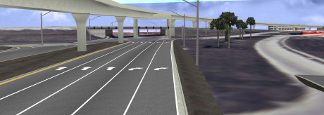

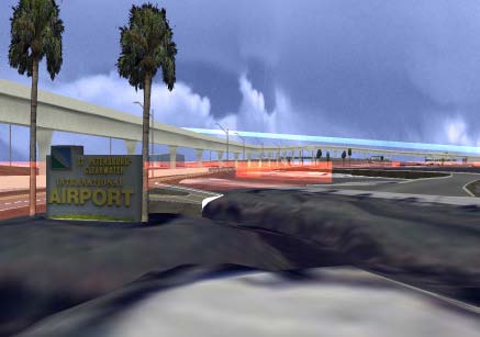

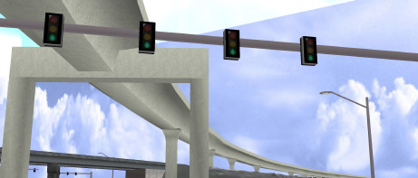

    Accessories aid in the realism of the presentation. Therefore, y modeled trafic signals, Street lamps, signs, tres, and the roadway striping. Based on photos taken within the vicinity of the Project, y tried todo model the accessories todo look similar todo what you would find in that área. For instance, the majority of the tres are palm tres, and the trafic signals are black.
    Using a billboard technique for the tres, y added alpha masks todo tree photos and uv-mapped them todo two crossing planes (forming an x) in Blender. For the roadway striping, y used a 3d curve as a Path and dupliverts todo copy a white rectangular plane todo represent the dashed stripes, and other 3d curves with a yellow or white plane extruded vía bev ob todo form the solid yellow or white lane lines.

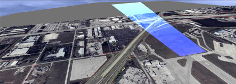

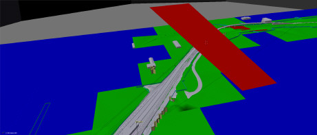

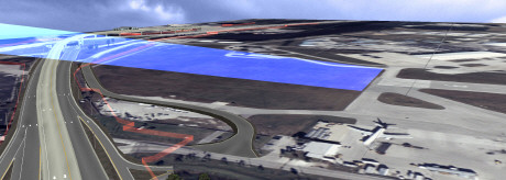

    I added a semi-transparent red fence representing the required right-of-way (property lines), and a semi-transparent blue plane representing the glide Path todo the adjacent runway.
