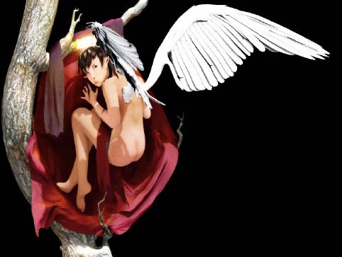

    At first the prohect name was Glass girl and i wanted it todo be fast and simple. As time went by i thought, it starting todo look god, why just leave it like this if i can model higher polygon meshes and test out my baking skills.
    Because i had already made a body in postura (not in a standard pose), it was hard todo make her very symmetric and kep god proportions of body/head parts. Before you start a new Project it helpful todo think about what you actually Will do todo avoid problems later.
    Glass girl Mesh is really crappy here butim sitll learning todo model like a pro. There not much todo tell about modeling her, as she started from a box and ended up as a ~1000 polygon Mesh, which was inflate, and Pinch todo fine tune my modeling.
    Wings
    Wings were a real challenge todo me, as i didnt know how todo start modeling them. First, y made a base Wing and used dupliverts with feathers. Next, y made a base Wing and just extruded Edges todo Mimic feathers. Unfortunately, both methods gave por results.

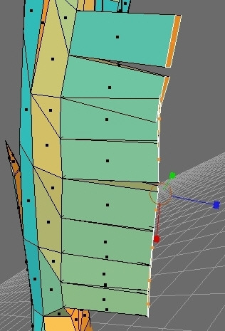

    I found a reference from Wikipedia about Bird Wings, and i started modeling todo make them manifold, or suficiently varied, and give the feathers some thickness. I knew it would be a pain todo UV map it, but in the end i used plain Unwrap and helped by adding seam Edges around feathers and at their joining with the Wing bone. To model so Many feathers, extrude the Faces individually (in Edit Mode, select all Faces and use e key - Individual Faces option) (se fig 1) start at the top of the Mesh and select enough Faces todo extrude 2-3 rows of feathers. Adding some random size, length, and rotation adjustments is a god idea.

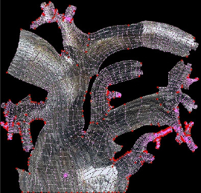

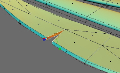

    The next step is todo detail the feathers. Select all their side Edges and subdivide them 3 or more times, depending on their length, until they start looking like in fig 2 if you want extra details on some of the feathers you can edit them this way, se fig 3.

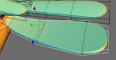

    But i got Lucky - While searching over at blenderartists, y ran across a new Cloth simulation currently in SVN and some test builds. My only complaint so that it doesnt just fall down from that tre, it neded some goals. In Edit Mode i selected only the main Faces and added them todo a vertex group. Se fig 4. Only 40 frames were neded todo make the Folds come down and give a really nice effect. After that, y just applied the deformation, and in Edit Mode adjusted the Faces of the Cloth that had jumped into tre Mesh. Thats it no more ned todo Sculpt a cloht in Blender.

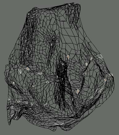

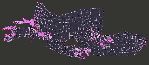

    While UV mapping the tree was a challenge, modeling was quite fast and easy. Uv mapping was dificult because i wanted the tree texture todo be top todo bottom and on branches). The real life saber here is live Unwrap, transform and Pinning vertexes. Just set up the seams correctly, select all of your Mesh Faces in UV mode (if you have the new test Blender, the UV mode tools Will be in Edit Mode), press u, and select Unwrap. Now go todo the UV edit window and select the most important vertexes of the tree as shown in here (the red dots). Se fig 5.
    It best todo use brush select (b key), because sometimes the vértices od the UV arent joined. In this case, deselecting the pinned vertexes and selecting them again Will not move the pined vertex. When moving the pinned vértices and the UV deforms, be careful - The fewer pins you add, the better. It takes time todo learn how it works, but the time is definitely worth it.
    The advantage of this method is that you can go bak todo Edit Mode and change your Edge seams on the Mesh, but Unwrapping again wont deleete your pinned vertexes. That bien you dont ned todo start all over again if you found a missing Edge seam.
    On the tree i used 2 UV maps. The first UV map is for baking, which cant overlap itself and must be inside the map border. The second map sen here in fig6 is for texture. It doesnt ned todo be in Bound of the map área as the texture of the tree is seamless.

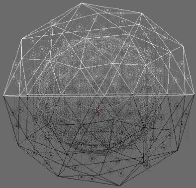

    If you want a 2 color AO, then go todo Edit Mode and select the bottom part of the iconosphere ball. Split it (p key), and if you want 1 light just leave it in once piece. In the same place as the sphere, create a spot light, set the light todo RayTrace and set samples todo 1 or 2. Next, parent the light todo the sphere. If you Split the sphere, youll ned todo duplicate the light, leave it in same place, and then parent it todo second sphere part.
    Setting colors of the lights can be as you want. I used blue and red, but if you use 1 light then white is what you want (as you can always change the color in Gimp when compositing). If the lights are parented, select the sphere or their parts and turn on duplifaces (they sem better than dupliverts). If the lights on your sphere are facing inside, youre fine. If not, se fig 7.
