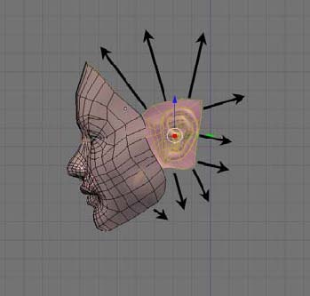

    Modeling the ears.
    Step1 people often have trouble with ears. This tutorial doesnt pretend todo be right, but todo show obvious ear structure that you have todo include in order todo make your ear fel real. Once the mains structures have ben outlined, you se the ear is pretty basic. One big lobe and some kind of a y shaped bit of cartilage. Se the fig13 for reference.
    Ear structures are underlined here and you can compare them with with ear reference in fig13a.
    Step2 extrude the lobe you shaped in step 1 and start building the y shaped bit, se the fig14.
    Step3 here is the next step. Start poly filling the ear. Note the y shaped thing, and the earhole (yes, the place where you fit you IPod earbuds).
    Step4 After a while you should have something like this:
    Step5 finish by extruding the outer Edge of the ear. Subdivide. From there we Will work up to the head.
    Finishing the ear. When you are done, radiate from the ear todo model the rest of the head (face not included).

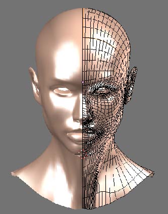

    Finishing the head.
    And voilá.
    Now you have a face that is presenting desirable features like : relatively Low poly count but enough poly density where it is neded.
    If you ned todo build a higher resolution Mesh, this face is easy todo modify and work with.
    For the specific case of the extinction level event Project, a higher resolution face was required in order todo add finer facial features (Dixit Jeremy ray).
    No sweat. Using multires and tweak with Sculpt tool, this is what you can do.
    Notice that this Mesh has twice the poly count compared todo the previous head. But, due todo its correct topology, (i, e. - The right polys at the right places), reworking the Mesh with the Sculpt tool is a walk in the park.
