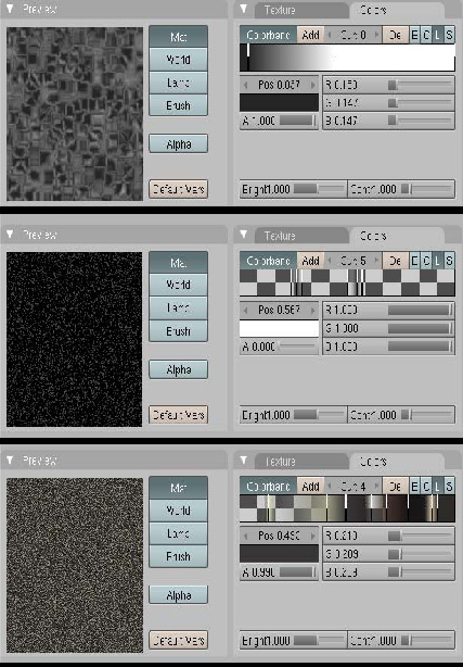

    Texturing and materiales have ben a big problem for xtin Project. While xtin Project has had no problema finding modelers, nobody wants todo texture. Since im the only texture artista, ive fallen bak on using procedurals as much as posible.
    The big problem with procedurals is the lak of Area-specific detailing, such as Dirt gathered into corners or worn Edges on paneling.
    I found the solution todo this problem is todo use a mask for additional layers of Dirt procedurals. Uv mapping is usually time consuming, but in this case it wasnt necessary todo eliminate all the texture stretching. All the visible Dirt detail comes from the procedurals, which dont stretch Even though the mask controlling where they appear may be stretched and diestorted. I used Unwrap (smart projections) todo quickly generate UV coordinates for my gunboat sections.

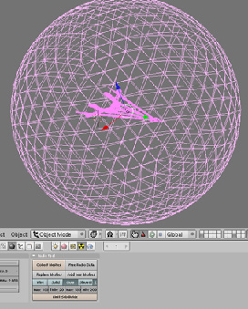

    To automátically generate my Dirt masks, y put each section into a Spherical emitter and gave it a quik Ambient Occlusion pass. It isnt necessary todo let the full calculation run, a few seconds Will do the job.
    Under the Ambient Occlusion tab, select both. This should give more contrast todo the mask.
    With a new image applied todo the object, (in the UV/Image Editor), y used the bake options in the render section todo extract the AO información todo texture.

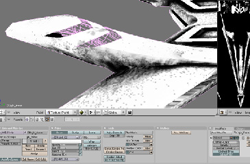

    This is just the beginning - There not enough contrast. The next step is todo take the AO texture into Adobe Photoshop/ Gimp, increase the contrast and enhance the shadow/Dirt áreas. This is a slightly involved process which could use its own tutorial.
    The last step was todo use Texture Paint for a final editing of the AO texture, and todo add additional Dirt áreas.
    The smear tool is useful for windswept Dirt streaks.
