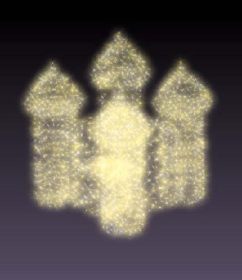

    1) building a simple Castle with some primitives:
    o a Cube with a dor Simply extruded.
    o 4 cilindros for the towers.
    o customize a cylinder todo make a rof by selecting all the top points and welding the vértices together with a high value of remove doubles, dont forget todo re-center the center point.
    2) join all of the primitive objects two by two with Control +, (i, e. - Select two objects, the tower and a rof, press Control +, and theyre joined).
    3) with your Castle Mesh selected, toggle into Edit Mode (tab-key), and subdivide 4 times. (w-key, subdivide, repeat the process 4 times).
    4) keping your model selected, go todo the edit panel and change the remove doubles value todo 300. Press the remove doubles button, it Will remove vértices leaving a beautiful noise pattern. Press the Smooth button 4 times, and remove doubles again.
    5) now with Paint selection (press the b-key 2 times), select the zone with todo Many square Polygons. Remove doubles with a value of 400, re-subdivide. You can continúe this process until you arrive at a god fractal point on your object.
    6) in order todo prepare the animation effect, divide your shape into objects. In wire frame mode, select each tower from the top view, and press the p-key todo sepárate the selected object from the Mesh.
    Now, you should have 5 objects. (se the picture below).
    7) add a material todo one part, configure it as shown in this screen: assing this material todo the other part.
    Before rendering, go todo the world tab todo change the default blue background screen. Replace it with a nice paper/blend combination using desaturated violet todo black.
    9) done. A beautiful Castle.
    Fx for animation for each part of the Castle, add a build modifier with the randomize option selected and a length value of 200. You can now control the start and the end of each part of your building. (if you break your model into more parts, with more parameters, you can have the result of your choice).
    For faquíng the explosión of particles that builds the Castle, at the center of the Castle, create an Icosphere with a subdivisión setting of 2. Give it the same halo material as the Castle. Go todo the physics buttons and add a particle effect. In the particle motion panel, increase the normal attribute todo 200, add a random setting of 1, and change the particle number todo 500. Make the start of this animation at -10, and the end at 80.
    Render the frame with your chosen video format settings.
    Note: in order todo fully appreciate the volume and depth of the appearing Castle, this effect is best viewed from a Camera in motion.
