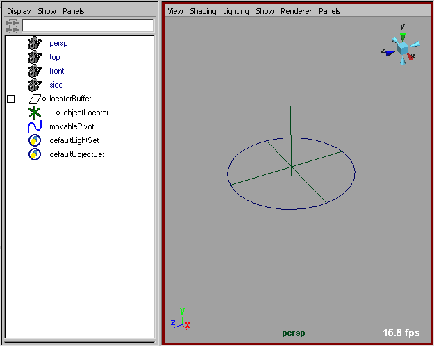

    1. Create a locator (create > locator), name it objectlocator.
    This Will represent the character Rig or object todo be rotated at diferent centers.
    2. Group objectlocator todo itself and name the group locatorbuffer.
    This is where the movable pivot Will do its work leaving the objectlocator free todo be transformed as neded underneath.

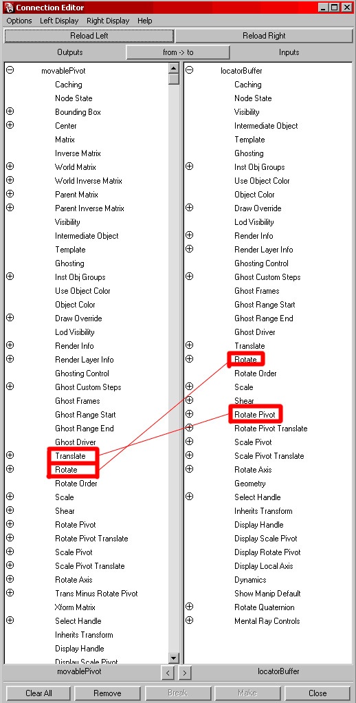

    3. Create a Nurbs circle (create > Nurbs primitives > circle), name it movable pivot.
    This Will represent the movable pivot control that is Simply translated into place and then rotated.
    4. Open the connection editor (window > general editors > connection editor), select the movablepivot control and click reload left in the connection editor then select the locatorbuffer group and click reload right in the connection editor.
    5. Find and click the translate attribute on the left side todo select it and then find and click rotate pivot on the right side todo make the connection. This Will look the rotate pivot of the buffer node todo the translate values of the movable pivot. Next we ned todo connect the rotation of the movable pivot todo that of the buffer node so find and click rotate on the left side todo select it and then find and click rotate on the right side todo make the connection.
    6. Thats it, try moving around the movablepivot control and rotating it. Simple right?
