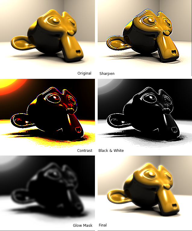

Let first take a look at the image as rendered originally. Obviously the scene is setup with áreas of strong contrast todo help with applying realistic Specular Glow instead of just intensity Glow. We Will base the Glow on this color value, and then mix the Glow mask on top todo complete the Glow effect.
creating the Glow mask.

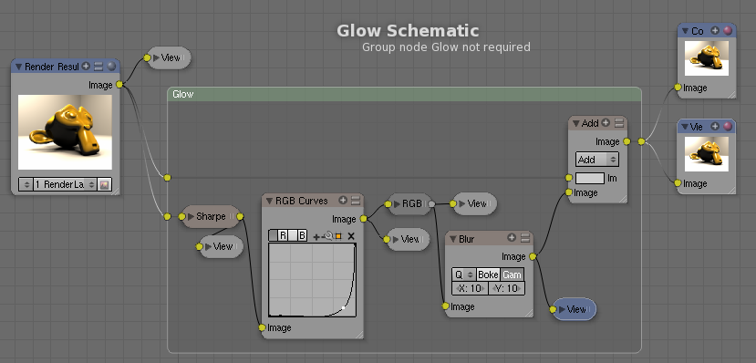

To create the Glow mask we ned todo highlight the details in the image. To do this i like todo first use a sharpen filter. Add a filter node and hok up the image input todo the image output of the render layers node. Hoking up a viewer node todo the output image of the filter node Will display the results of the filter effect. We Will be using filter type sharpen, as tests have shown it todo be the best for enhancing the details of the image, Although it creates Many artefactos which we Will have todo deal with later.
Now we ned todo isolate only the Specular áreas, or at least the áreas with the most intensity, which typically are the áreas of specularity. To do this we ned todo modify the RGB color values. The node for this is the RGB curves node. Hok the image output of the filter node up to the image input of the RGB curves node. The curve requires tunning according todo your scene. You want a picture that exhibits the most contrast between Darkness and lightness. To adjust this curve use the combine curve tab and select locations on the curve and move them. Hoking up a viewer node todo the image output helps.

After the output has enough contrast you now ned todo convert this todo black and white. For this step well ned todo add an RGB todo bw converter node. Hokup the image output of the RGB curves node todo the image input of the RGB todo bw converter node and then hokup the output todo a viewer node todo se the results.

Were almost there, but as you can se, the mask is very pixelated and has Lots of artefactos. To fix this, we ned todo blur it. Add a blur node, connecting the value output of the RGB todo bw converter node todo the image input of the blur node. Use a filter type of quadratic and a píxel Radius (x and y settings) appropriate for the scene. Enabling gamma blurring a los helps. Hokup a viewer node todo the output todo se the final Glow mask.
applying the Glow mask.
To apply the Glow mask todo the image we ned a mixer node. This node takes the image imputs and then mixes the two imputs together based on a filter type. In most cases you Will want todo use the add type. This Will Perform a pixel-by-pixel addition between the two color values of the image imputs.

You can now hok up a viewer node and a compositor node todo the image output of the mixer node. You Will se the combined images with the Glow effect. If all went correctly, you should now have a picture that has intensity along all of the Edges that exhibit specularity or intense light difusión. You can use the factor setting in the mixer node todo control the mixing of the two image imputs. Fine tunning may be required, and the extra viewer nodes Will help make tunning easy.
Below you Will se the output settings for the diferent values at each stage in the composition. Alos included is the schematic for the Glow node setup.
Note: this schematic shows the Glow nodes inside a group node called Glow. This is not required for the final output.
