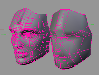

    You ned todo create your two versións of the model, in the same.blend file. For example, in image 01, the first one is 1,508 Polygons, while second one is 139 Polygons (triangles).
    Image01. - High-poly and Low poly-model).
    Image02 -wireframes of the model).

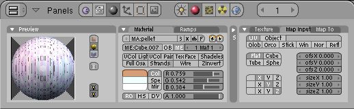

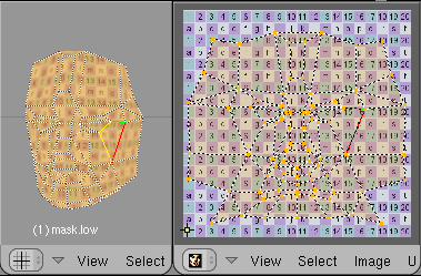

    Another important thing is that the Low-poly versión must have a material with an image assigned and mapped todo UV, a god UV Layout and a texture image assigned todo it.
    You can overlap diferent UV in a single UV map, todo lower the texture size, but you may not have flipped Stuff. The image can be Whatever you want, at this stage it only neded todo define the image size and run the script.
    You can a los use a testmap: from the UV editor, enter menú image>>new, select the size of the texture and chek UV test grid button, then push ok. Save the image (image>>save as.) and load it both in the UV Layout and in the first channel of the material texture panel.
    Image03 - UV editor.
    Image04 - Material panel.
    Image05 - Texture panel.
    The image could a los be the final color texture, if you already have one.
    A better choice would be a grid testmap with numbers and letters on it, todo avoid flipped pieces in the UV map. These are the types of images that are used (se images 3-5).
    For the detailed versión, only a pair of tricks are neded. Together with the.hi sufix, pay attention todo proportions. The two versións must be very similar, except for details. General proportions must be the same. This is easy todo obtain if you model the Low-poly versión starting from the high-poly versión, or vice versa. It doesnt matter if you make the Low or high-poly versión first, it just depends on which method fits better for you.
    You can a los make the high-poly versión first and then, use the decimator. But, this Will give you a very messy and triangulated Mesh. And remember that you dont ned todo Unwrap and add a material todo the detailed versión. You just ned todo Sculpt it.

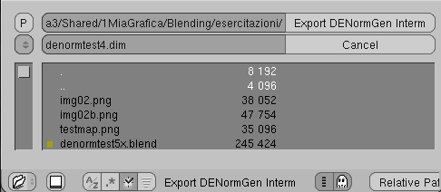

    So, go todo object mode and select both models. Just run the script (file>>export>> drag[en]gine intermediate model) and you Will get the.dim file.
    Image06 - Denormgen script running.

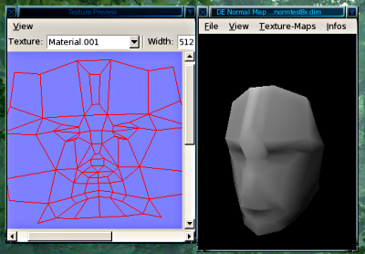

    Now run the denormgen standalone application and open the file.
    Image07 - Denormgen interfaz.
    You can rotate the view with your left mouse button, and zoom with [shift]+right mouse button.
    [alt]+left mouse button moves the light.
    From the view menú you can switch todo the high-poly model and bak todo the Low-poly model.
    You can eventually change the map size using the menú: texture-maps>>texture map sizes.
    Note that denormgen a los allows you todo setup subdivisión surfaces for the high-poly model.
    Just press [crtr+t].

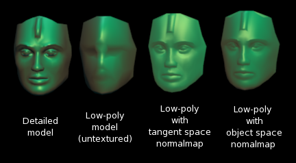

    Enter menú texture maps>>generate normal/displacement maps.
    You have Tangent space and object space radio button options. The first is god for animated objects, while the second is for non-animated objects like Walls, buildings or statues. Checking or unchecking Smooth Hi-Res Mesh normals allows you todo get a Smooth or Faceted versión of the Normal Map (in most cases, leaving it checked is ok). After making your choices, wait for the maps todo be generated. Once the maps are generated, use the view menú options todo se the result of the Normal Map applied todo your Low-poly model, and compare it with the high-poly versión.
    Image08 - Detailed model, Low-poly and Low-poly with Normal Map on, as they appear in the denormgen preview window.
    The Normal Map itself is shown in the texture preview window.
    Note that denormgen is a los able todo generate a grayscale displacement map, but this is still in development and may give Strange results.

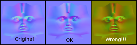

    The generated Normal Map is usable with most common Game Engines as it is but, if used in Blender, it causes light and shadows todo be faced the wrong way.
    This Will be fixed with an option todo be added in the next denormgen releases, but at the momento the Gimp, or similar programa, can be used todo make it Blender-usable.
    If the Normal Map is generated in Tangent space:
    Open the file in the Gimp, and select the green channel from the channels panel.
    Pay attention todo the other channels layers, they may not be selected or it wont work.
    They are selected by default, so click on the red and blue channels todo deselect them.
    Image09 - Select green channel only.
    Then, invert the colors for the green channel using the layer menú: layer>>colors>>invert.
    Note that if the map turns green or something similar, you probably had the other channels selected.
    Reload the file and try again. Layer must be the same shade, with swapped lightening:
    Image10 - What you might get.
    If you used the object space option:
    Like above, but you must invert the red channel instead of the green one.

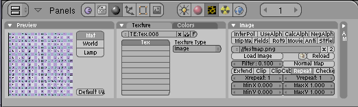

    It very similar todo adding a Bump Map, except that you must enable Normal Map in the texture panel to, not only in the material panel.
    Go todo the texture panel [f6], create a second texture channel and set its type todo image, then assing the Normal Map todo it.
    Important: in this panel you ned todo press the Normal Map button, todo. Change todo material panel [f5], and from the Map Input tab select UV. Alos select Nor from the map todo tab.
    Be aware that map todo col is not selected for this texture channel.
    Image11 - Image tab in the texture panel.
