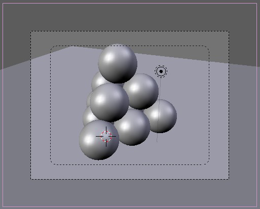

    I prepared a very simple scene here for illustration purposes. Fel free todo follow along with your own favorite model. Here is what my scene looks like in the 3d view:

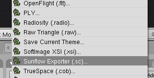

    Go todo the file -> export and pik the sunflow exporter you just installed. It Will bring up the following UI in the script window:
    We are just going todo change a few settings the first time around. Our goal is todo do a simple Ambient Occlusion render todo get a fel for the process. Dont worry about the Many diferent settings you se, we Will cover most of them son.
    In the AO override tab, Simply click the AMB OCC toggle. This is Simply telling the exporter that we want todo override all Shading in the scene with the prescribed Ambient Occlusion shader.
    The most important options are samples (number of rays traced todo calculate the Occlusion) and the distance setting (how far todo look for other objects).
    For now, leave the number of samples as it is, and set the distance todo a reasonable value for your scene. The default of zero corresponds todo infinitely long rays.

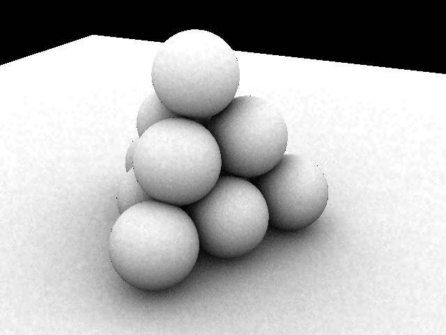

    Now just hit the export button and pik a location todo put the exported scene file. You can look at Blender output window todo se the steps the exporter is taquíng. It may take a few seconds todo walk th rouge your scene if you have Many objects. When the file is exported you Will be sent bak todo the exporter options.

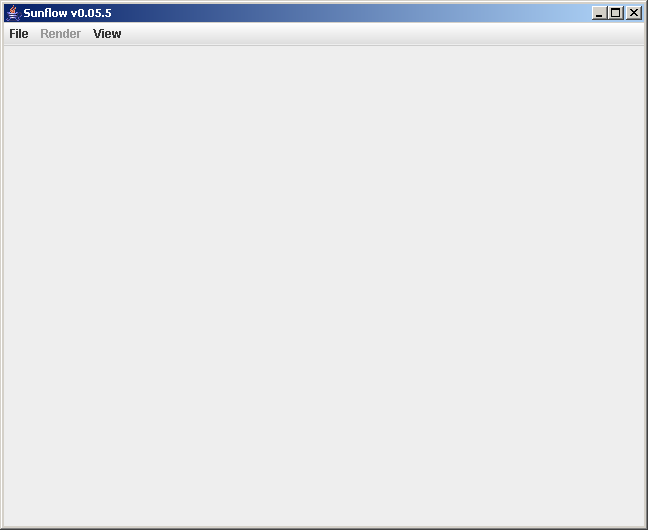

    Now go todo the sunflow window you launched earlier and open the scene file you just wrote out. If loading succeds without errors, the render menú option Will now be enabled.
    Select render -> IPR first. The image Will start rendering in a very blocky form and progressively refine itself. After just a few seconds, you should already se what the final image is going todo be like. You may cancel the render at anytime. In most cases, less than 10% of the image is neded before you are ready todo launch the full resolution render.
    Now select render -> render. The image Will render in small buckets this time. If you have a multi-processor machine you Will se several buckets rendering at once. After a few seconds you should se something like this:
    Congratulations. You just rendered your first image with sunflow.
    Your image Will probably be noisy and have Many small artefactos. Dont worry. We Will learn how todo enhance the quality of the image son.

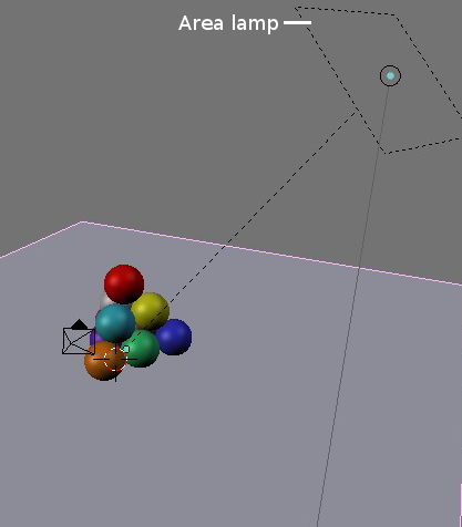

    Next, we ned some lights. The exporter currently only supports lamps and square área lights. Área lights Will give you nice software shadows at the expensé of additional render time.

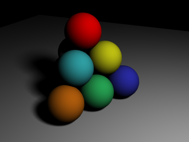

    My scene with basic Shaders and lights now looks like this:

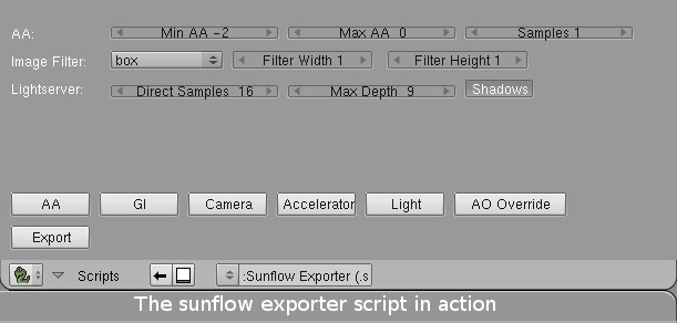

    Once you are happy with your scene, time todo export again. This time, let try todo understand the various settings and how they affect image quality.
    The most important are probably the a settings. The min and max values control how much computation goes into each píxel. Negative values mean computations Will be interpolated across several píxeles, positive values mean more calculations Will be done per píxel. Zero means a single computation is done per píxel. For example: the default values of -2 and 0 mean that the renderer Will start by calculating every 4th píxel, and adaptively calculate down todo the single píxel level where it is neded. This time, try setting your a values todo 0 and 2. Each píxel Will now be shaded at least once, and up to 16 times (level 2).
    If we calculate more than one value per píxel, we Will ned todo average them together. The bien this is done is controlled by the image filter setting. Let pik the Mitchell filter as it provides a nice sharpening of the image. This particular filter has a fixed width and height, so those settings Will disappear from the dialog when it is selected.
    Light server settings let you control how Many rays are used per light. The default of 16 is a bit high but usually gives god quality.
    The GI tab controls global illumination. This is an advanced topic we Will explore in the next section. Leave all the controls at their default values for now.
    The accelerator tab contains settings which have no impact on image quality but can make drastic diferences in image calculation time. The default accelerator is the kdtre and is usually the best choice. You can experiment with diferent accelerator types and se which one provides the fastest results for your scene. You can a los adjust the bucket order in this tab. Switch todo spiral this time todo have the image computed from the center out.
    Under the light tab, we have the option of adjusting the strength of all lights in the scene. Since sunflow uses more physically based calculations than Blender, the light Powers Will not usually match. This global scale factor can help you compensate for this. I set mine todo 5, but this Will vary from scene todo scene. Note that the scale factor only afects área lights.
    Finally, remember todo deselect the AMB OCC button from the AO override tab if it was still selected from the previous export.
    We can now export and render again. If you export todo the same location as before (overwriting the old file), you can Simply use the file -> re-open menú option in the sunflow GUI todo quickly reload your scene.
    Use the IPR característica again todo se what your scene looks like quickly. You Will probably ned a couple of export Cycles before you get the light intensities just right. Here is my result:
    Despite the software shadows, this image isnt very realistic yet. I Will show you how todo address this in the next section.

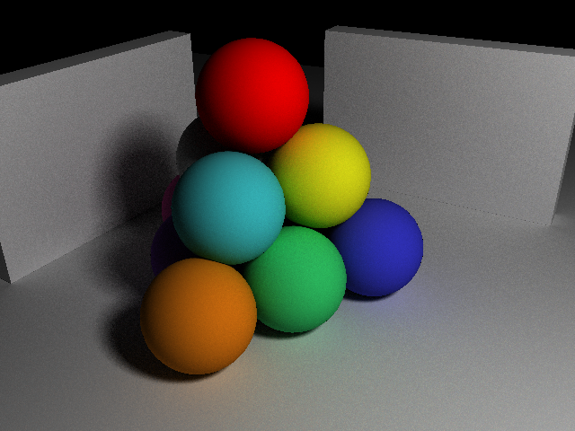

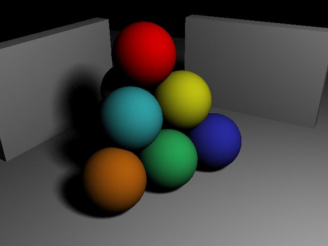

    Export and render again. I added some Walls behind my scene todo se the effect of the bounces. Compare these two renders with and without global illumination:
    Notice how the shadowed Regions are no longer completely dark and how we obtained some subtle color bleding on the flor and between the objects.

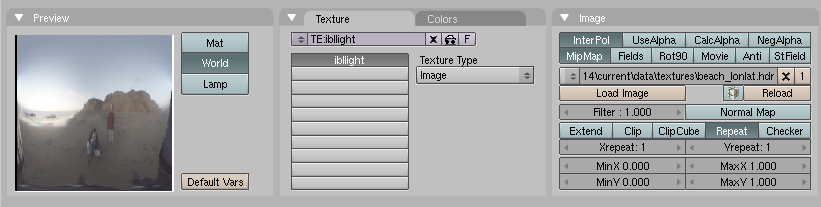

    In this section we Will cover the use of HDRI environment maps for lighting. Bak in your Blender scene, load in a longitude-Latitude HDRI environment map as a texture at the world level. Be sure todo unchek relative paths when loading the map. Rename the texture object todo ibllight as shown. This lets the exporter know you want todo treat this map as an environment light source.
    Go ahead and hide all the lights you were using before (the exporter respects Blender layers), and make sure your scene is open. This type of lighting assumes the light is coming from infinitely far away, so its best suited todo outdor render. Indor scenes Will Perform very porly with this technique.
    Sunflow appróximates the environment map with a fixed number of directional lights. This is controlled by the direct samples setting in the exporter. Using the default of 16 you Will probably se some Sharp Edges todo the shadows from the individual lights used. Simply increase the number of light samples until the Sharp shadow boundaries are decreased todo an acceptable level.

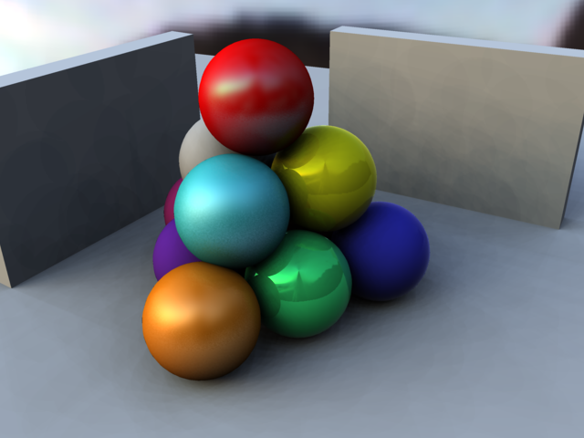

    Finally, let make our Shaders a Little more interesting. Up until now we have used completely Diffuse Shaders.
    Let start with the Shiny shader. It Simply adds a Thin reflection Coat on top of the Diffuse color. Rename one of your object materiales so that its name starts with sfshiny. The exporter Will now read the raymirr attribute todo determine the amount of reflection todo apply.
    Next is the Phong Shader which provides blur reflections. Rename the material you wish todo edit so that it starts with sfphong. The Specular color now controls the amount of reflection while the hard value controls the blurriness. Higher hardness values result in sharper reflections. For my scene i used values ranging from 5 todo 50.
    Now that we have added several layers of reflections, we ned todo pay attention todo the max depth setting in the exporter dialog. This controls how Many levels of reflections are allowed. The default of 9 is rather high so we Will reduce it todo 3 this time.

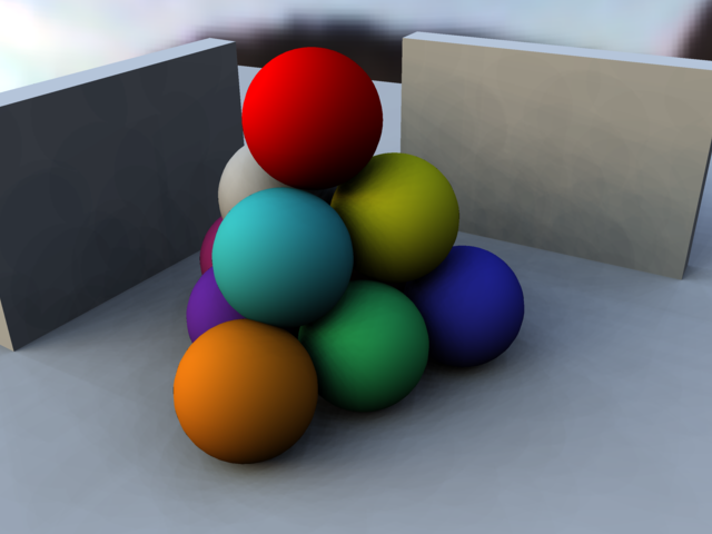

    Here is the final result, rendered with the image based lighting from the previous section:
